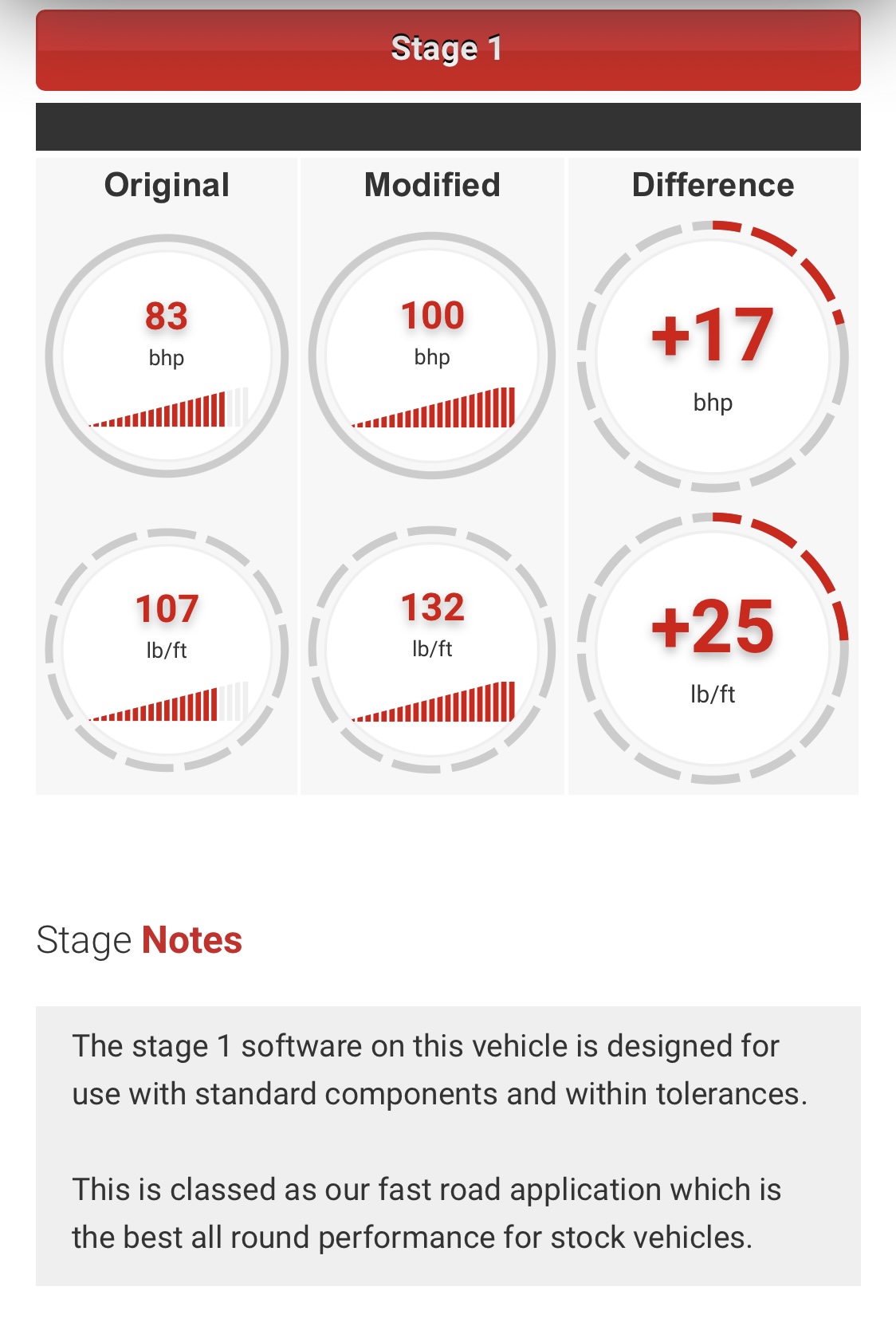

This is their claimed:
Yes its tempting as it raises the game to what the 90HP version produced so shouldnt overstress things. I have read nothing to suggest the 90HP engine has any performance advantage at all though. And you have to ask why they dropped it......
