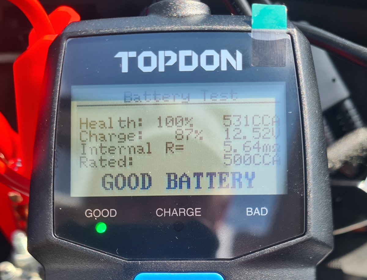

It will surely last. And wouldn't need replacing, IR 5.64 is very good. You could just put it on the charger a little bit.

A bit of an update, I put the battery analyser on it this morning before starting it and it gave a "good" result.

A resting voltage of around 12.5 is not ‘good’ for stop-start battery. Replace it as soon as you feel you can as other errors will follow otherwise…. The car will start with much lower resting voltage than that, but the monitoring systems around the car will start to show errors if it drops any lower at start up.
