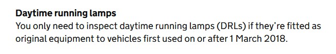

is a non functioning daytime running lights a MOT fail, panda cross 2015
Not on a 2015 car. You might get an advisory, though.
From the MOT Tester's Manual:
