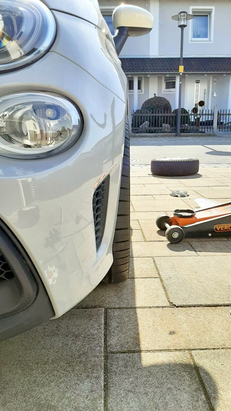

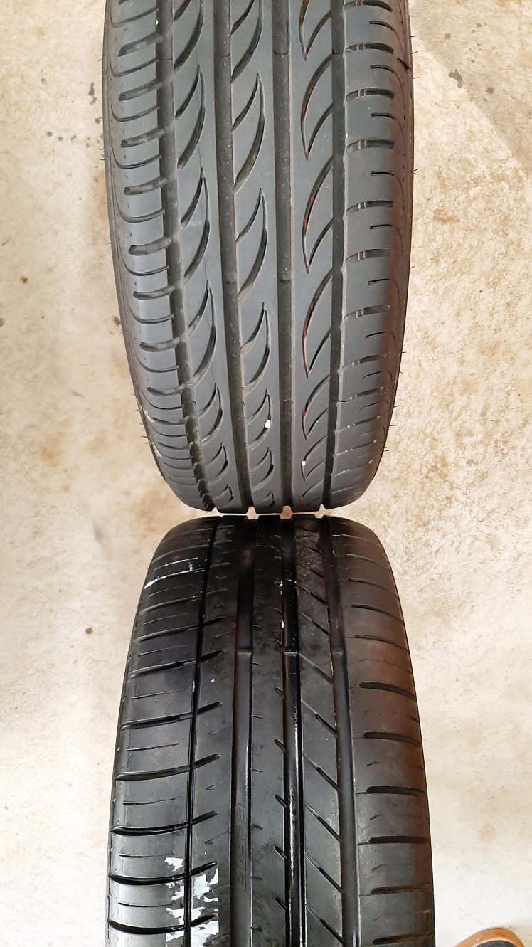

I will try 225/35R17. I got a cheap wheel (in the same size like my summer wheels) from ebay and also an used tyre and I will test it in some weeks when I will remove the winter tyres...

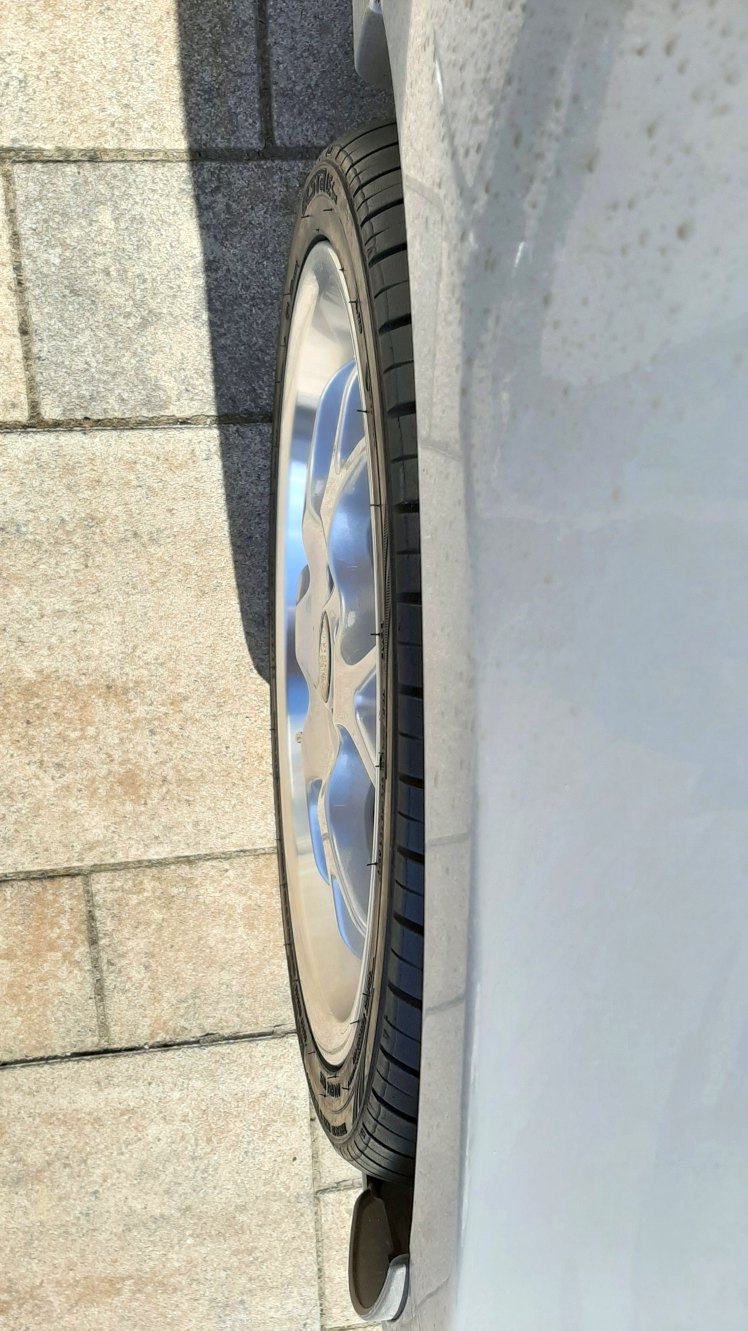

No that´s the "test-wheel" Borbet BS in 7,5x17 offset 35 with the 225/35R17 Kumho KU39 tire. My summer tires are white IWD 7,5x17 offset 35 with 205/40R17 stock Pirellis.

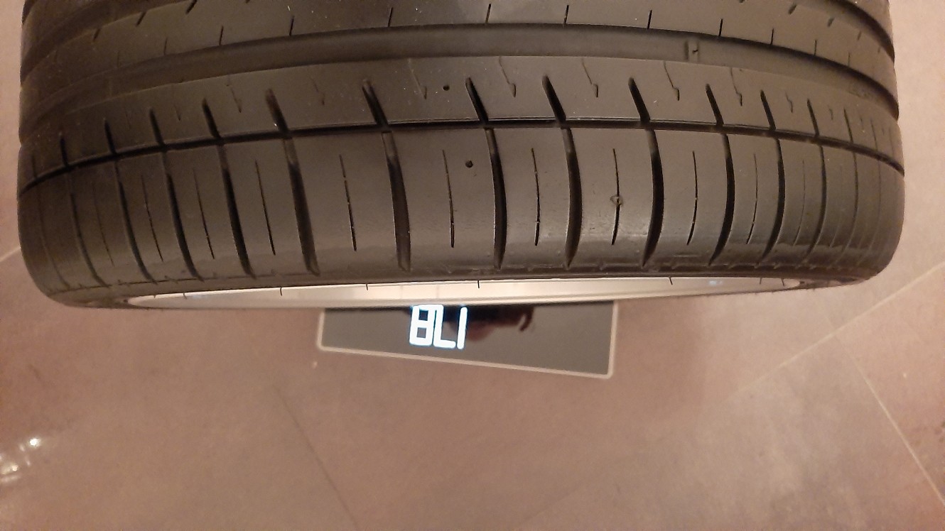

But surprisingly those wheels are much heavier....neither the Pirelli is so heavy, or the the rims...

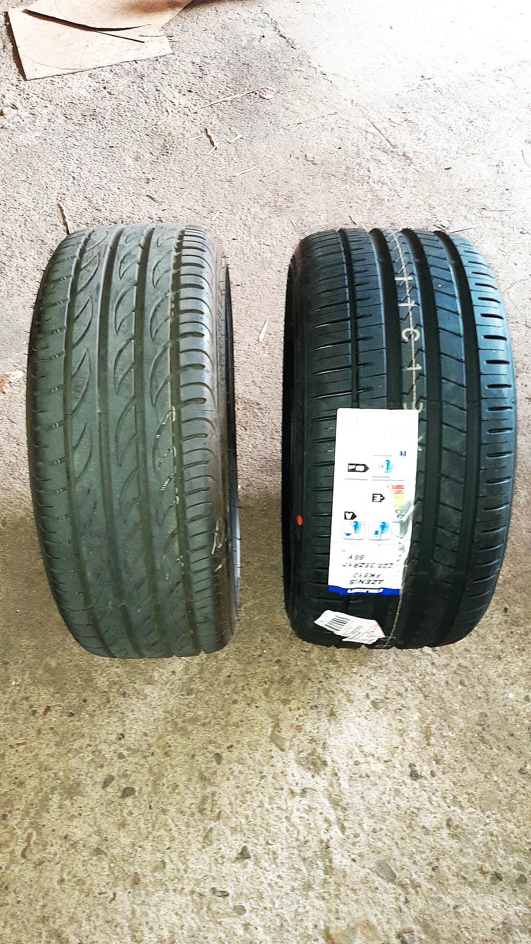

I personally don´t want to further increase the rolling circumference of the wheels. With the 225/35 it decreases slightly, but stays more or less in the area of the 205/40.

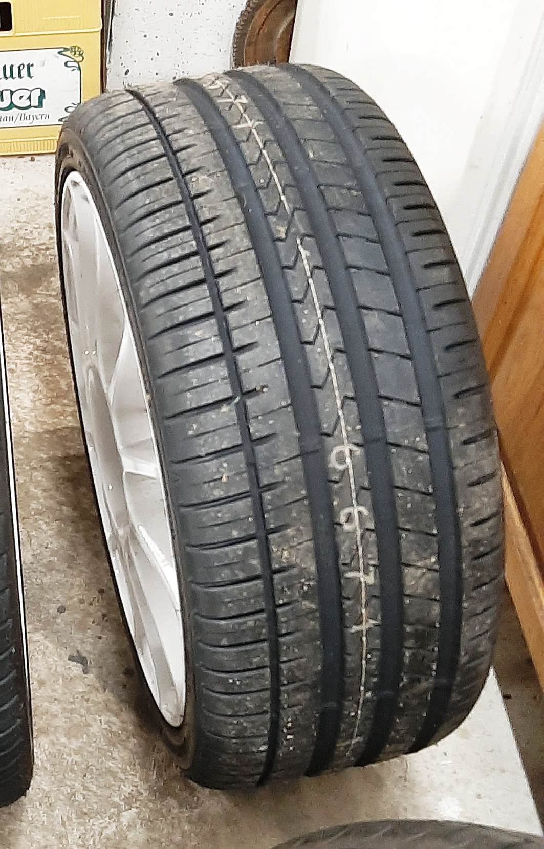

Yesterday I got the other two and I did mount them on the car still in the night...
In fact, they are looking fat.
