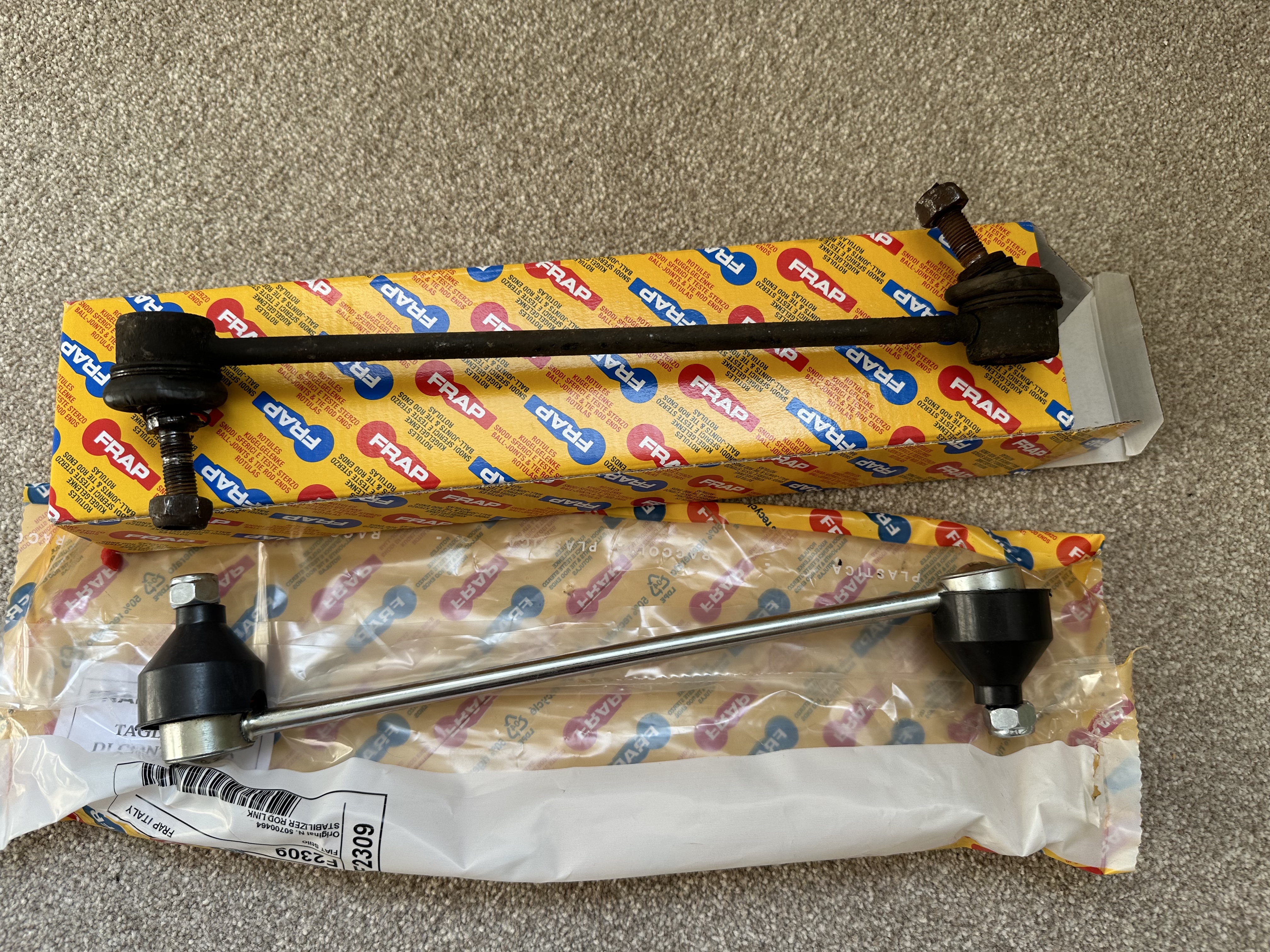

There is a knocking from the suspension, I'm fairly certain this is a drop link as it looks knackered, already bought one just need to fit.

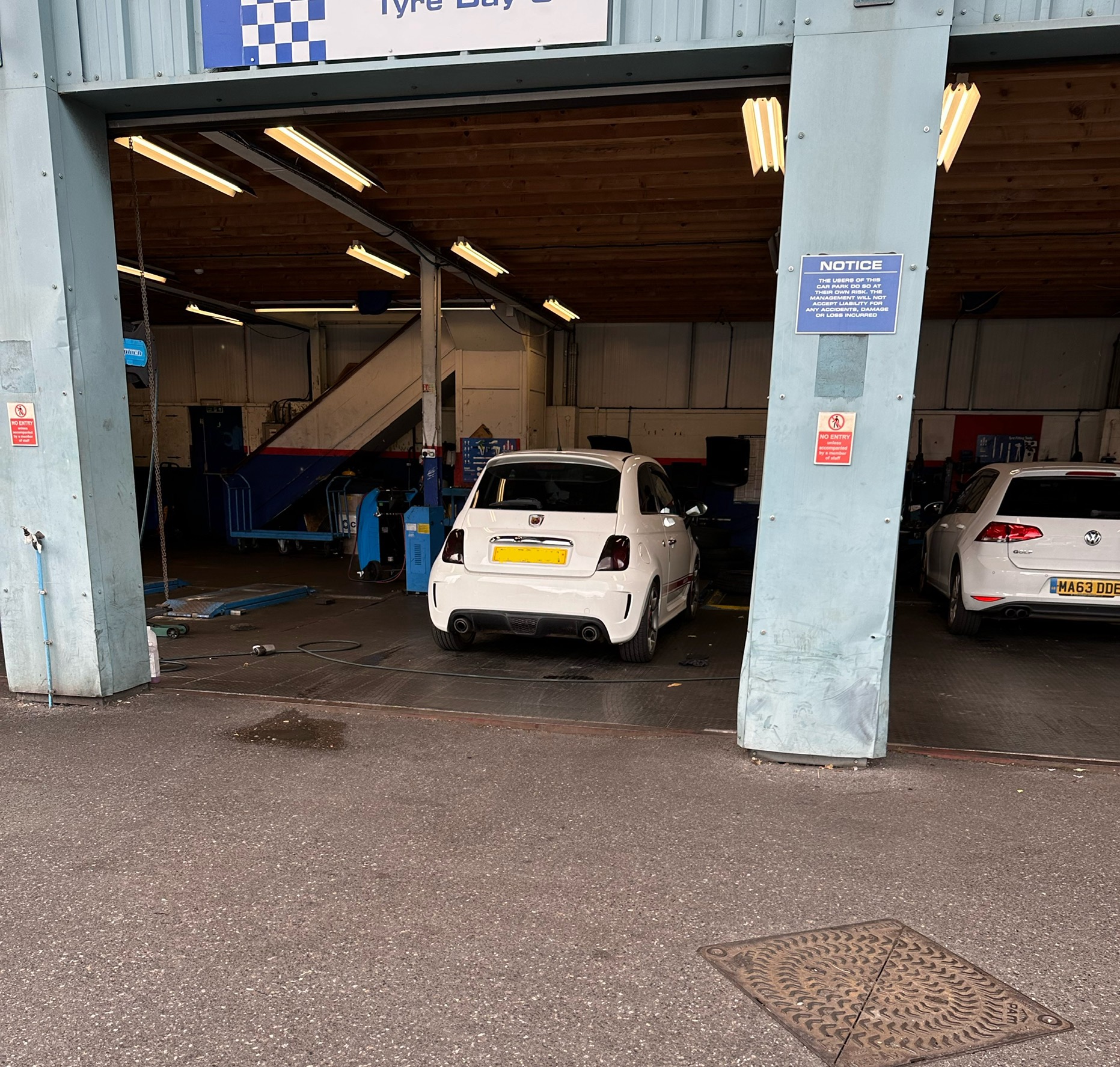

First things first anytime I buy a car is get the rubbish tyres off and on this occasion some Pirelli P Zero nero's on.

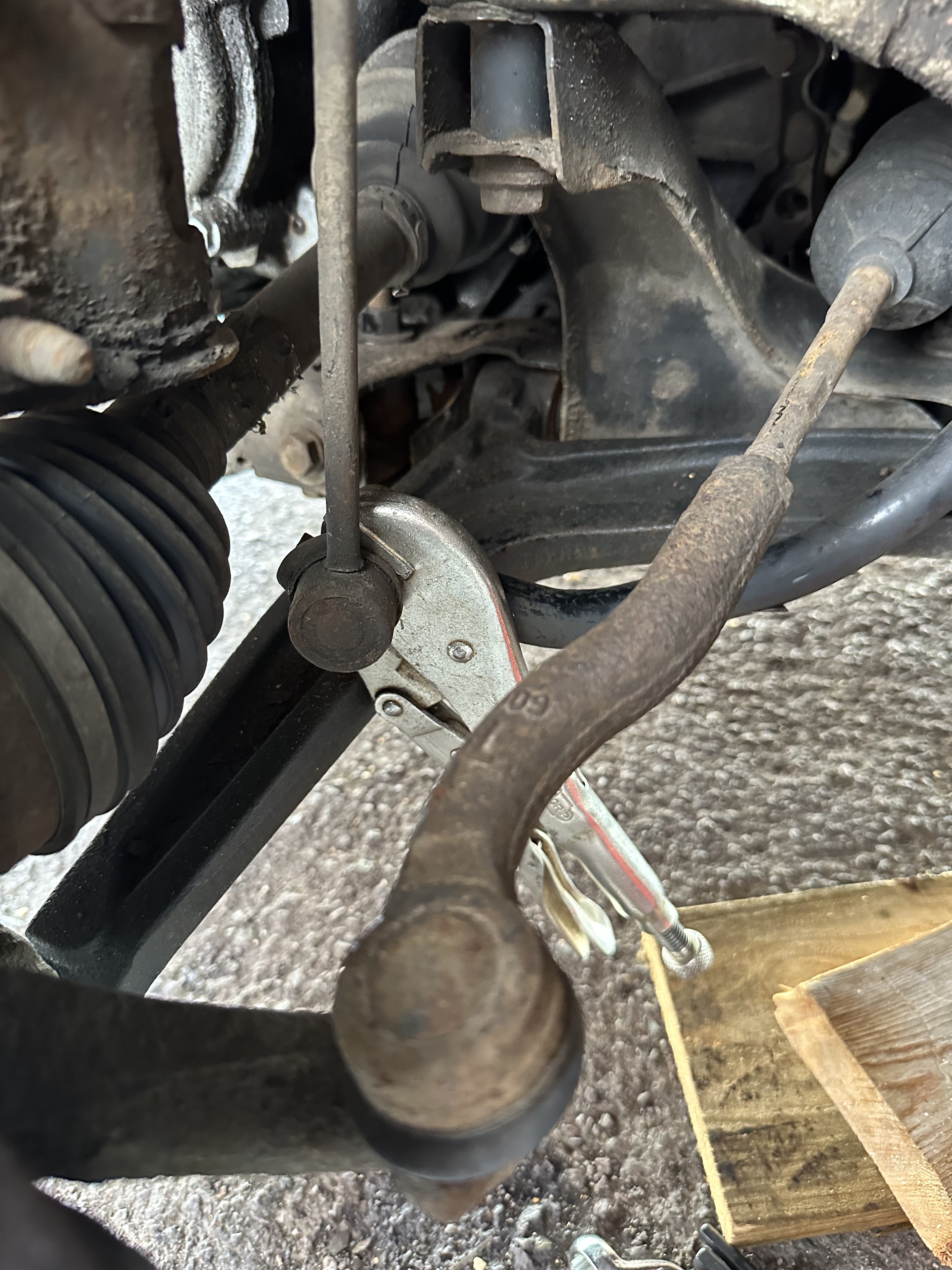

Well I'm onto tackling my drop link and its not going well...
Soaked both nuts in plus gas the night before, top came out without too much fuss, a faff but not awful.
The bottom nut however, it came out most of the way relatively ok, about 3 threads from the end however it suddenly went loose, never a good sign... the hex in the end of the bolt has rounded...
I've tried putting some mole grips on it but I think its still spinning...
Not sure where to go from here, I don't own an angle grinder and even if I bought one I'm not sure I'd be comfortable wielding it 🥲

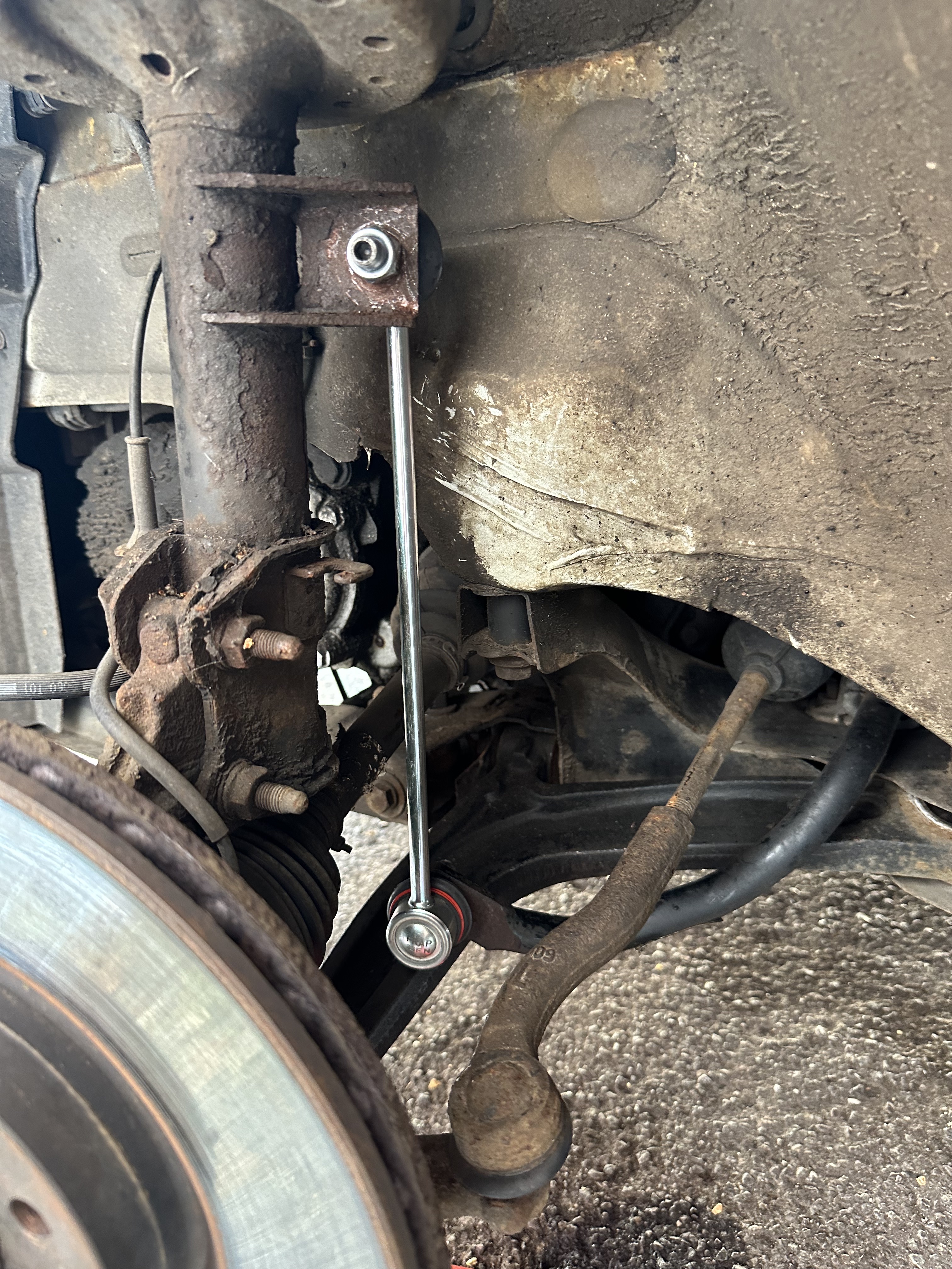

Crisis averted.
I took a step back from it having spent at least an hour on the one stuck nut. Had a little break and took another crack at it. This time I got the mole grips in a better place and even tighter and off it came!
In with the new, the only concering thing is I got them fairly tight and then put an allen key in the bolt expecting to have to apply counter force but the allen key never span, they feel very tight so does the bolt part not spin when tightening? This might be a stupid question 😂 this is my first attempt at a suspension related job
Dont over tighten. The torque isnt huge. They will do up without bthe allen key 9 times out of ten. In vest in a rrattle gun it makes removal simple. Possibly the best tool Ive ever bought. Mine has had a huge amount of use, The time they save justifies the spend.. Mains cabled versions are really quite cheap now.
The droplink has solved my major clonk, there is still something else in the suspension thats making a bit of noise, I suspect top mounts but the big clonk has gone so thats a positive.

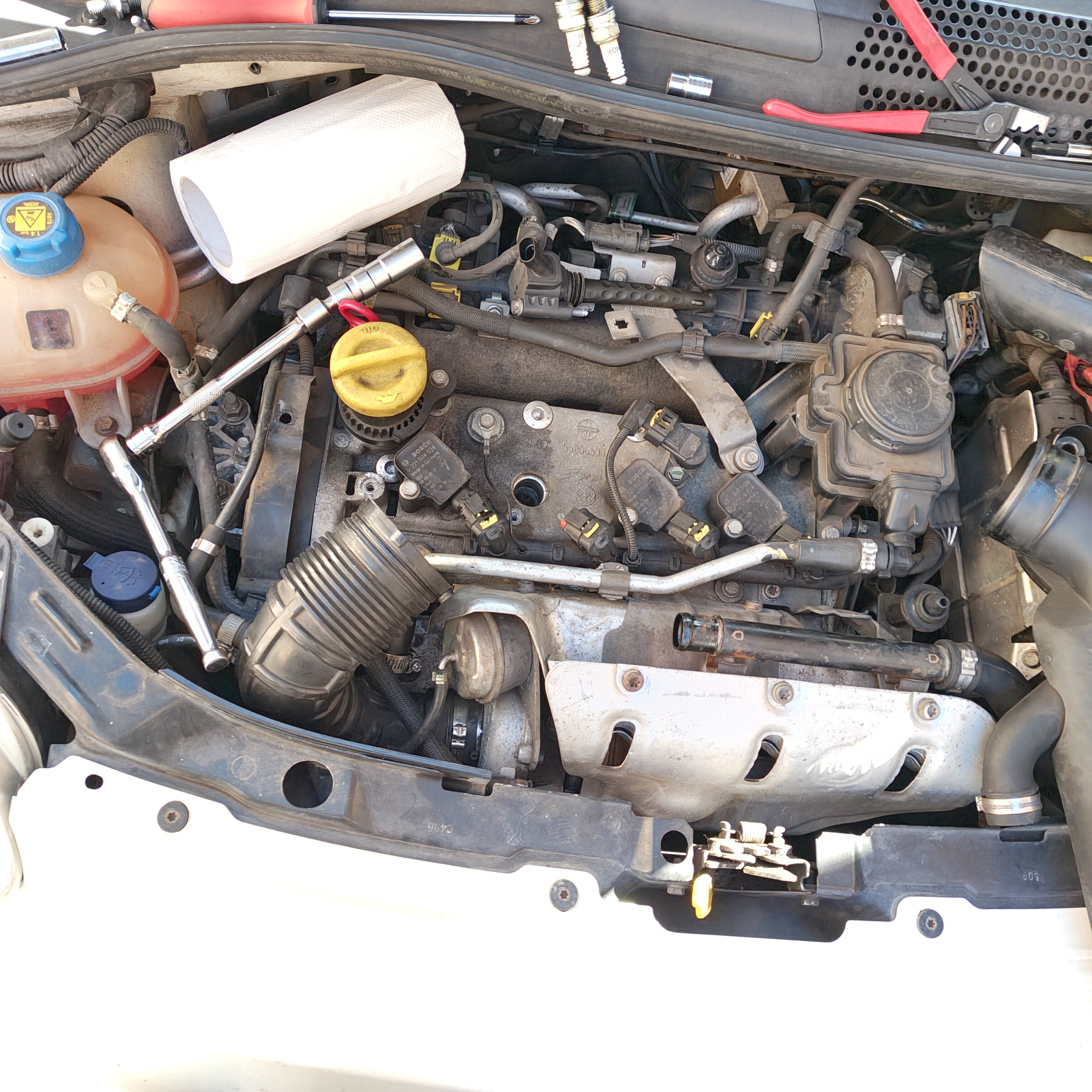

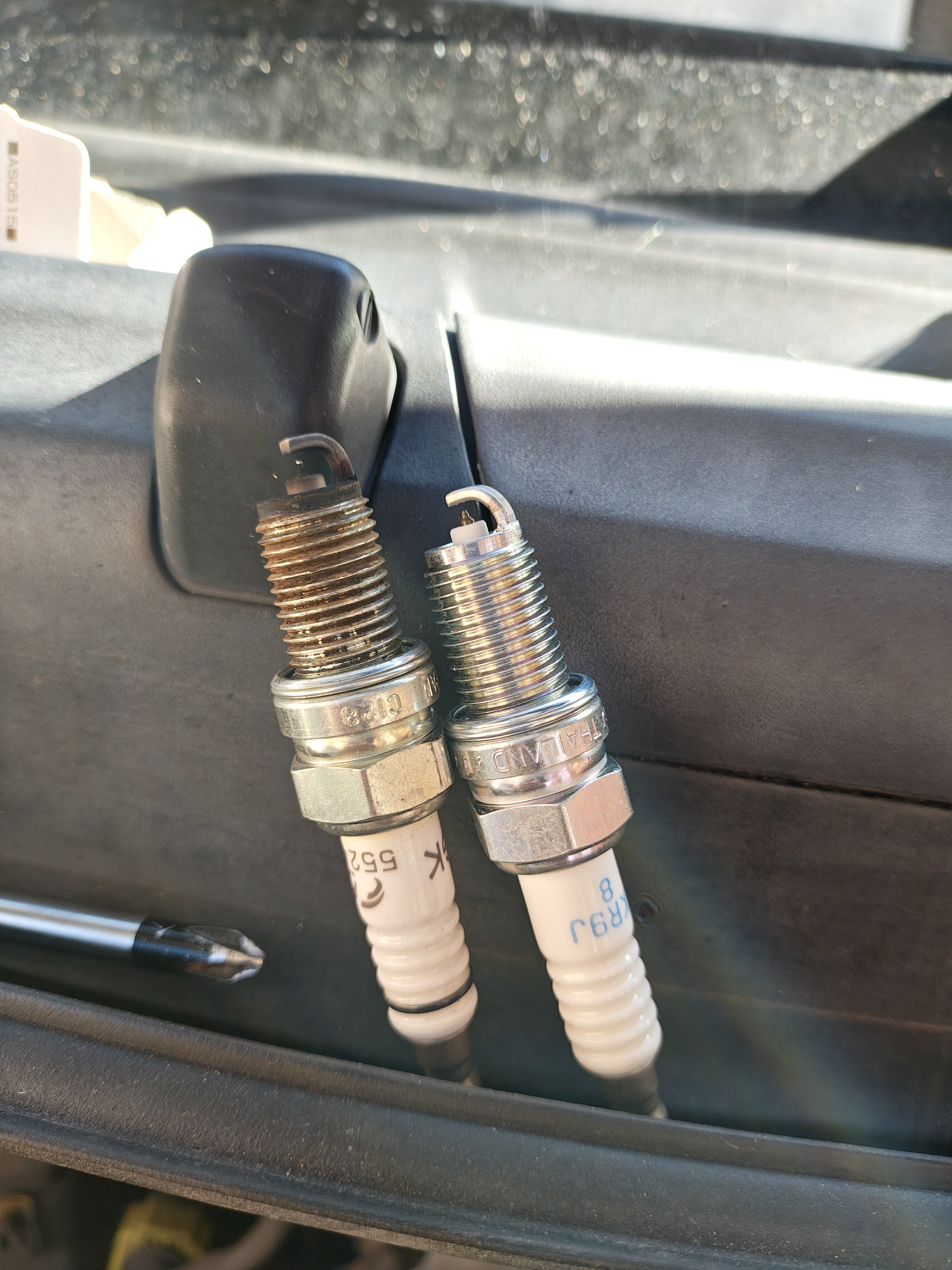

Changed the spark plugs because it's an easy potential performance improvement.
The plugs for the coil packs are a bit of a pig to get off...
But they all came out looking used but nothing terrible

Did the other drop link, should've done both in the first place, suspension clonking has gone, there is a creak coming from the rear but I'm not too concerned.

All is not well in Abarthville... it has developed a bad vibration from around 50mph which continues to 60/65 then its starts to subside (although not completely). Its especially bad if you're accelerating, borderline undriveable. It went into the garage where both wheels were massively out of balance but it hasn't solved it (suspect the huge vibration simply shook the wheel weights free causing the misbalance)
They were unable to find anything else that could be the cause, nothing has any play or seems loose... Its gone back in today, suspect of the driveshaft(s) but apparently neither have any play, the CV boots are completely dry, no signs of leaking...

Well driveshafts have been replaced, not very cheap but so far so good no more vibration, I've not gone very far in it yet mind so I won't hold my breath.
