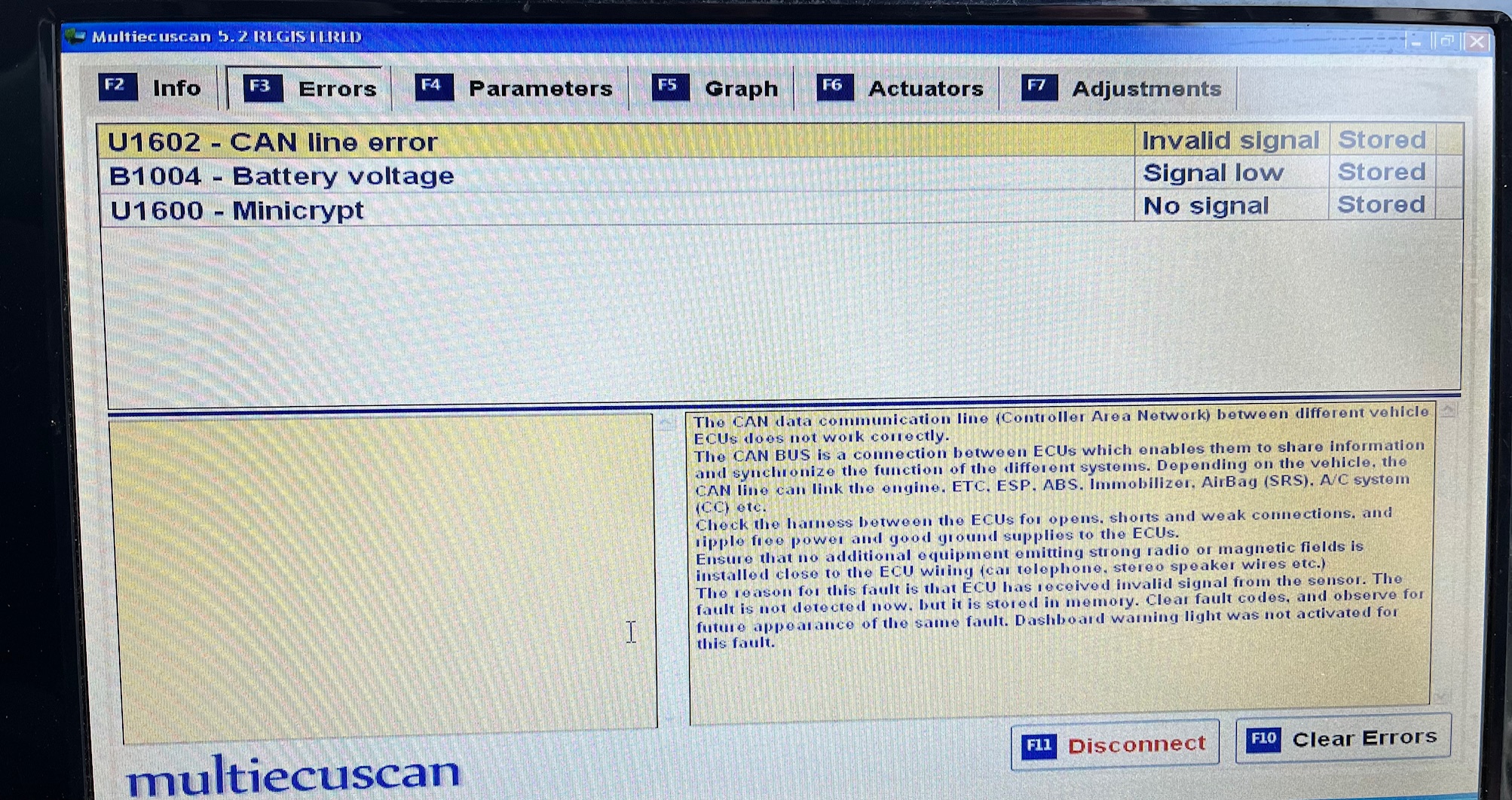

Body Computer codes after the fault attached. Note the battery is approx 8 months old & tests good with battery tester, alternator charging 14.2V.

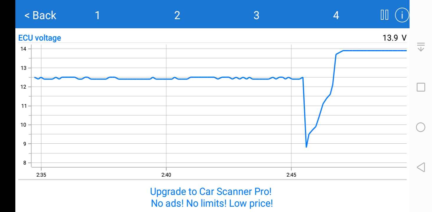

Plot the ECU voltage
This is just the first few seconds
If it's an ignition switch or main fuse, relay or earth
You should see a corresponding blip here also,
B1004
Is the one I'd be concentrating on
Low power, to the body computer
Without the right voltage, it can communicate properly, any how
Still need to know whether it's a car wide problem, or just the body computer
Graph the ECU power supply is still a good first step
Worth looking here assuming if the ECU does not fluctuate
