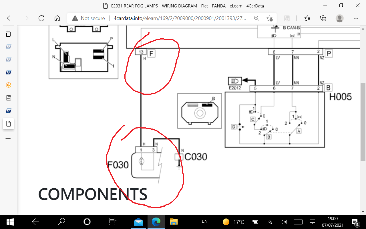

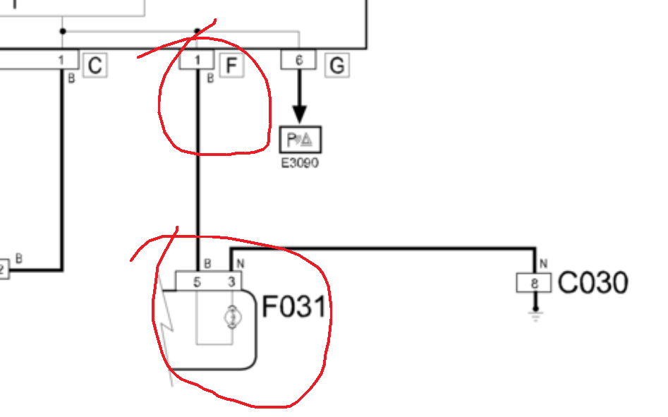

I dont see how without modifying the wiring either at the body computer end or light cluster end anything will alter

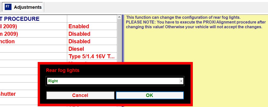

swapping pins 1 and 13 via software would be nice. But dont see anyone has succeeded in doing this.
according to the wiring diagrams that match your car. the LHD and RHD clusters are wired differently.
Of course I could be wrong. I have checked everything I can using the information on elearn. The harness runs are not compete on elearn. However it looks like the reverse and fog take difference paths to the front.
It appears not from MES simulation. There is only off or on in the MES for earlier cars. Hardware wie there should be no issue and I'd still be surpprised if the wiring loom is different. Maybe they ued a different body computer firmware for LHD/RHD in the earlier models.
I don't know what would happen if you tried using the 2012 MES selection on an earlier car. You might mess up the proxi alignment totally.

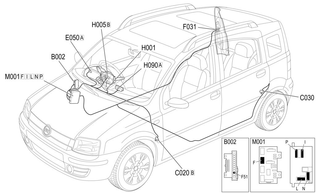

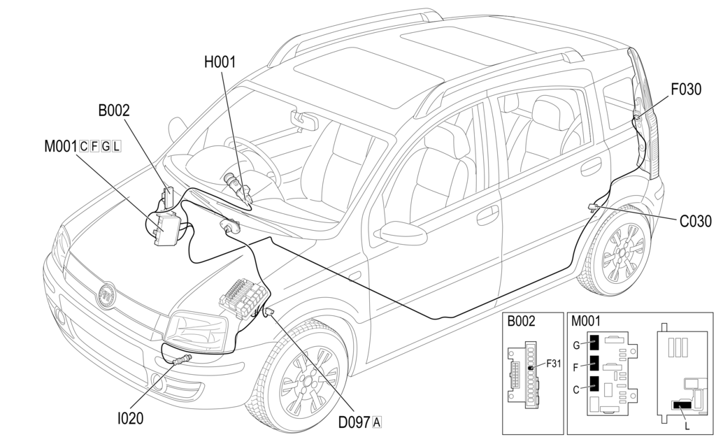

Yes I initially thought there were two groups of wires running down the right and splitting at the right rear light fitting, but I think one is the overhead brake light.
It looks like the wires for the left run down the centre of the car to the boot then divert to the left light fitting.
probably easier and safer to install two new wires as per Txuchin from one cluster to the other tagging it under the heading ?
