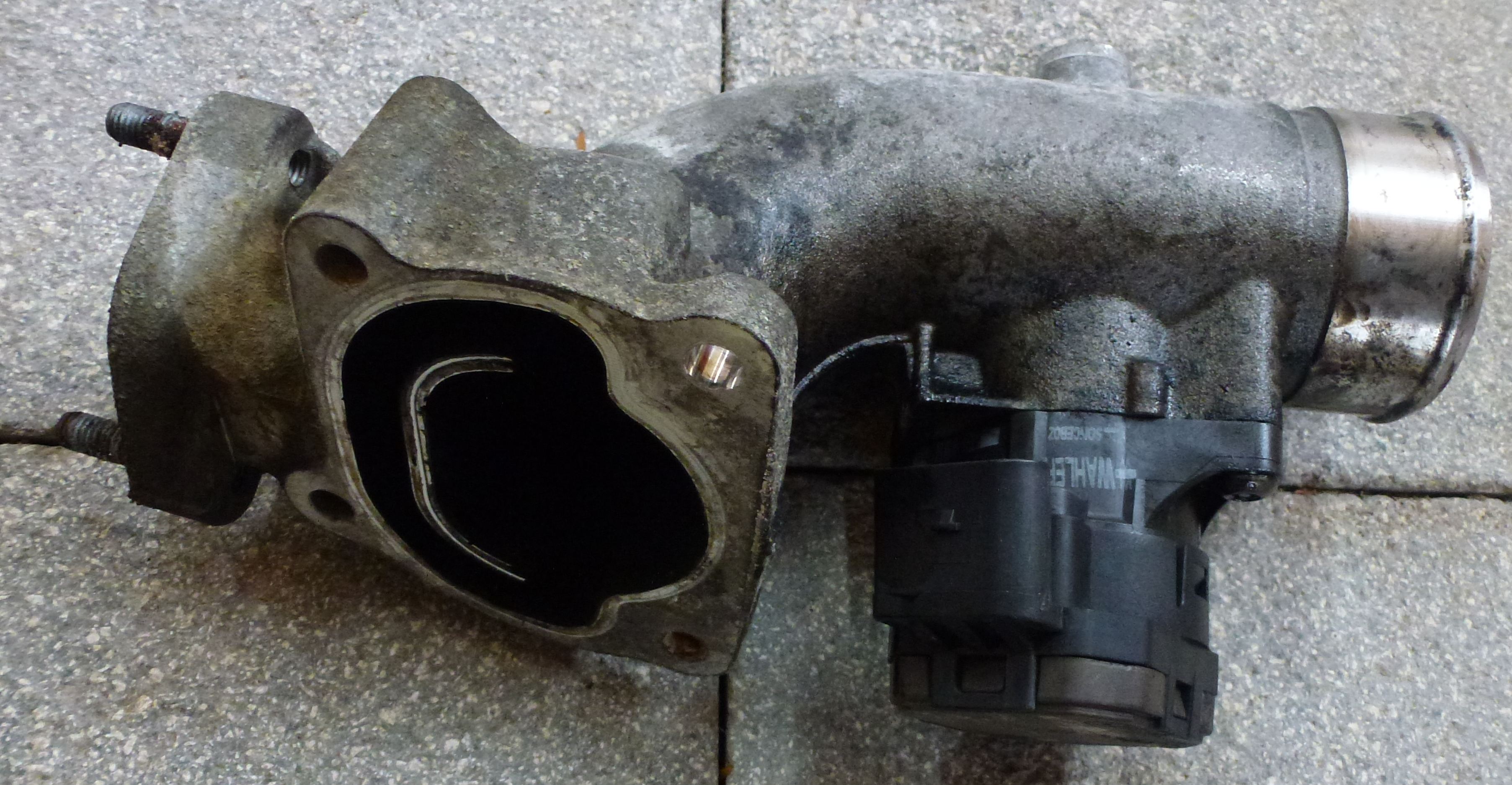

Just to add to LandyAndys post, here are pictures of an original Wahler throttle body and a later replacement made by Magneti Marelli. The TB is part of the EGR process, but if its flap closes when it shouldn't the engine is starved of air. If this happens when driving along it will feel as though you have more engine braking than usual. Not sure if this fits with your symptoms, but if you still have the Wahler fitted you are in the minority as most will have failed by now.

I found with my TB that it would not always return to being open. It is powered shut but opens just with pressure from internal spring. So it was easy to move with fingers and returned easy and well. But when the system shut it whilst driving, as it will practically every time you come off the acc pedal, then it just didn’t always open, as it was being sucked shut. I assume to weak spring??? The TB is only powered shut, and has no idea where it is, or what it is doing.
Just a thought 👍🏻👍🏻
