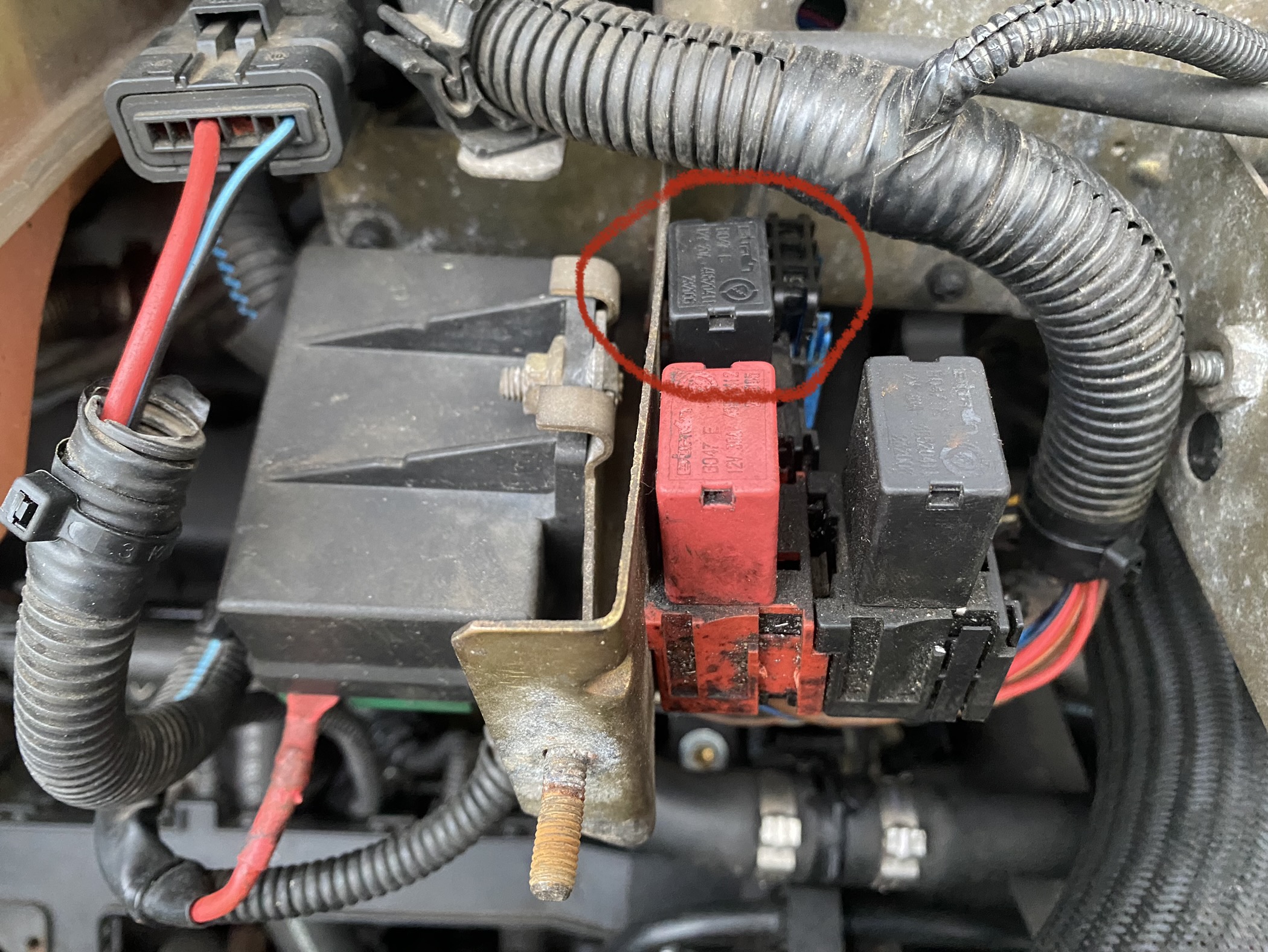

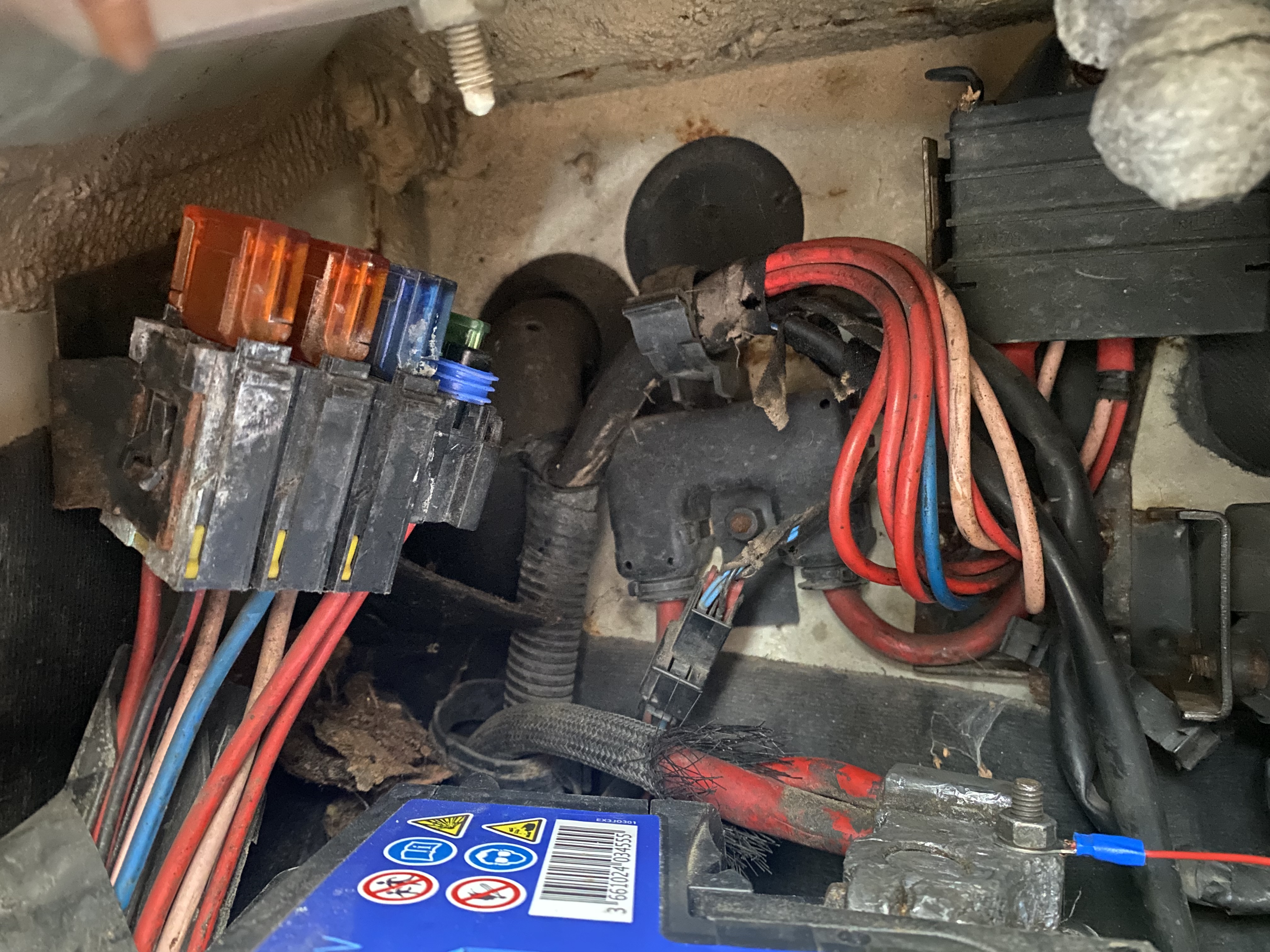

I do not have such a fancy fusebox in my engine bay, see attached what I am equipped with
When I pull the marked relay, the LP pump won't run, so I suppose its the fuel pump relay/T10. Switched it with the other black relay to, it is the same part number. But its the same deal, Only LP pump and lights in the dash shut off when key off, injection keeps running until rail pressure drops enough.

Perhaps try swapping the red relay with a black one for testing only. The red relays are rated at 30A, while the black ones are only rated for 25A. Should not matter for a few operations.
Also look for any signs of corrosion around the relay connections.
Switching the red for a black relay did not change anything. Checked and cleaned all the relay wiring that was easily accesible. Also cleaned a big connector in the ECU area. Did not help.
