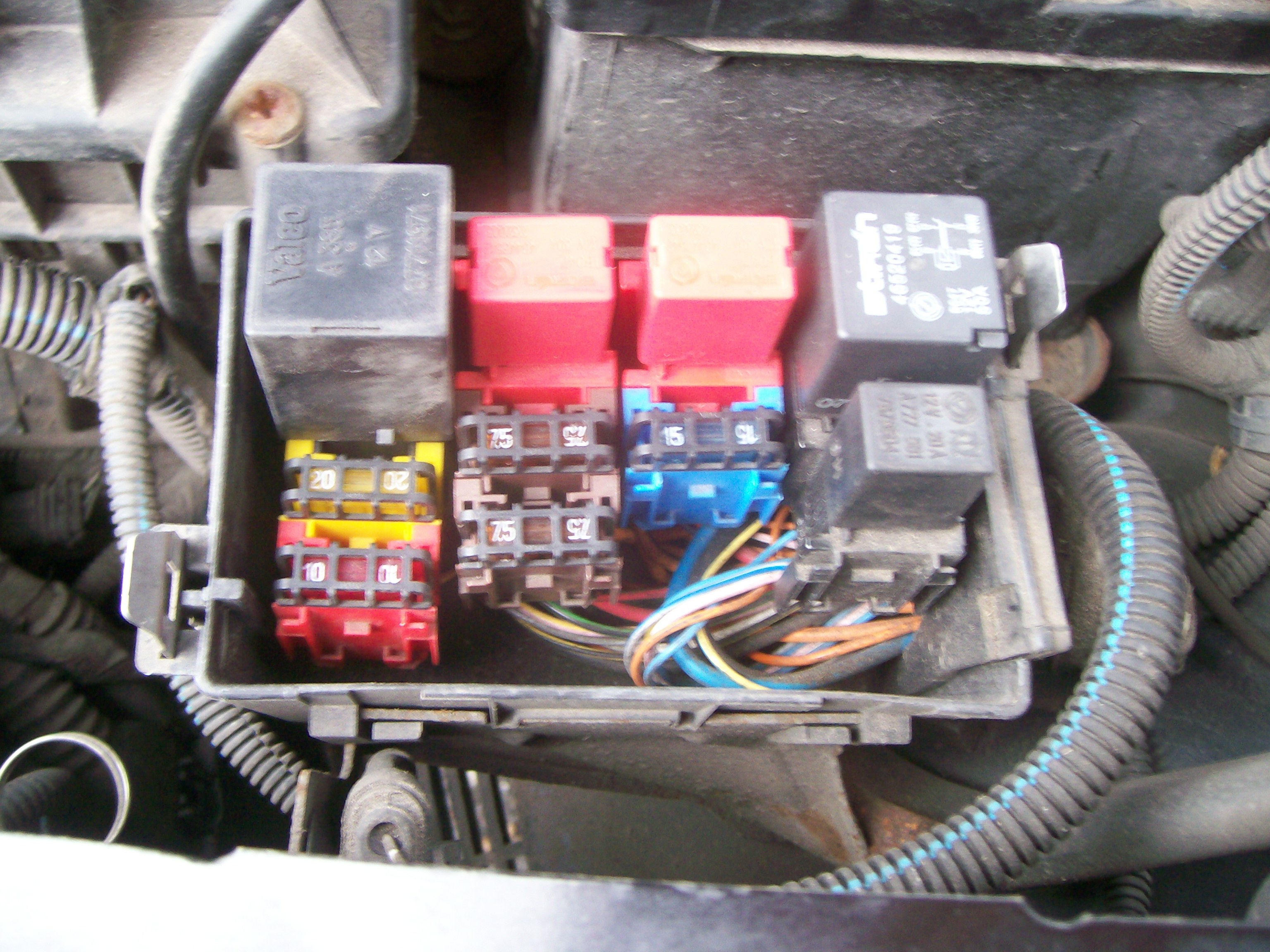

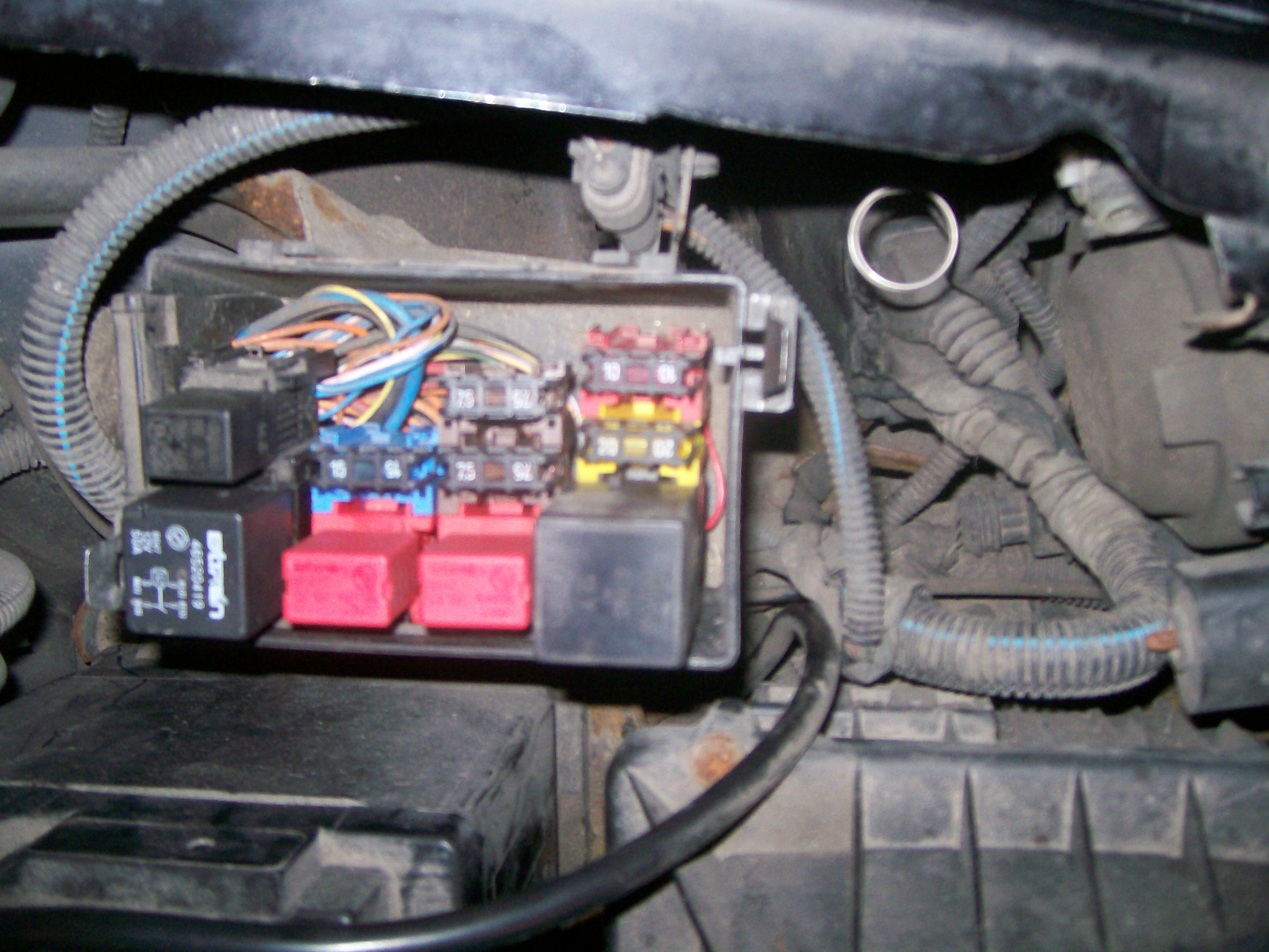

I've found a multimeter and checked the red relay ( with fuse no.90 location C3 in the case next to battery ) probed the connectors under it with ignition on and error code light on; there is no voltage across either pair of contacts.
There was across the adjacent red relay C2 ( ABS)

My fusebox is like this, the black relay on the left is the cooling fan I think, the fan came on when the RAC man was tinkering at that end of the fusebox.
I'll get a focused photo when it's light tomorrow
my handbook shows this arrangement with 1 being lamda sensor heater, 2 is abs control, 3 is CODE for the 1.6 engine, 4 fan relay coils and 5 is headlamp washer pump
Of course, being a FIAT the car layout and the diagram are completely different.
I'm confused.
