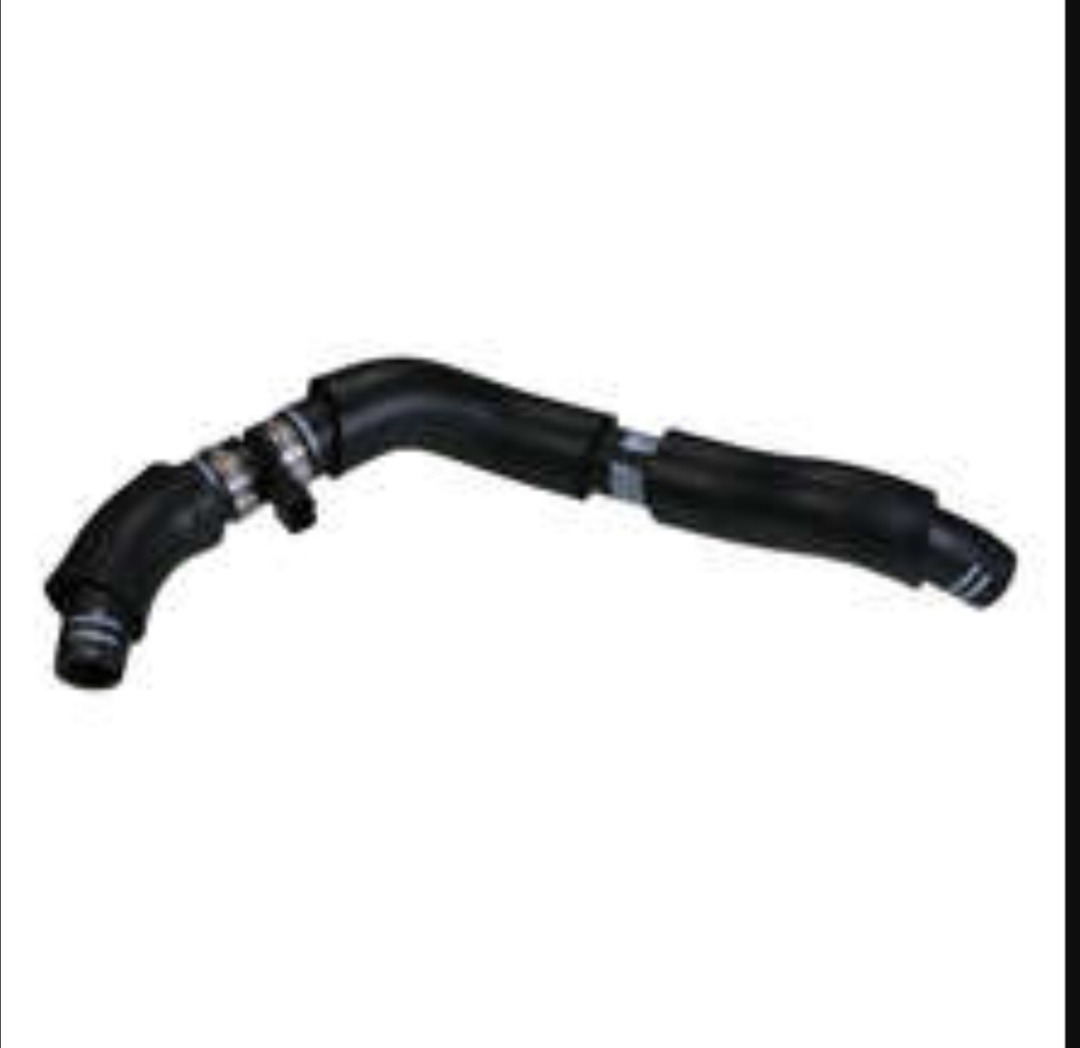

This is the infamous oil vapour heater. It can cause lots of problems on more recent vehicles as well. On my 2.8JTD the heater it shares F11 with the instrument panel, and if I had an EGR valve and mass airflow sensor, they would also be disabled.
The new one is 49€ at Axel Augustin. I would put up a direct link here if I could but the site won't let me do that.

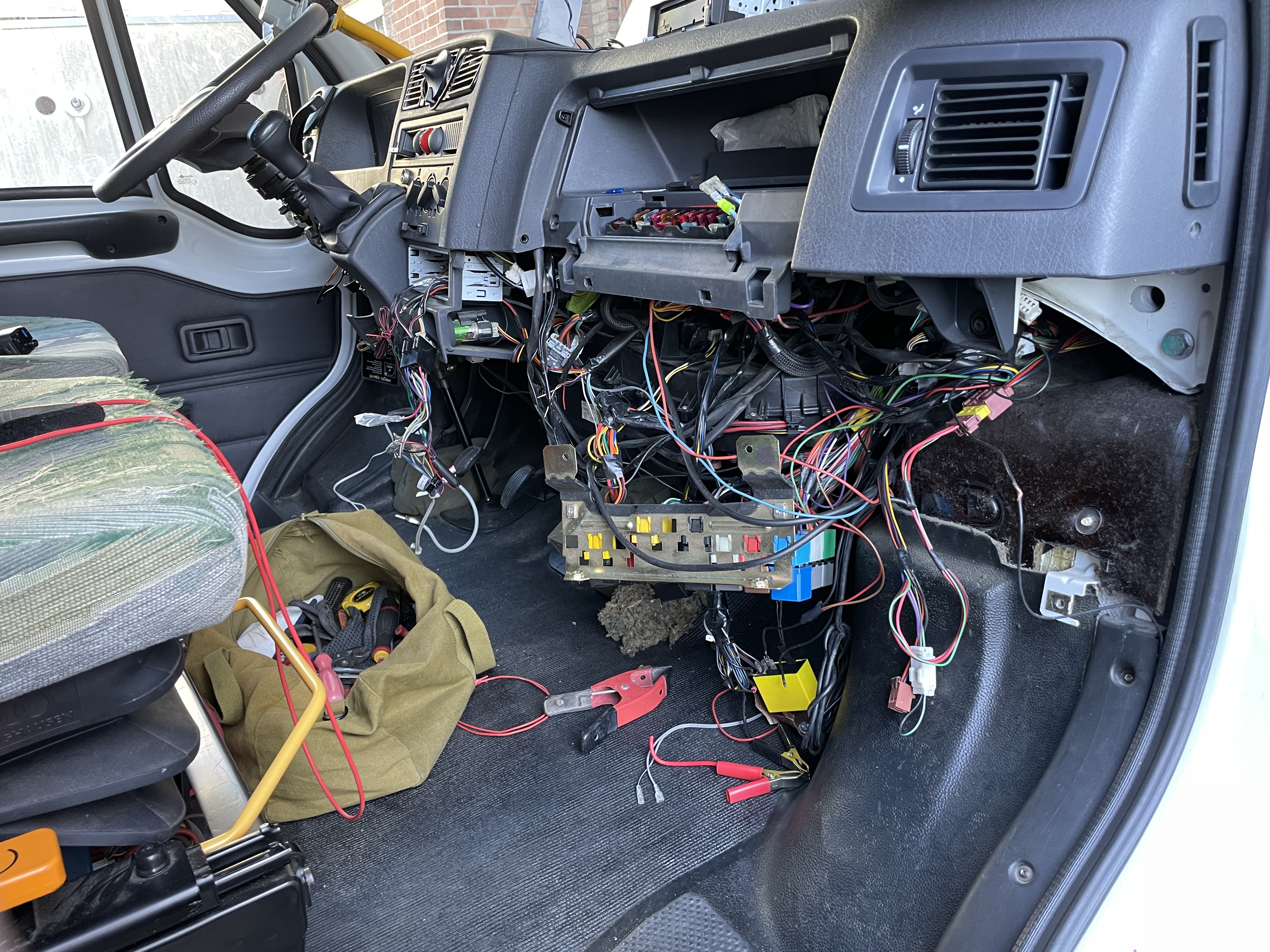

Well, the dashboard is starting to look like a storm passed by.

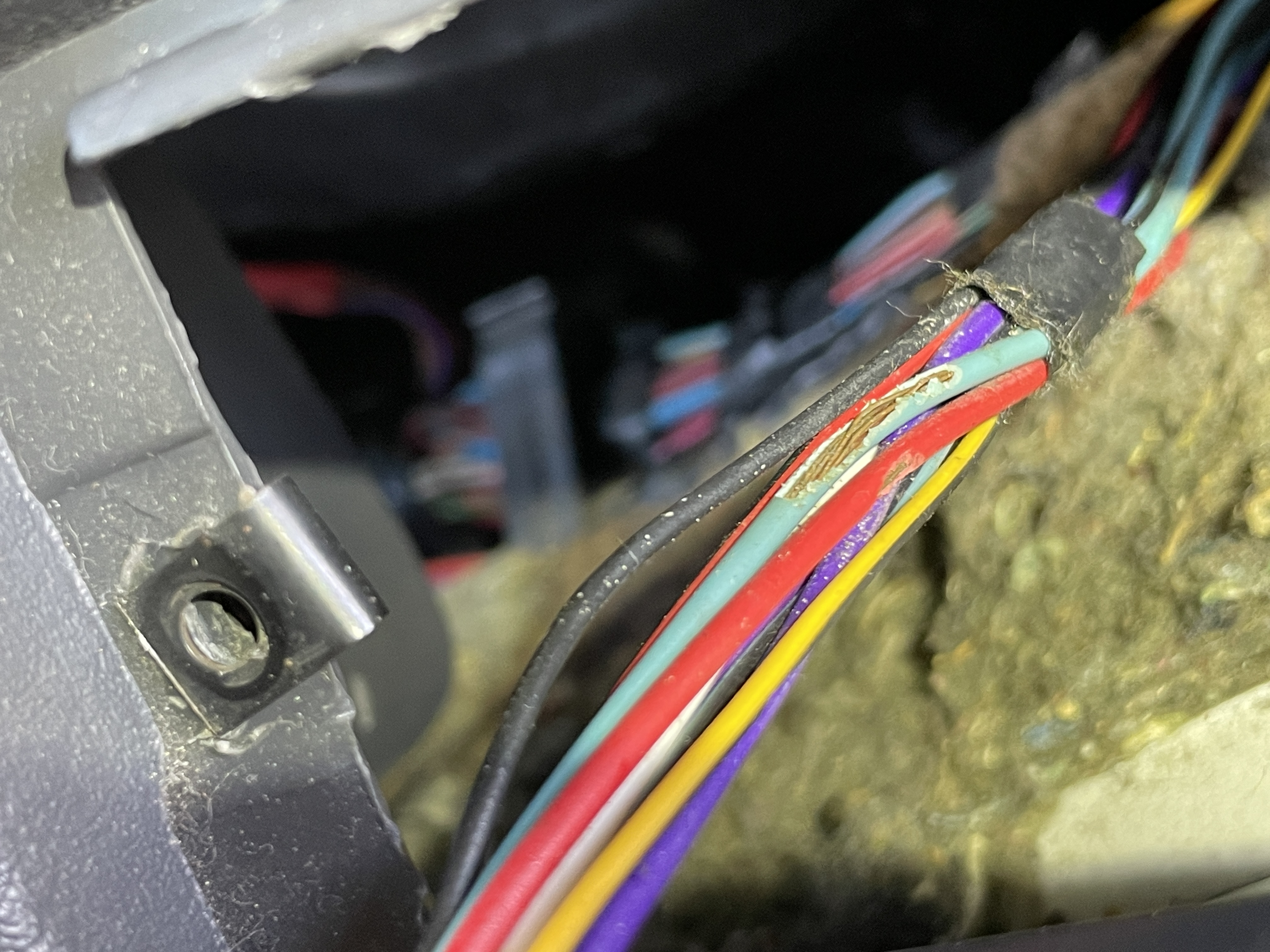

I found signs of mice under the dash so probably they chewed something. I’m hoping to find something.
Ok, I think it is solved. Dash was looking like this :eek:;
I have found a few damaged wires by mice under the dash but they where probably not the cause.

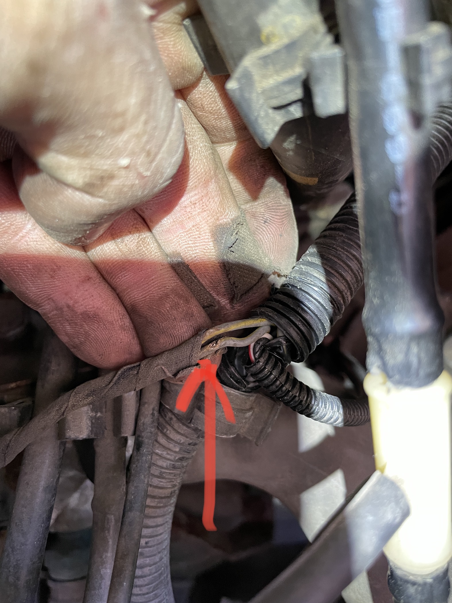

In the engine bay found a damaged wire in the wiring harnas, there was a split of the harnas and wire was rubbing against metal bracket.
I think it was wire to temp cooling water.
Been driving a few days and fuse did not blow anymore.
