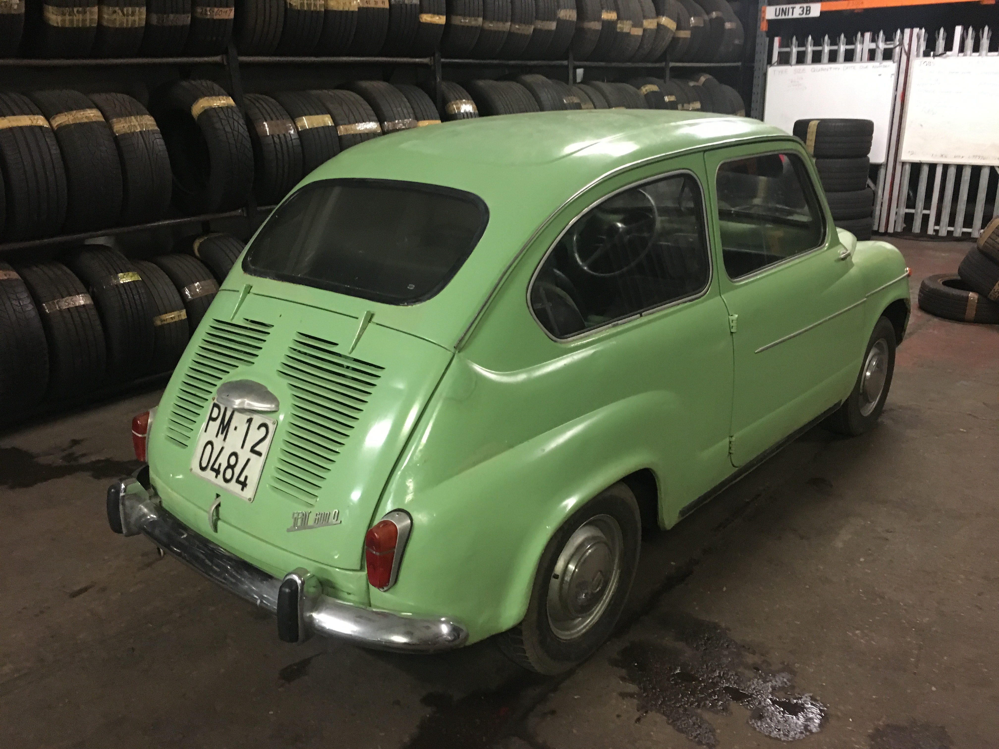

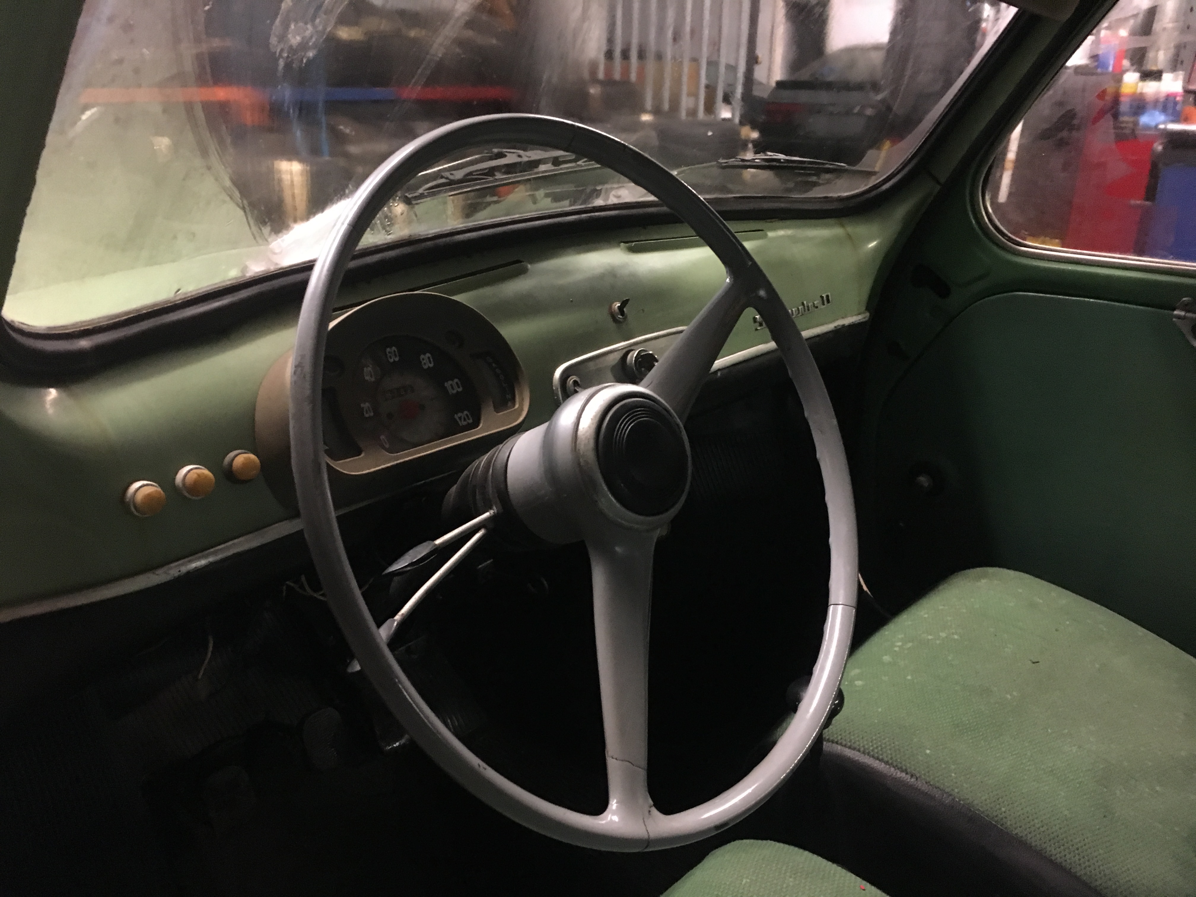

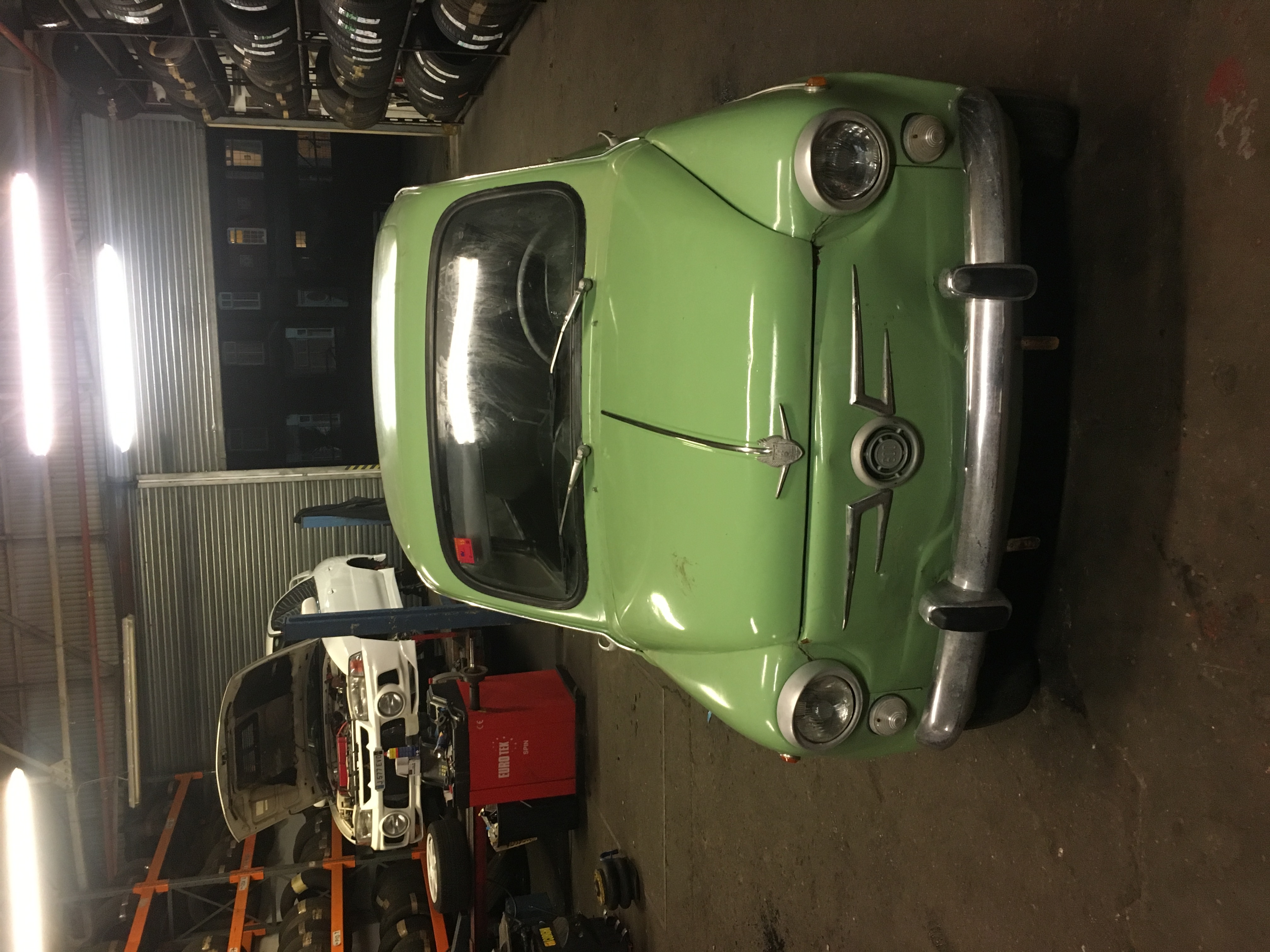

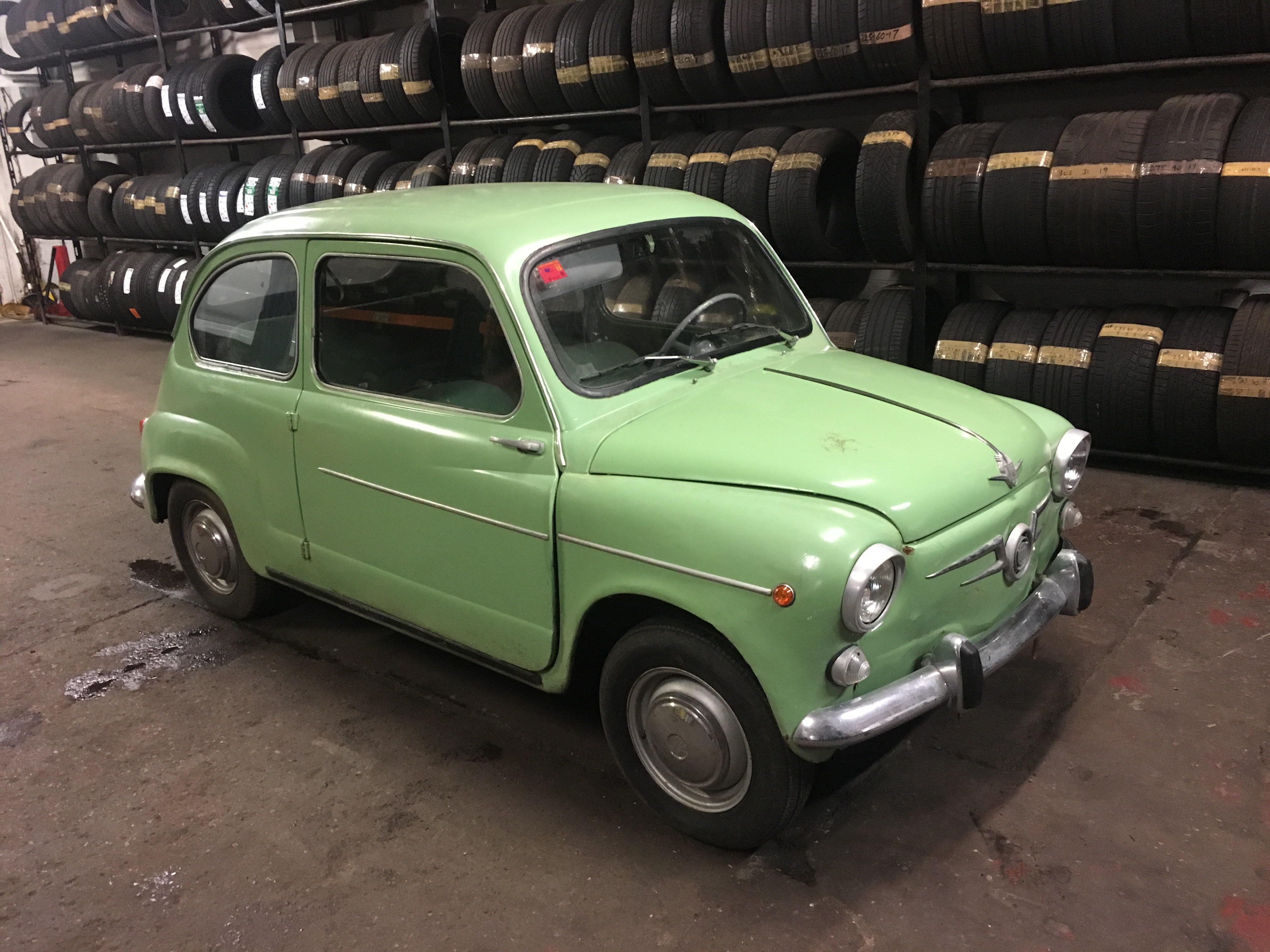

I've had a 600D I used to do production car trialling in - sadly no photos. They are rare in the UK, but look what I found in a barn in Menorcal last year - there were 3 of them
Haha no way I’ve just come across this post. I now own that exact green Seat 600 and brought it over to Manchester, England. My friend now owns the white one which is still in Menorca and now on the road. He drives or around when he goes over.

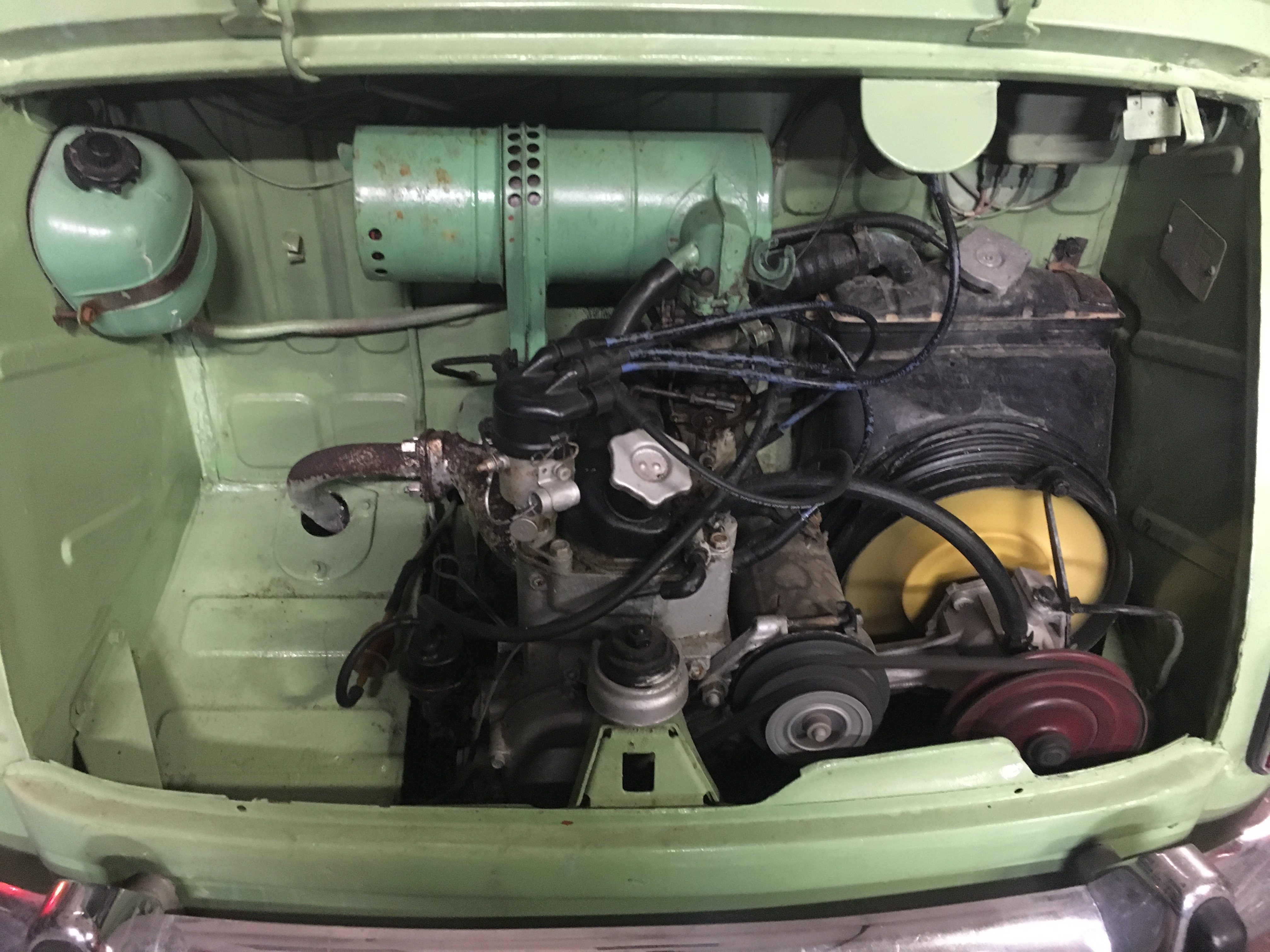

I have a very similar issue with the car, I drove it 3 miles to the fuel station and then on the way home starting running rough and backfiring then just wouldn’t move under its own steam and eventually died. 5 mins later it started and ran fine again for a few mins. Hopefully it’s just a carb clean that is needed.
