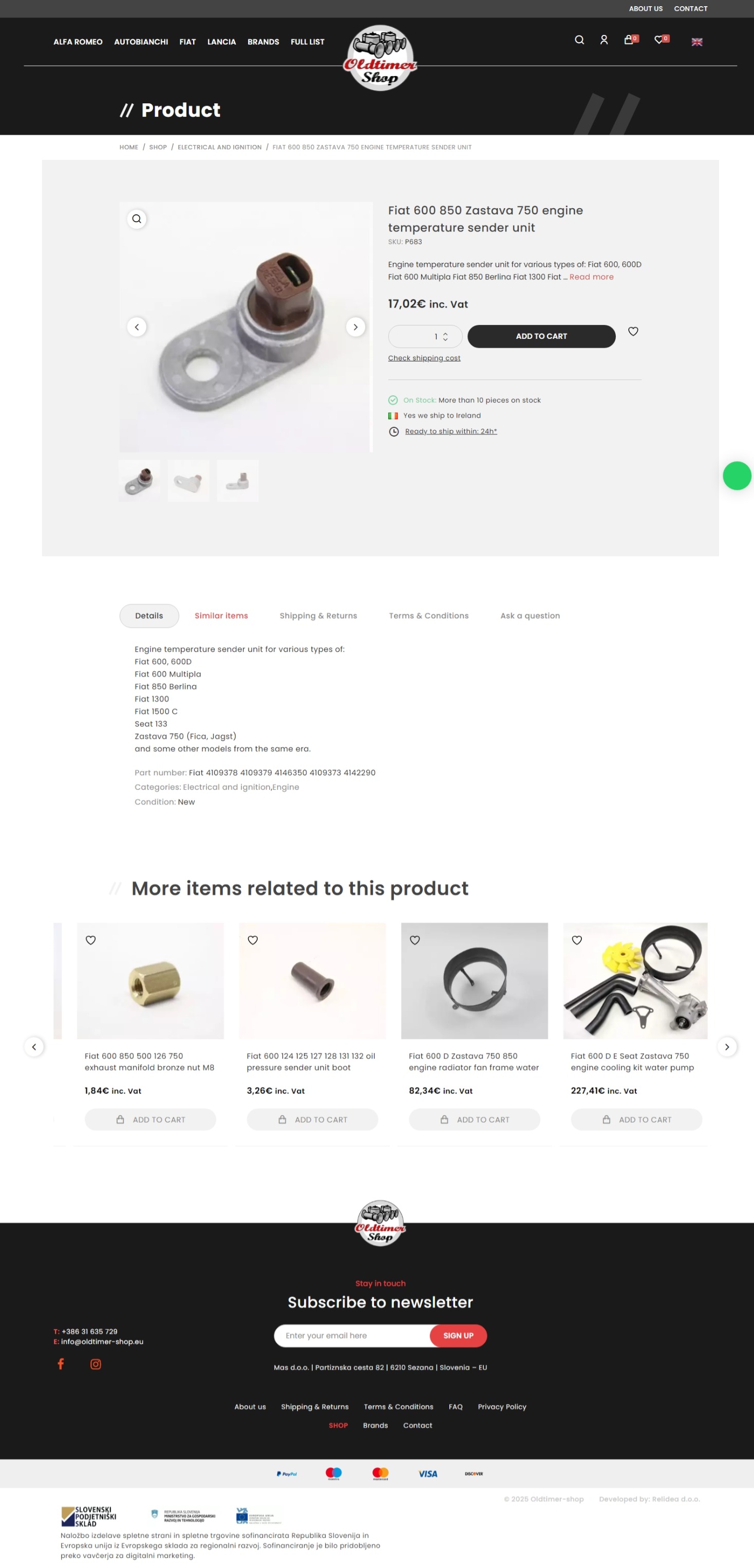

Here's a couple of European parts suppliers that list coolant temperature warning light sender units that fit under a Fiat 600 cyl. head bolt. Afaik, these suppliers will ship to the U.S. Please note the prices are in Euro so you'll need to check the price in $$ plus shipping before deciding if you want to order.
I can't remember if you need to omit the thick washer under a cyl head bolt if using this sender but this might be shown in a 'shop manual?
You'll notice there were 2 different terminal types used = spade or bullet.
There are some Fiat part no's shown on the 1st website which might help you to find a supplier in the U.S.?
There's also a Veglia (the original manufacturer) part no. on the 1st illustration of the sender unit but I couldn't make out the number :rolleyes:
