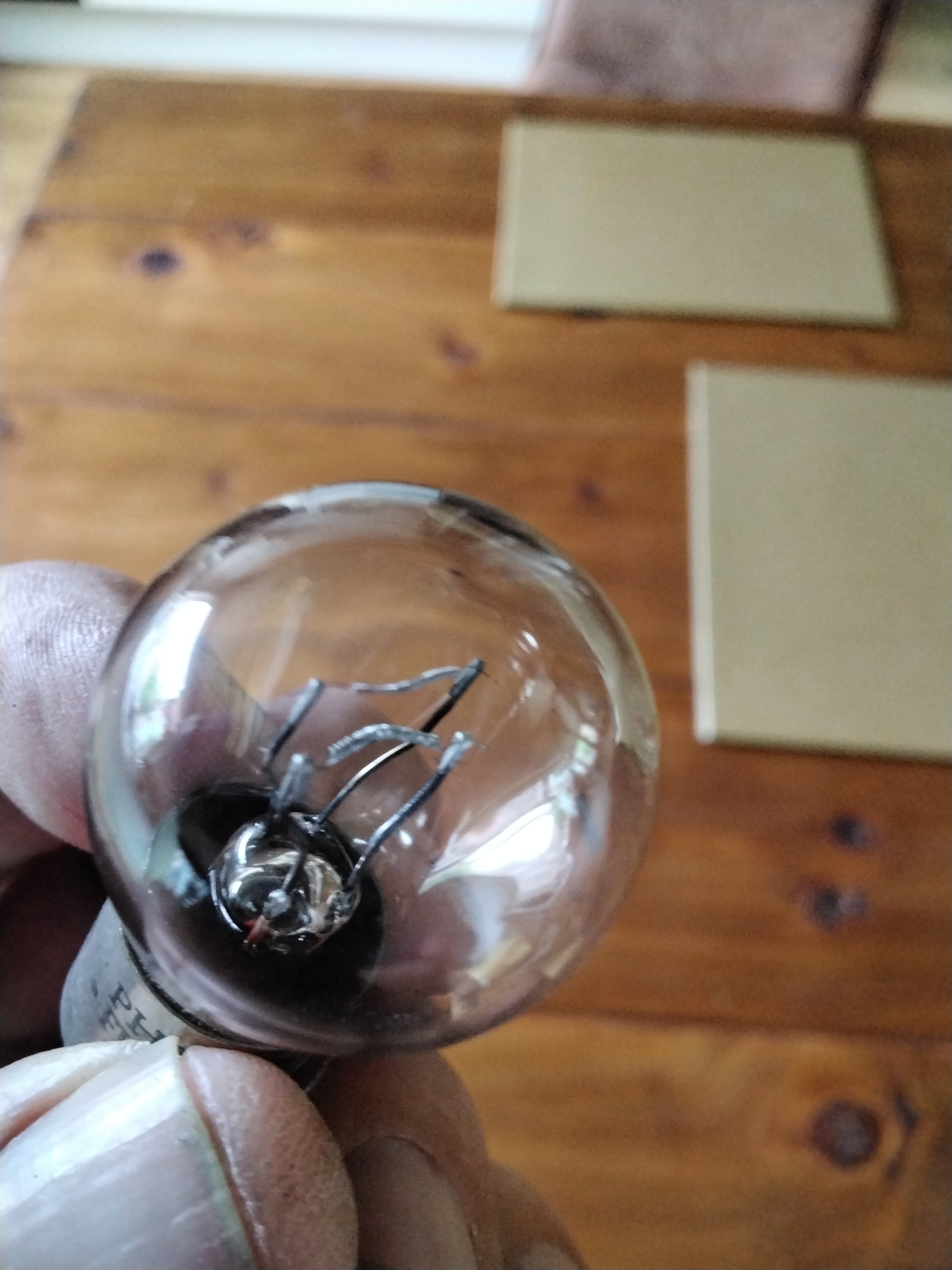

Might of found something.
3 side bulbs are 2 filament 3 stalks.
1 side bulb is 2 filament 4 stalks.
Which is correct I'm thinking 3 stalks but not sure?

Just seen this on fiat site, looks like it's 4 stalks so I'm getting excited, off to buy some new bulbs.

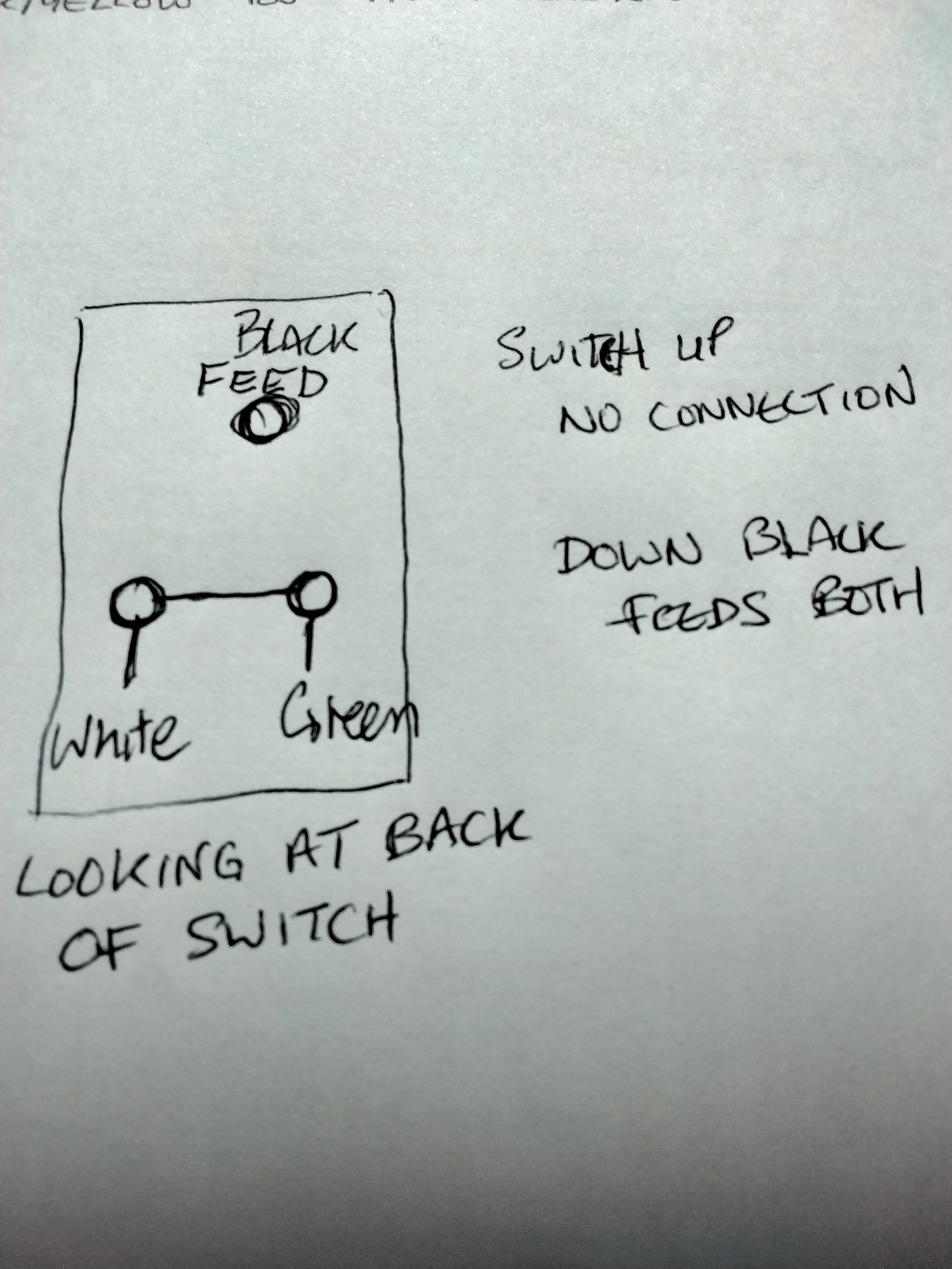

Disconnected all wires to stalk ad did a continuity test.
All looks logical.
This should help me understand what's happening in each stalk position.
Gonna now connect the stalk and fusebox and diss wires to auxiliaries like wiper etc, take a live feed straight to fuses to see if I can get lights, turns as should be.
