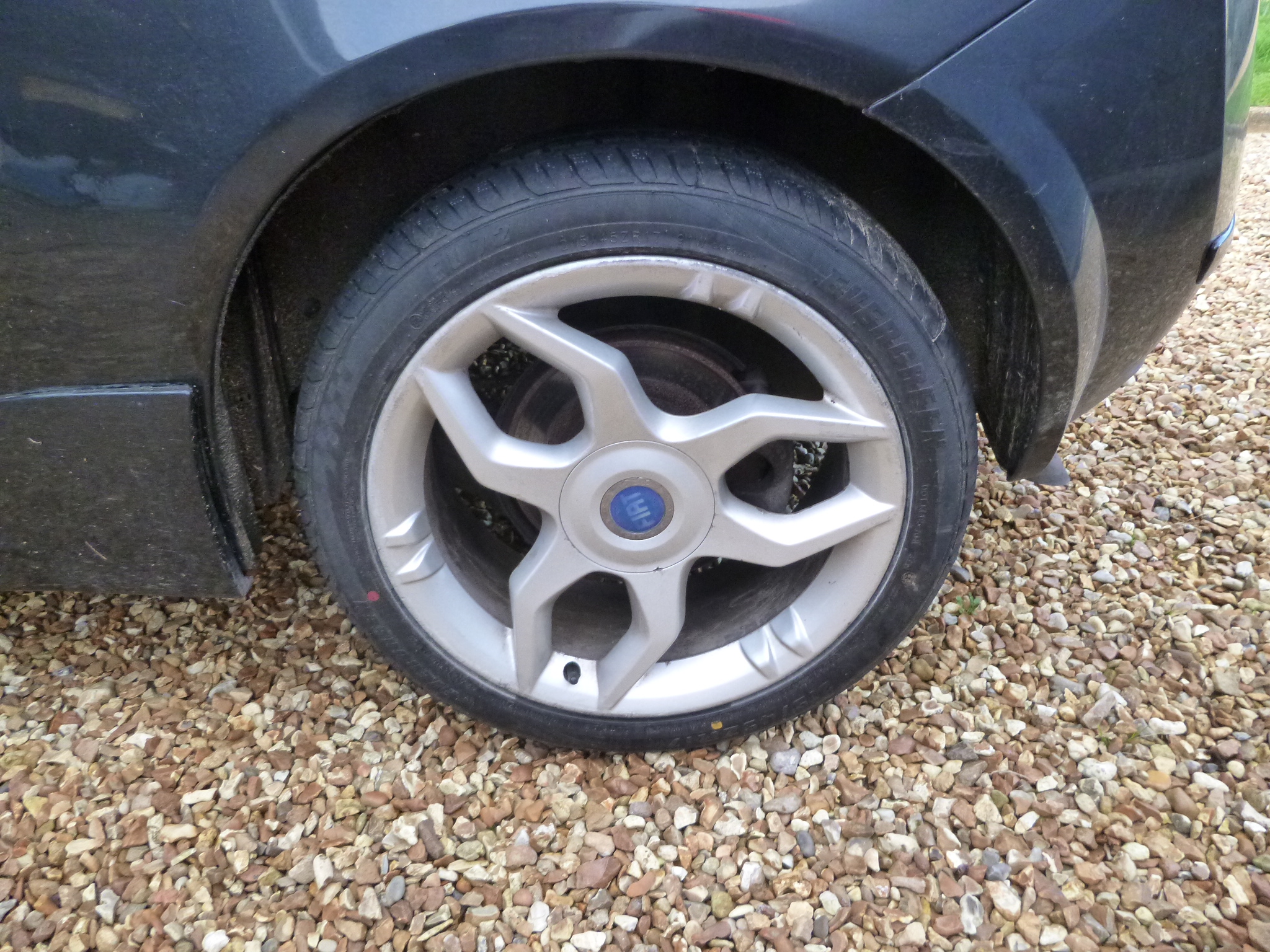

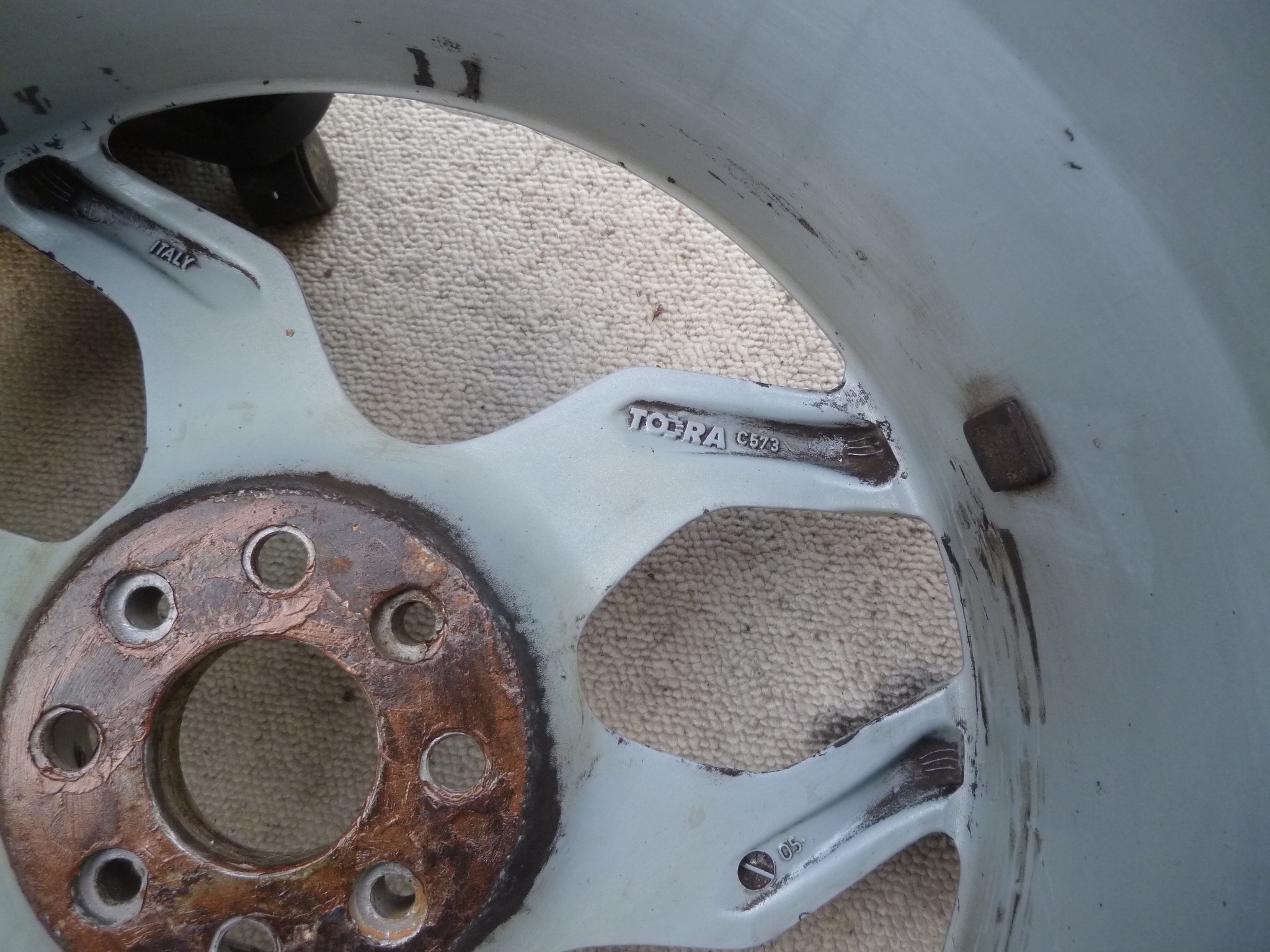

I have these wheels,
There isn't a Fiat name on the casting, it just says TORA C573, but are these the 'Claw' ones ?.
Many thanks (y)
The Tyres n are good for tread but obscure makes (3 different). I'm thinking about getting 225/45's instead of the 215's for a bit more wall height and commensurate rolling radius.
Anyone else tried that size ?

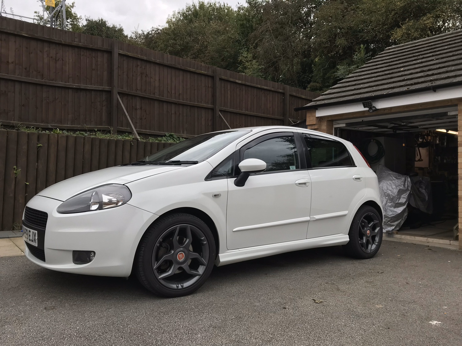

I’m not a tyre expert but I have the 215/45 on the claw wheel as you, I thought the 225 was width, and 45 height, so not sure what wider would change, I know with the set up I have I would describe the ride as robust.IMG_4480.JPG

I’m not a tyre expert but I have the 215/45 on the claw wheel as you, I thought the 225 was width, and 45 height, so not sure what wider would change, I know with the set up I have I would describe the ride as robust.View attachment 205797
The 45 isnt a mm..measurement
Its a % of the width ;)
Known as 'aspect ratio'..
Hope that makes sense

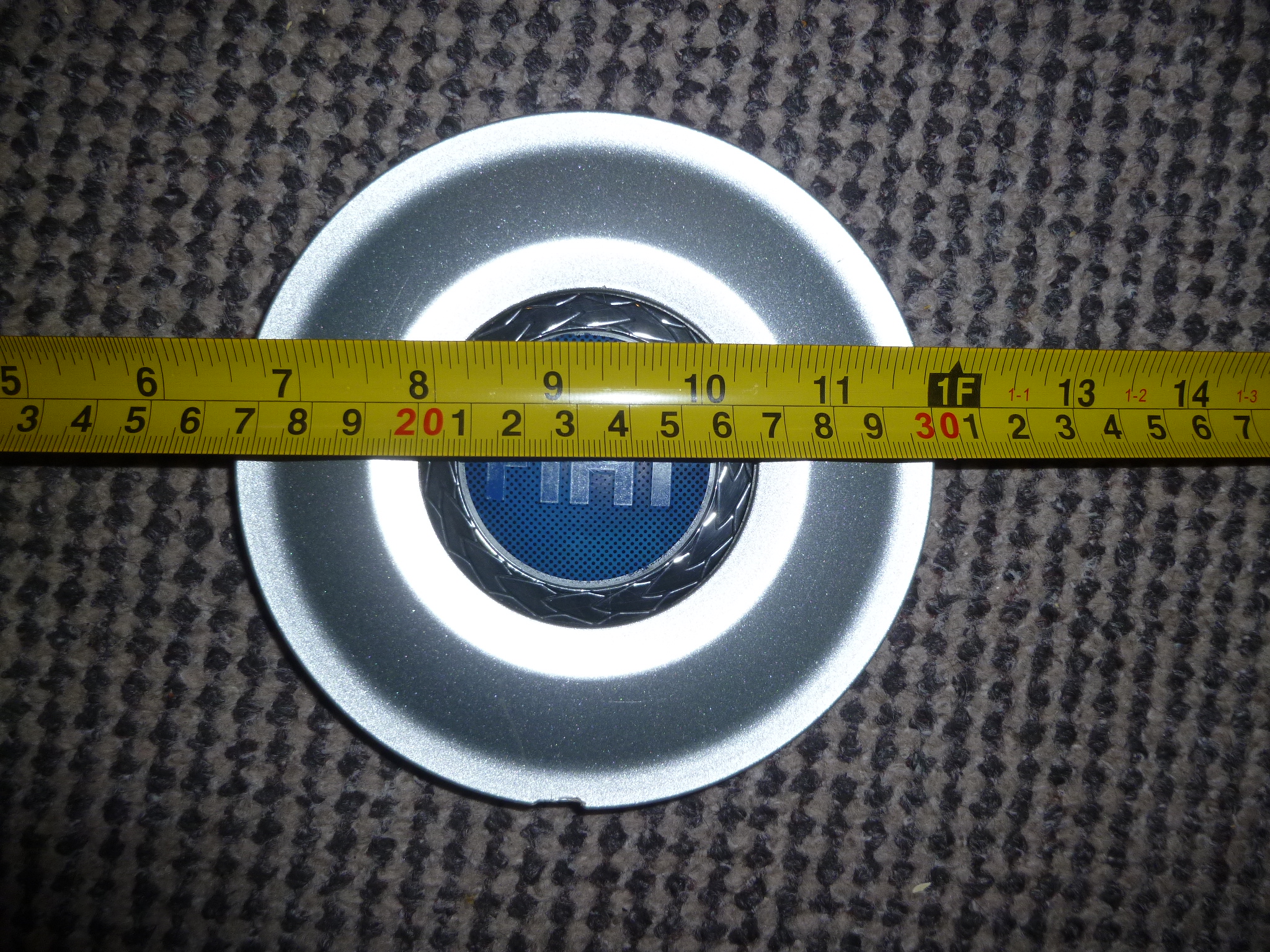

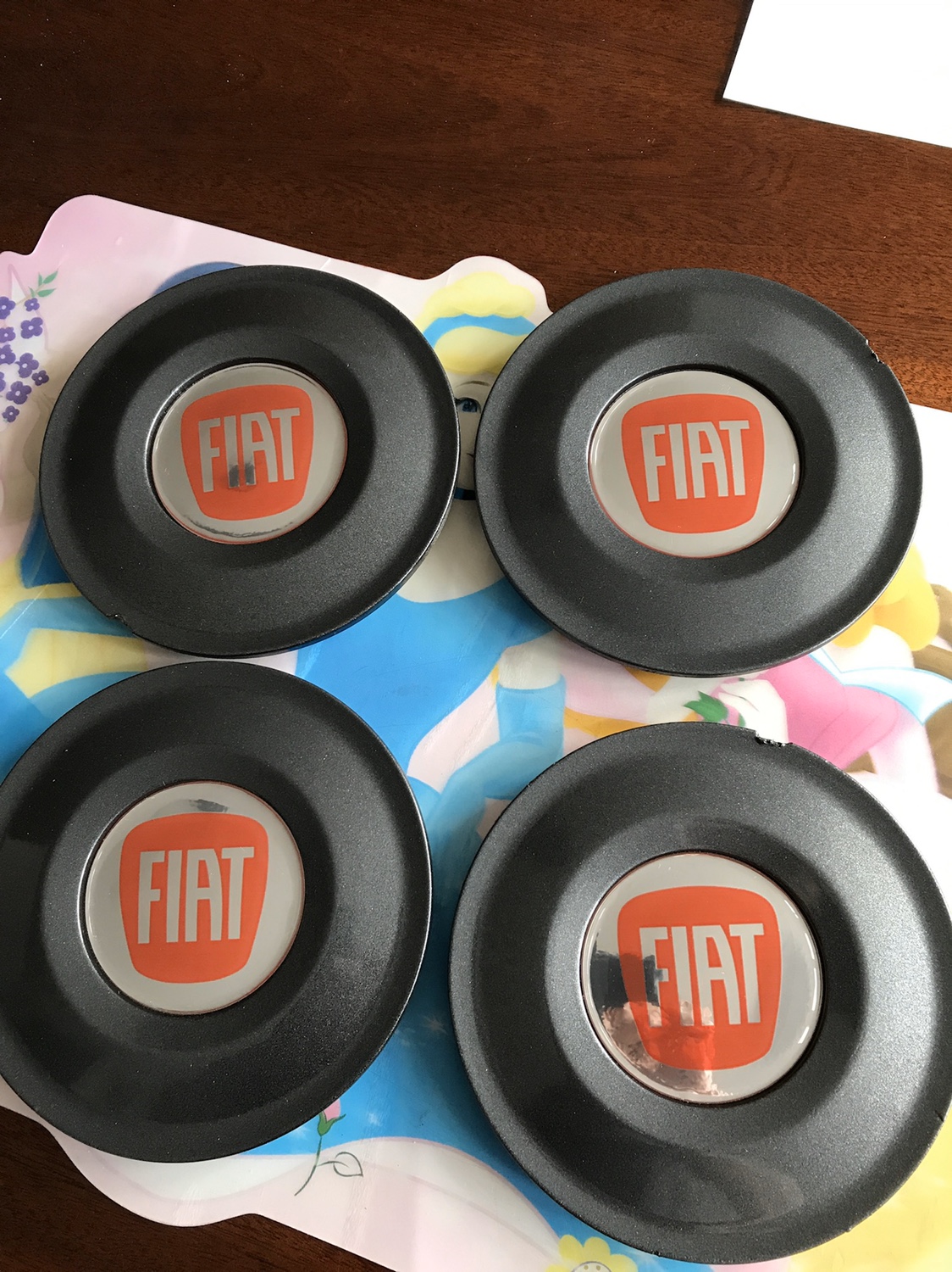

I did mine with gel dimes from eBay, they where cheap and a few years have gone by and they are still going strongIMG_3865.JPG
Neat :), what did you use to cut the centres out ?. I was thinking of clamping them on my pillar drill and using a multi hole type cutter.
In a perfect would I would softly hold them in a lathe chuck, and bore out the centres. In my shed it's a bit more basic :D

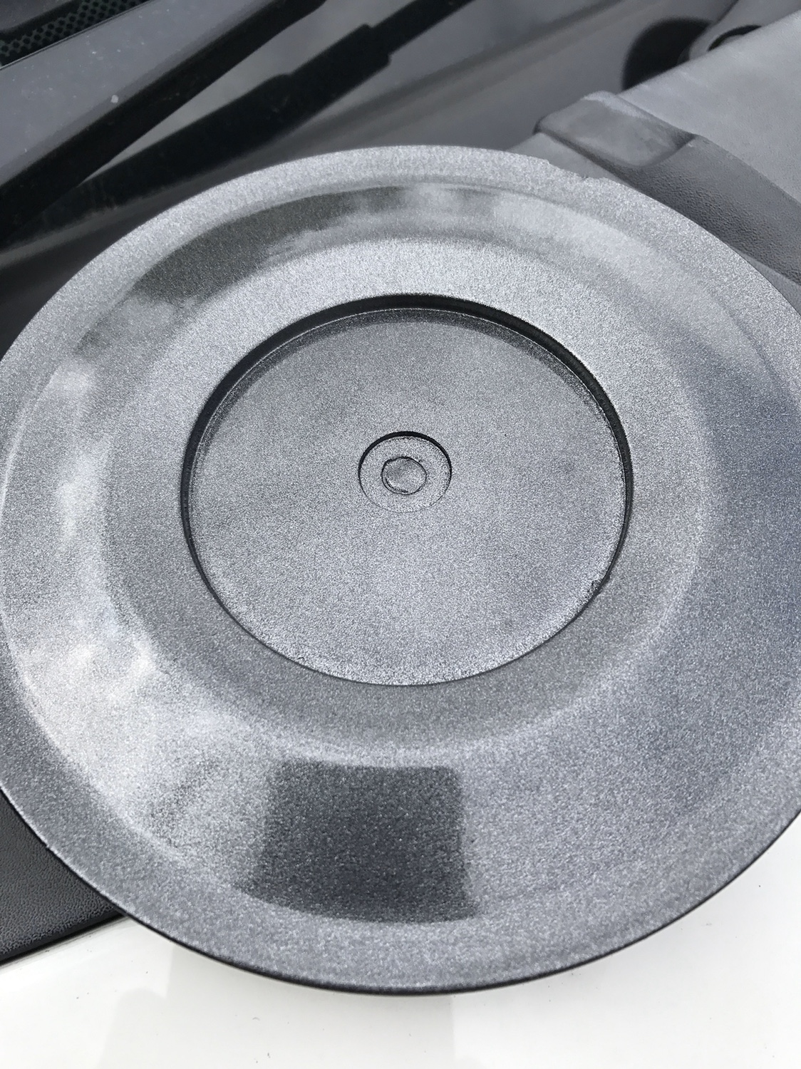

I just heated mine up with a heat gun and applied a degree of violence, two tiny screw drivers and some leverage, but a more scientific method would be drill a hole from the badge side small self tapper and apply the violence by hooking under the head and either straight pull or use leverage with protection to the plastic cap. I don’t recall much in the way of resistance.IMG_3775.JPG
The moulding on the rear is probably a manufacturer’s process as the badge less pic shows the surface under the blue badge. I think the glue was only on the flat parts.
Yes.. I think I would try ting the badges off the cap with a screwdriver or two, as you say.
Good idea to use a heat gun though, to soften up the glue. I'd have probably tried it without and wrecked something.. :D

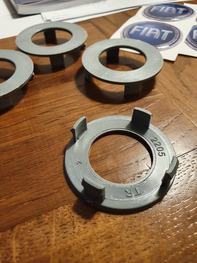

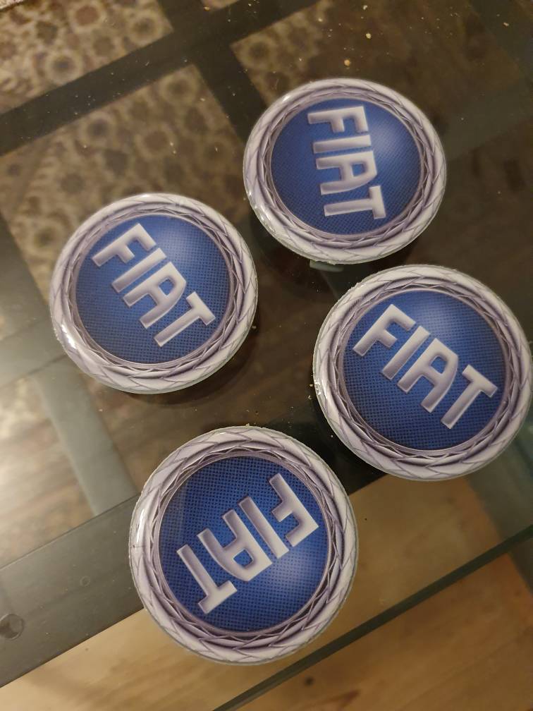

Coming back to replacing the logos - I went out and bought these 55mm 3D gel logos (they are available in a variety of different diameters also) on eBay for £7 and a set of 55mm wheel caps for £5. Glued them together and they look really good. Certainly the best I've had. Certainly suitable for replacing faded ones on your current alloys.
Otherwise if you have wheels with a 50mm wheelcap diameter hole there are plenty of options for wheelcaps. The part number they go under is B632, you'll see a ton on eBay. 20200207_205154.jpeg20200207_210547.jpeg20200207_205236.jpeg
