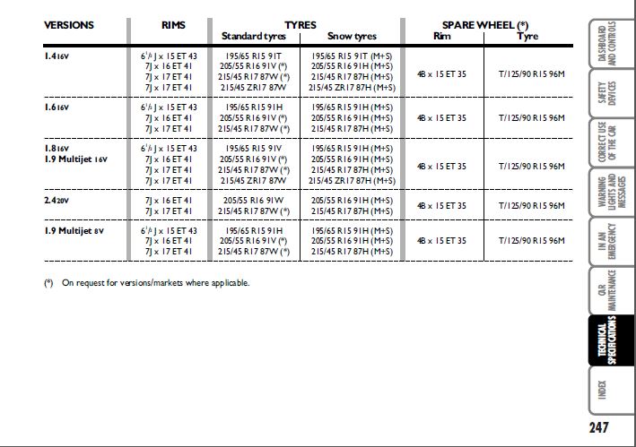

Hi the stilo jtd ive recently bought has black Abarth wheels with 215 45 17 nearly new bridgestone tyres, not lowered at all but it handles lot better than my previous jtd on standard rims and tyres, the problem is for a start theres no rim protection with these tyres they dont look wide enough for the rims what width are the abarth rims? also i reckon if i hit a pot hole id wreck the rims, and theres to much tyre noise, with 225 50 17 tyres fitted will they rub on the arches? or may be 225 45 17 tyres but i dont think theres much gain in the tyre wall size withe 225 45 17 tyres, any advice apreciated:)
These are the various rim/tyre options from the Stilo owner's manual.

Thanks Davren it appears 215 45 17 tyres are there in the owners manual, il wait and see what other stilo owners have to say,

Interesting just been looking at the tyre size calculator i use and taking the 215 45 17 as standard tyres the other jtd 8v options in the owners manual give 195 65 15 whichs calculates 1.6% to slow and 205 55 16 calculates 0.8% to slow, theres no speedomerter error though comparing 225 45 17 and 195 65 15, i do drive carefully but curbing wheel rims happens to us all in the end, :)

Artermis what i mean in the message above is that all the tyre options for the stilo jtd in the owners manual have a different rolling road radius, i did realise the speedometers are not 100% accurate and altering the tyre size alters the gearing, it would appear that fiat are altering the gearing with there tyre sizes them selves on the jtd model:)
