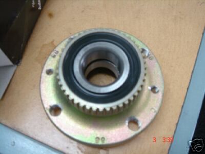

ie. This is a bravo/a abs hub. No magnets, just teeth that create pules to determine rotation speed. No position and probably no direction

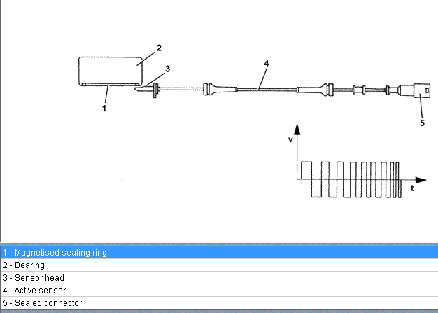

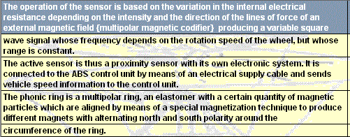

Extract from eLearn ABS page:
The sensors are active, i.e. they consist of a Hall-effect receiver that faces a magnetic coding device built into the hub bearing. Under these conditions, the signal is less influenced by electromagnetic interference and temperature.
The sensors are very thin and long. Hard to know what bit is actually reseptive.

Have you seen the donor cars hubs, do they look like the pic?

Right. Not VR sensors then. They are the new active two wire type. They use a multibipolar codifer which sounds quite hard to reproduce away from one of these special bearings. Looking on ePer, there is indeed a differnt part code for ABS model bearings.
I've attached a couple of pictures from the software manual I have that explain part of what is going on. It is the DTE thing, not eLearn as I keep calling it.
