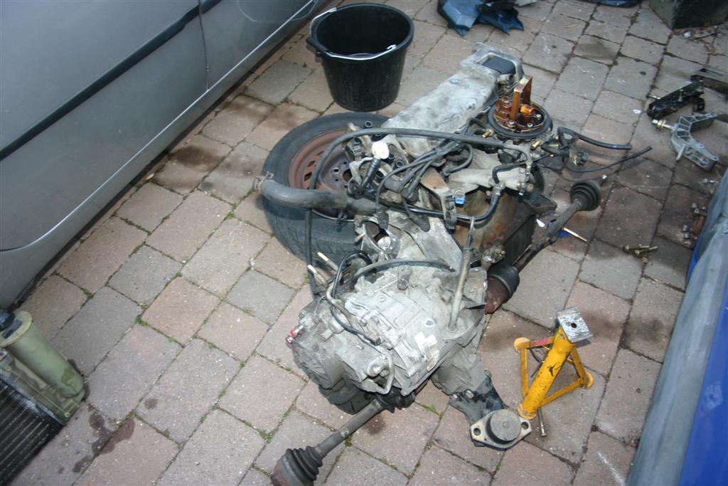

Anyway. I have the new engine in position, but any mounts I have for the gearbox (rear and side) aren't anywhere near. I blindly assumed I could fit with Panda mounts- WRONG! The mounts I have with the CVT box are different anyway, but I have normal ones in the garage.
Any ideas? I know Oldschool will know as he says he has done it, but he seems to be busy at the moment- if not always!

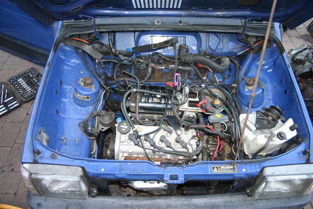

I gave the whole under bonnet area a good scrub before yanking the 16v underneath. Quite a lot of paint came off the bulkhead shelf! Oh well.
Getting a Selecta may have not been the best idea as I will need a whole gearstick arangement with cables and the clutch and brake pedals with main bracket. No way I can use the Punto stick. :bang: If anyone can help in this area, please PM me.
Pleased with progress though, just need to work out how to mount the gearbox end of things and most of the pieces of the jigsaw will be in front of me.

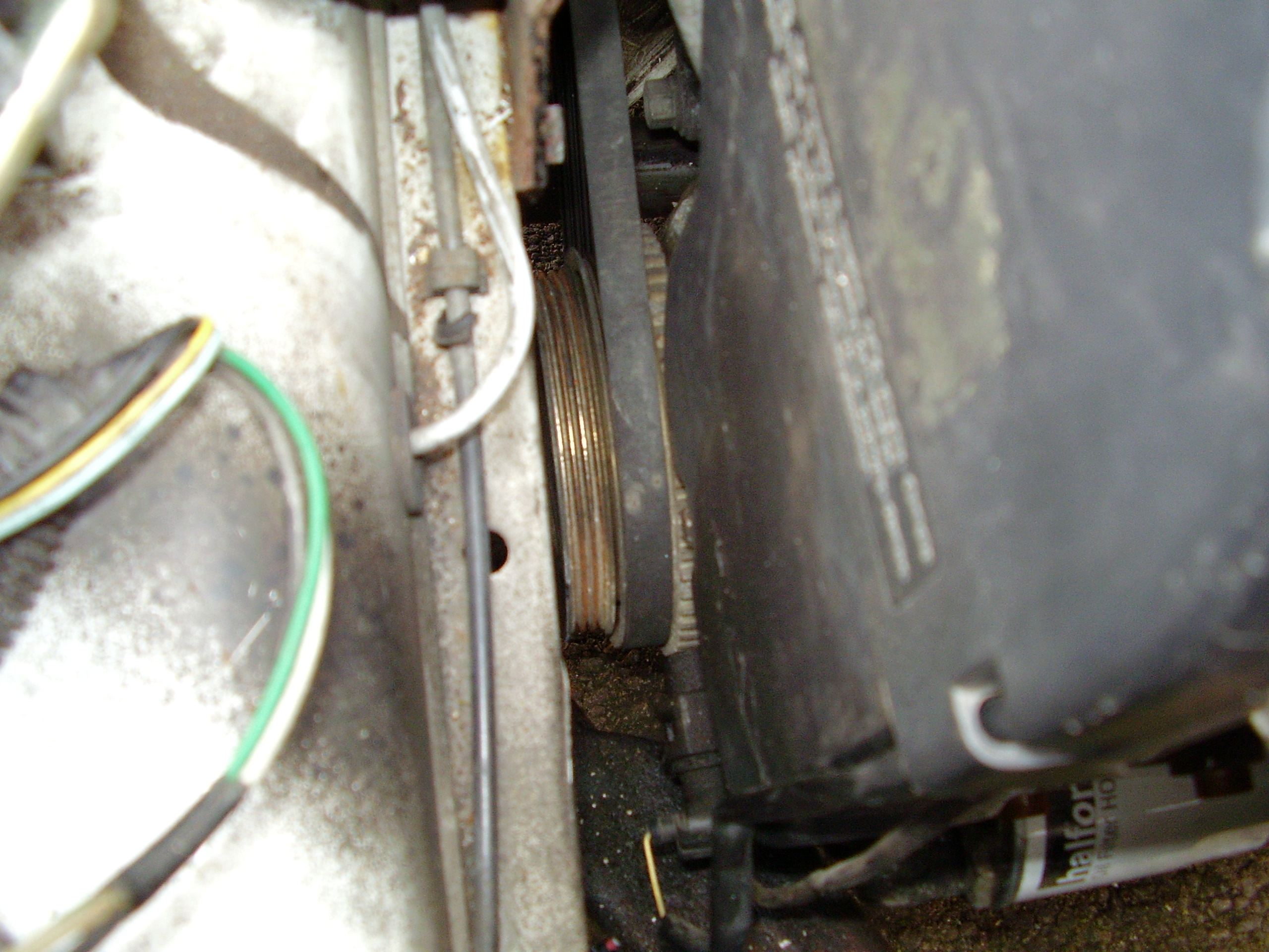

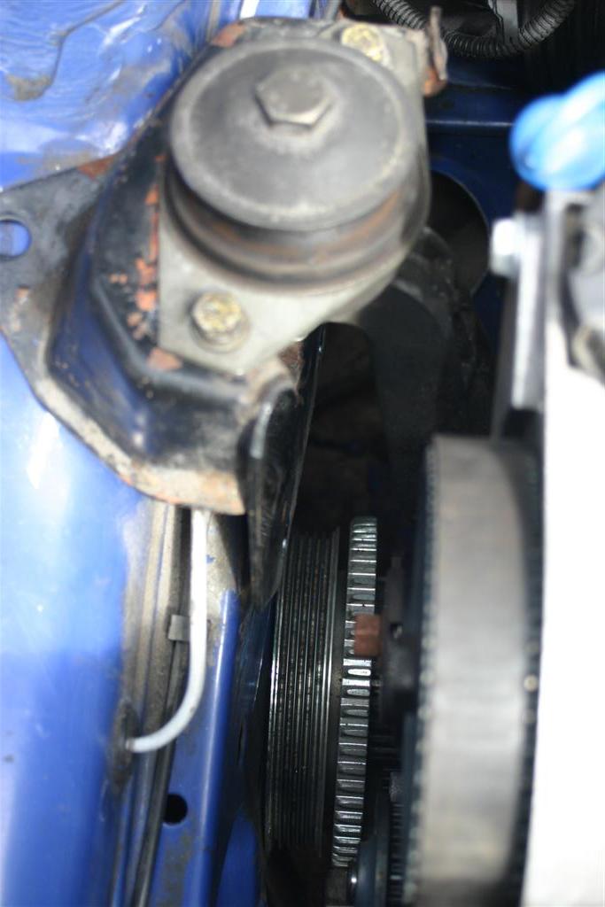

Right, well the mounting problem gains another problem- I have the engine mount lined up on the car ready to go on and the crank pulley is jammed against the wing (see photo). This 1368 does seem to have more protruding bits on the crank end. None of my alternators line up either as the crank seems so far out. Could be a design change from older 1242s or could be that it was aircon. Either way, headaches. :bang:

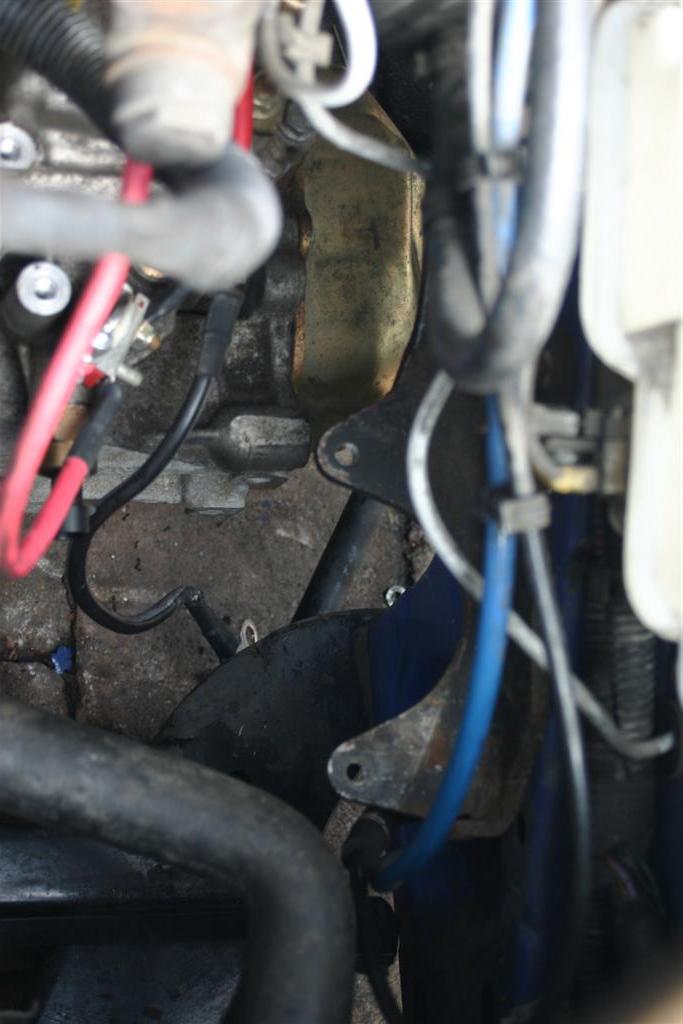

The second photo shows the side gearbox mount gap that must be filled. To fit, I will need to use the three holes on the box visible in the picture, it must then turn through 90 degrees and go almost straight up. It is similar in design to early Puntos which use these holes, but the punto design shoots off away from the box to bridge the gap between the box and the wing because it is a wider car.
Ahhhh, this one is solved. Looks like the mount has less reach than a normal one because it's a Selecta. Obviously helps to fit the larger box in at the other end. Just as well I've got other Pandas to check all this out. That's me routing in the garage for half an hour to find a normal mount then.. :)
I was sure that engine mount didn't look quite right:D
It is tight fit
and a shot of my gearbox mount in the slim chance it may be of use, but I sure you can sort it with some box section and sheet steel :)
Thanks Damon for the photos. When you said different mount length, I thought you meant height. I has certainly complicated things getting this selecta. Oh well.
Yours looks very close even with the right mount. I couldn't find a normal FIRE mount in my garage which amazed me. Found one on a spare 769 which was snapped in half! The support on the wing is different too, so will need one of those. For transmission it looks more and more like cinq mounts could fit or at least give me something to work with.
