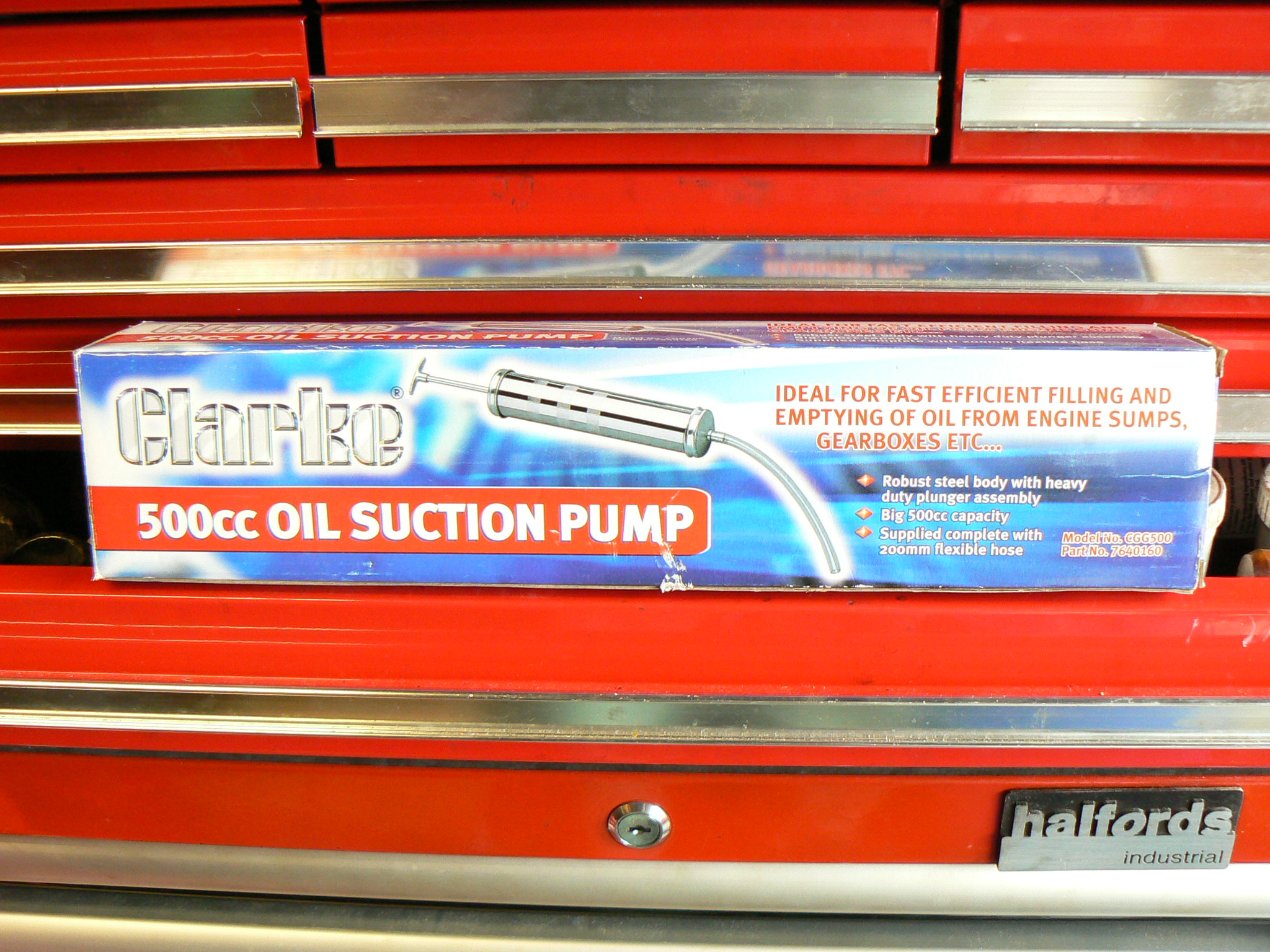

I also have the syringe you can see at the front of the picture, here's it's box:
I keep this exclusively for doing transmission oils and I can recommend it. It has a nice large bore pipe which works reasonably well with cold gear oils and it wasn't all that expensive.
