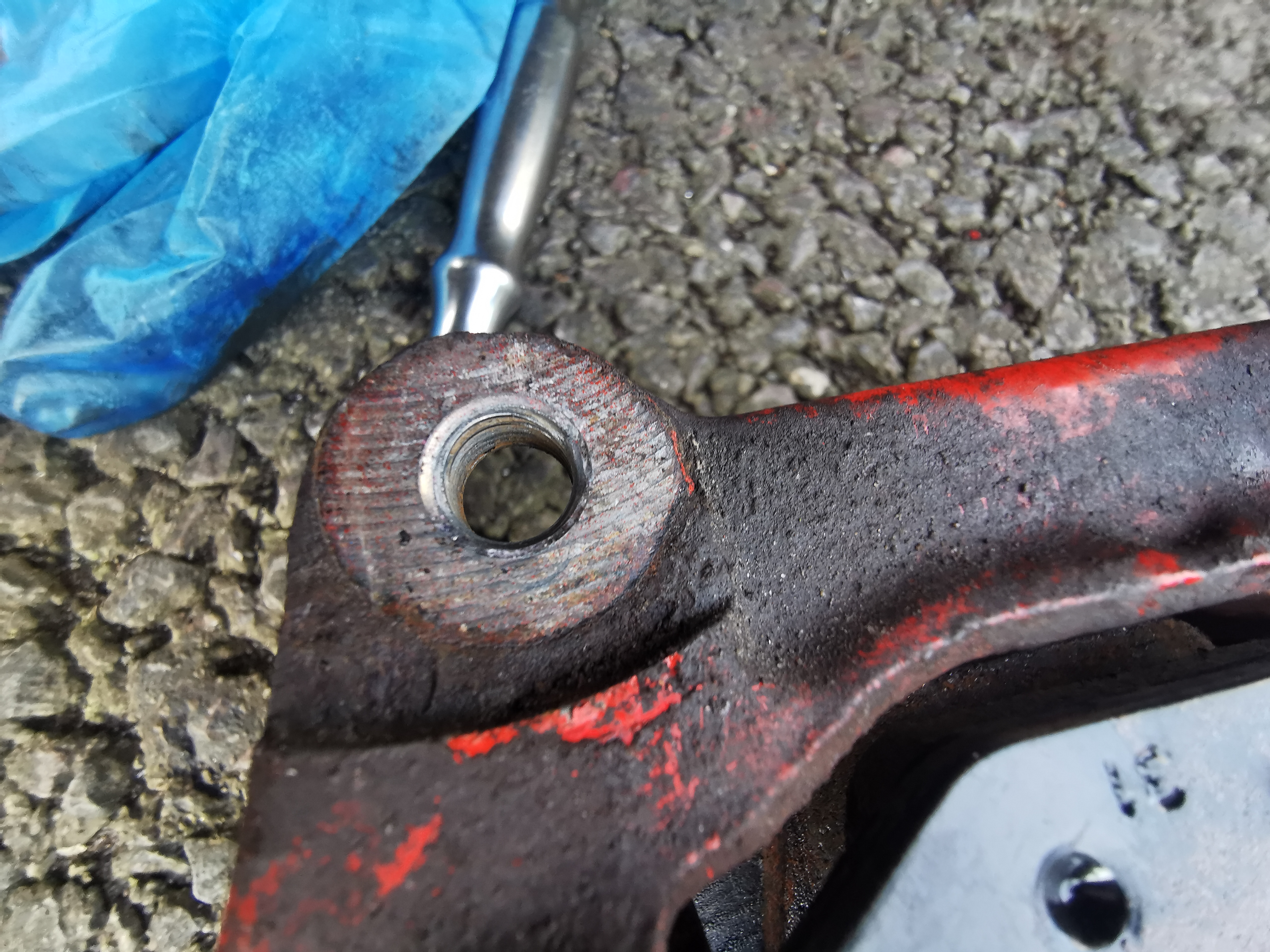

Hi guys

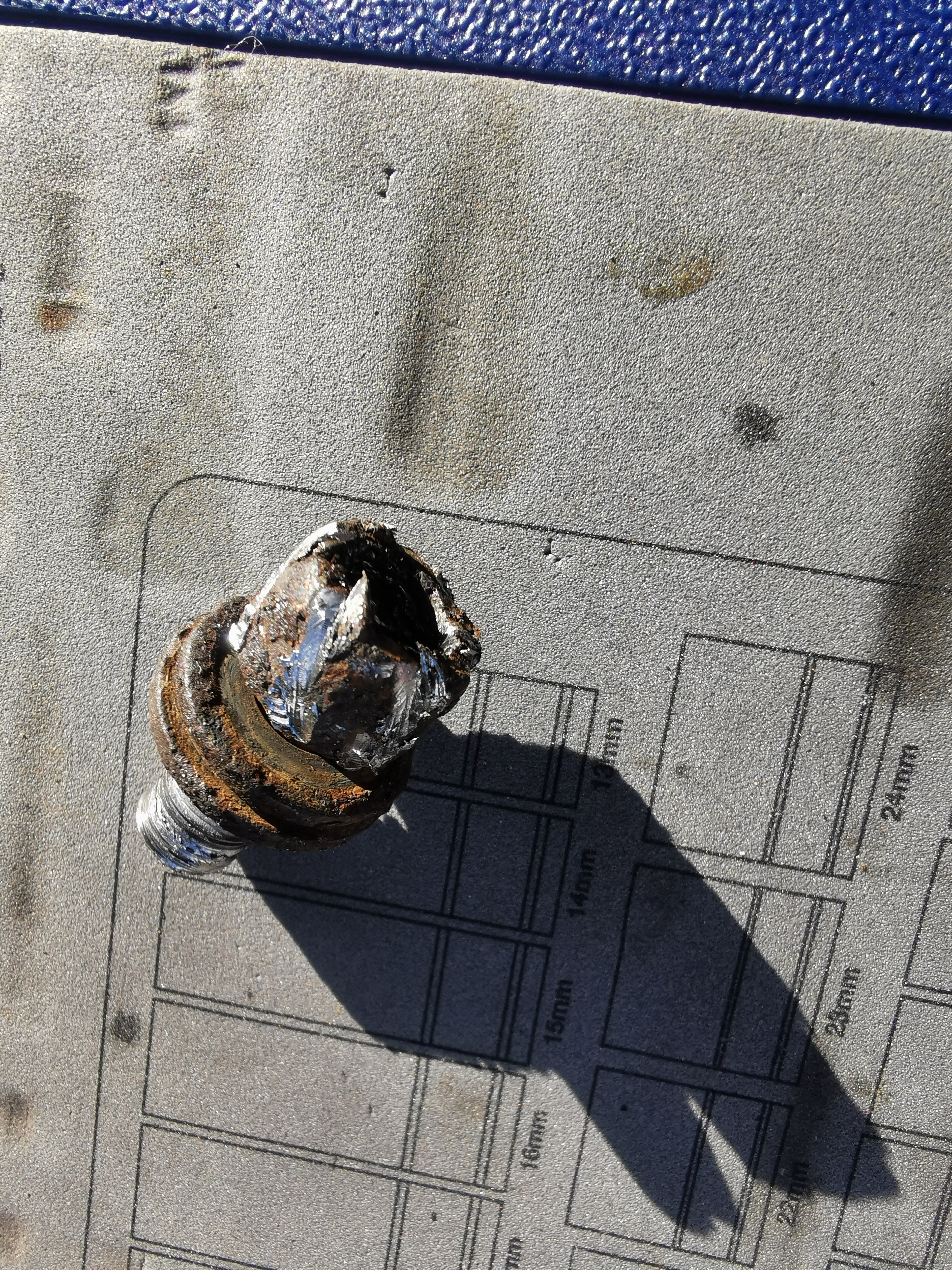

I need your help please. I tried to change my offside rear brake pads and discs today. The lower 8mm Allen key bolt was rounded off so I had to use an extractor to get it out... Unfortunately the carrier that holds the pads in place is buggered and the new bolts won't go in square to it.
Does anyone know the part number for the carrier please. This is a pandonium edition, so has the red painted set up.
Tia

M12 x 1.25 I believe
Don't have a 100HP to check though
95% sure it's fine and 80% it's M12
Start the tap from the reverse side good threads
A taper tap is all you need for this job
Should have thread lock

Cheers mate. Do you think this sealey kit will do the job?

Sorry no that set does not contain any fine pitch taps
I'd just the buy what you need as and when
M12x1.25 HSS 1st cut (taper). I believe is the one you need. Count the number of threads in cm will give you the pitch, diameter of the bolt should be measurable
Use a quality tap such as Presto makes all the difference
I don't have a supplier I can recommend last one I bought was from class ohlson Manchester which has shut down, buy once, buy quality and look after them
Keep them in there own tubes so the don't bang together

I'll try and get hold of the one you mentioned. Cheers mate for your help 🙏
