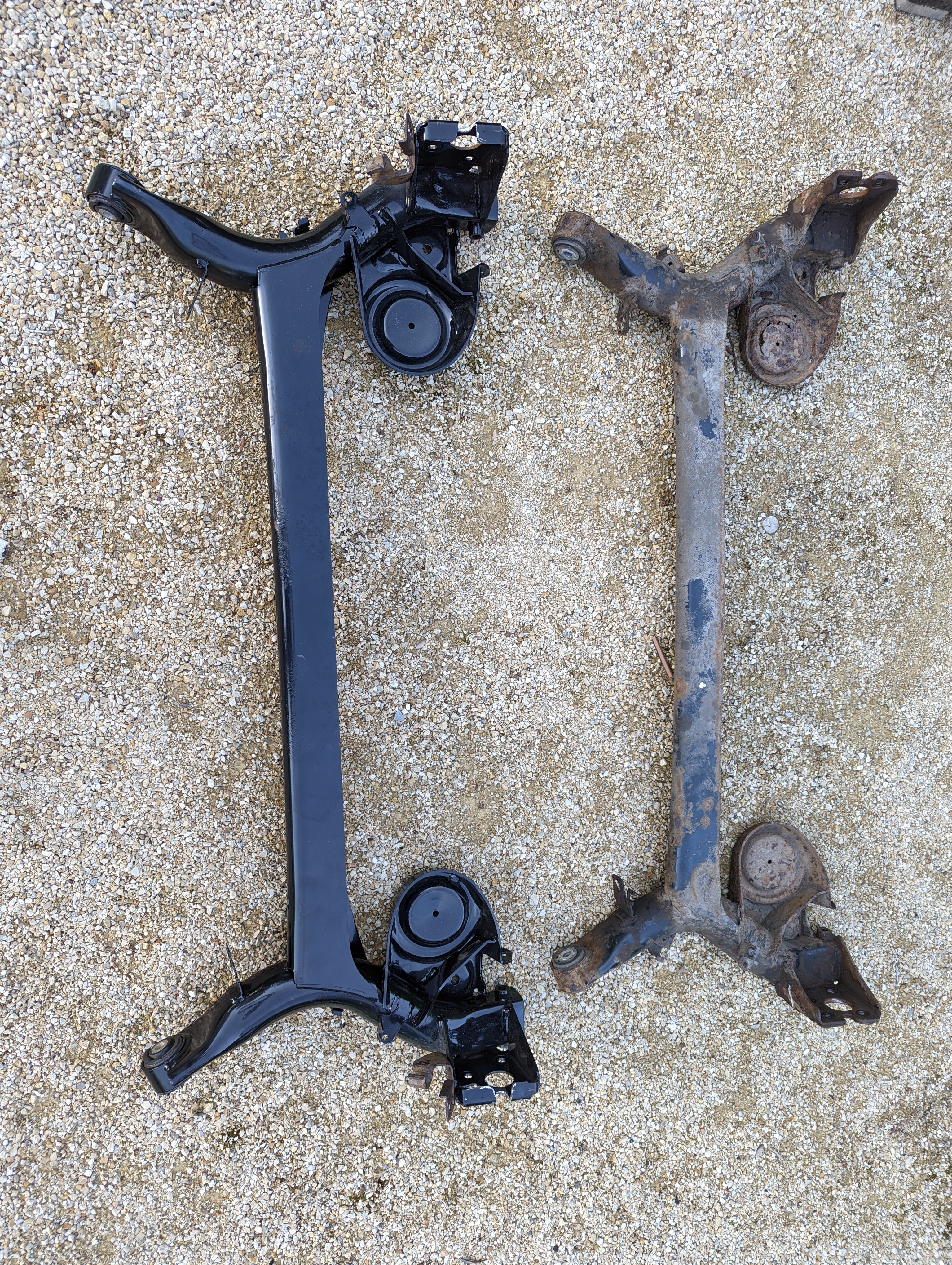

So decided to replace the rotten rear axle on my 100hp
The old was was really rather shoddy and a new axle is about to be adapted and fitted.
I'll post pics on progress and changes made!

A few frame pics comparing old and new.. differences seem to be
ABS wire routing ( cutout in new axle completed)
Additional Bracket for rear caliper handbrake cable and pipe/hose connection ( already moved to new axle )
Position of handbrake cable bracket ( further back on the replacement axle (trial fit needed)

Is that just an optical illusion in the photos, or is the new one wider than the old?

Hi.. it just an illusion.. I measured the width on both - very similar (2mm difference)
A squint at your wheel mounting flanges shows (despite the new having folded returns and old is flat) the corner relief hole is the same on new and old axles. The later wider axles have the same folded returns but those corners would look considerably different.
