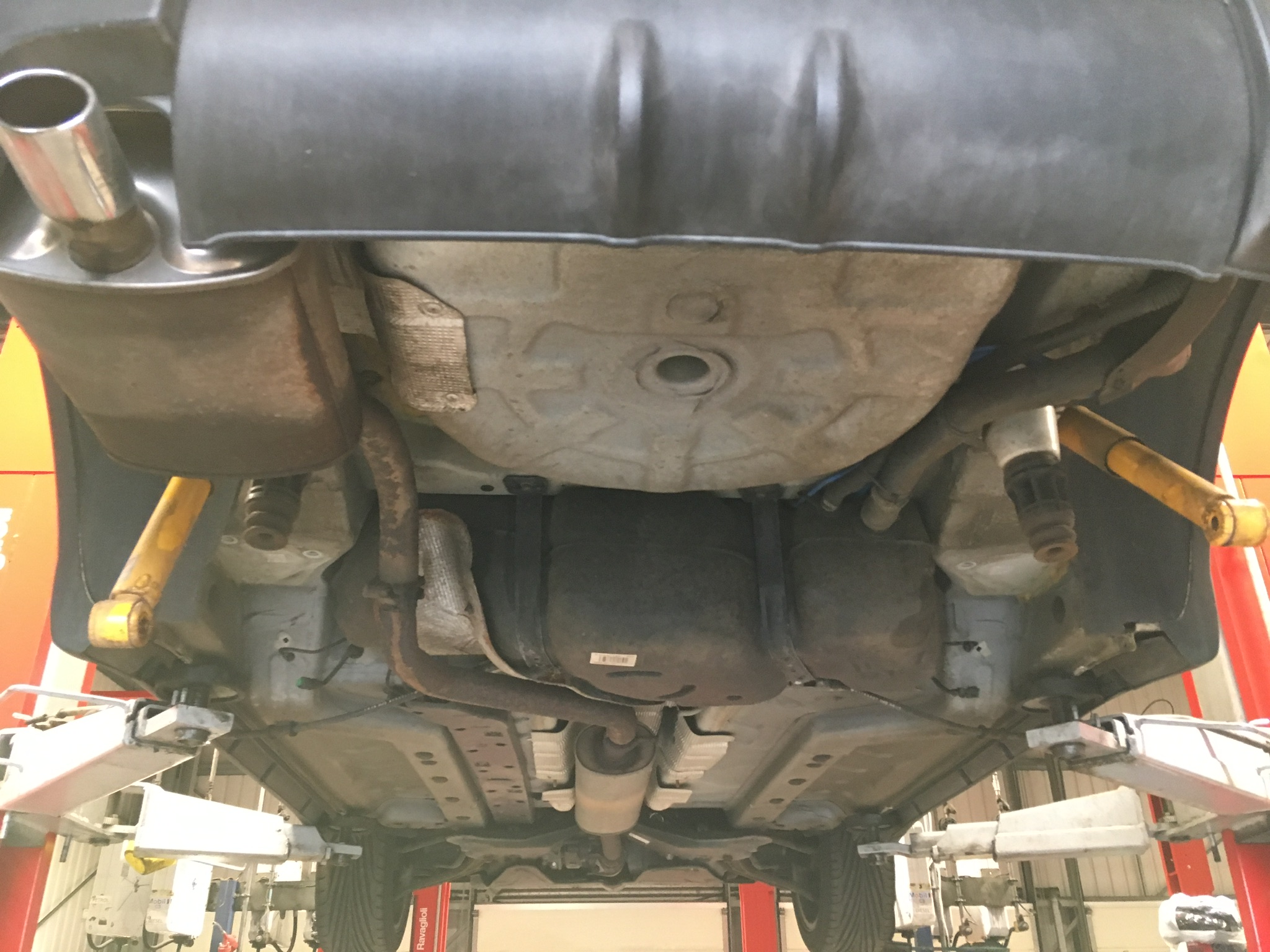

I was at my local garage picking up my everyday car & mentioned it to the mechanic.
He gave me an opertunity that I could not pass up.
Bring it in he said, we’ll remove the axel you get it refurbed, we’ll fit it back on.
They had a lift going spare for a week & it beats trying to do it on the drive.
So took the car to them last Friday, collected the axel Saturday morning.

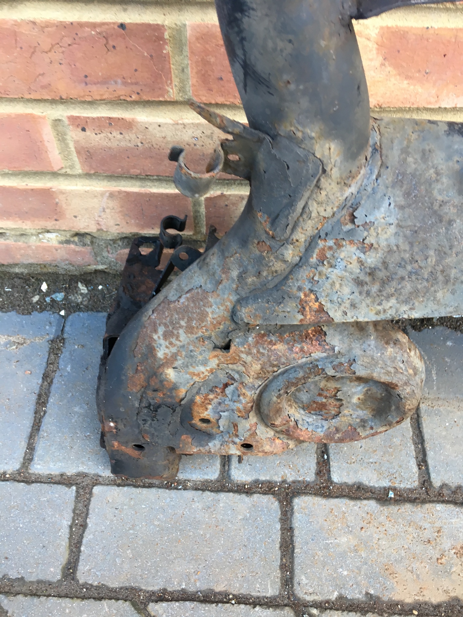

Spent the Saturday & Sunday stripping it down.
Only managed to shear one bolt on the disc shield.
But boy were the bolts tight! They were certainly not designed to be taken apart, all the nuts & bolts are assembled dry.
The brake pipes were a ****! Even having sprayed them with penetrant for a week every evening before it went to the garage.
All stripped down I took the axel to the grit blaster on Monday morning.

Whilst the axel was away, I removed the busted bolt from the hub & re-tapped the thread... that’s one evening gone.
I was going to strip down the hubs clean them up & paint them.
Unfortunately, the ABS sensors even though they were plastic were seized in solid.
Removing them would destroy them. Had a hunt on the web & found they were £60 each!
So in the end just gave everything a good clean up.

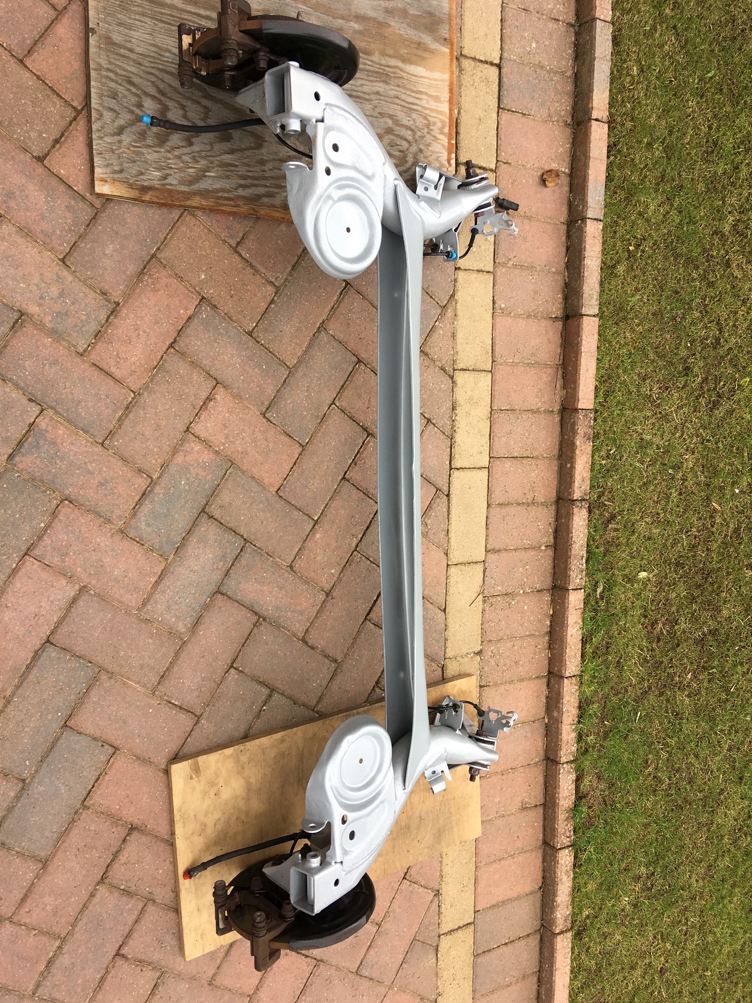

Friday, collected the axel & spent Friday evening & Saturday morning re-building the axel.

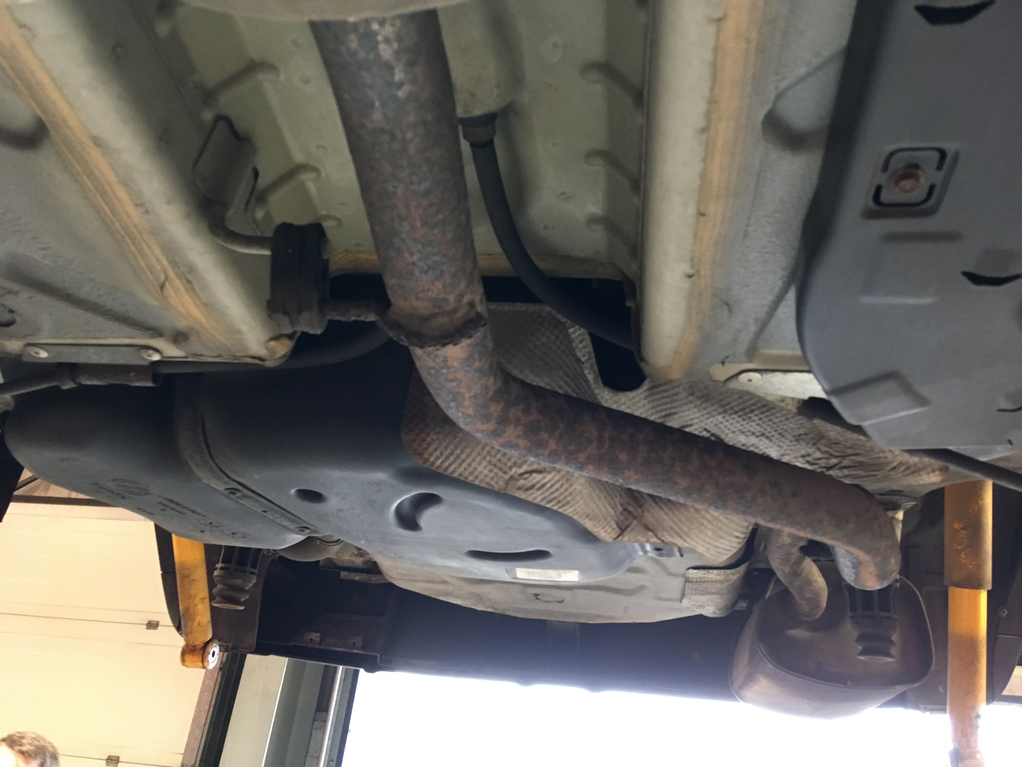

Having had a good look underneath, looks like the exhaust will be next.... job for next year.

Thanks. The grit blasting and repaint cost me £40, I was chuffed with that.
If you are going to do yours in the summer, I suggest you start squirting it every now & then with penetrant fluid.
Have a heat gun ready for the brake tubes.
On mine the disc cover bolts sheared off so I've just not replaced them though could have drilled them out and and used nuts on the back. The ABS sensors thankfully came out ok, but again the screws could be easily retapped with axle off the car.
I had the whole axle grit blasted and zinc metal sprayed total cost £80. I chose to etch prime and black Hammerite on top but that was really not needed. Ive had stuff powder coated over the years and only one supplier could really cope with old rusty parts. Jobs done by everyone else have rusted through after a couple of years. I reasoned another £40 to rust proof it for ever was money well spent.
The brake pipes are plastic coated so any corrosion (and there will always be some) will jam the flare nuts and prevent any penetrating oil from doing its work. The fix was to cut the rubber brake hose and spin the fragment off the flare nut. Then heat the flare nut with a gas cooker lighter to soften the plastic coating. You can then clean away the aluminium clag and treat the bare metal with anti seize paste.
The standard 100HP axle uses two rubber hoses and a length of steel pipe that's seized at both ends. I went to HEL and had a 600mm hose made up with banjo on one end and male to suit the car's flare nuts on the other. I attached it to the axle with P clips and M5 cap screws but it could have been done with zip ties. HEL fitted three rubbing bobbins for the purpose at no extra cost. I paid £25 per hose for up to 1m length. However reseller prices vary so call the HEL factory in Exeter.
I put a smear of antiseize on the male threads (NOT ON THE PIPE END) as they are dissimilar metals. I don't want another jammed on flare nut.

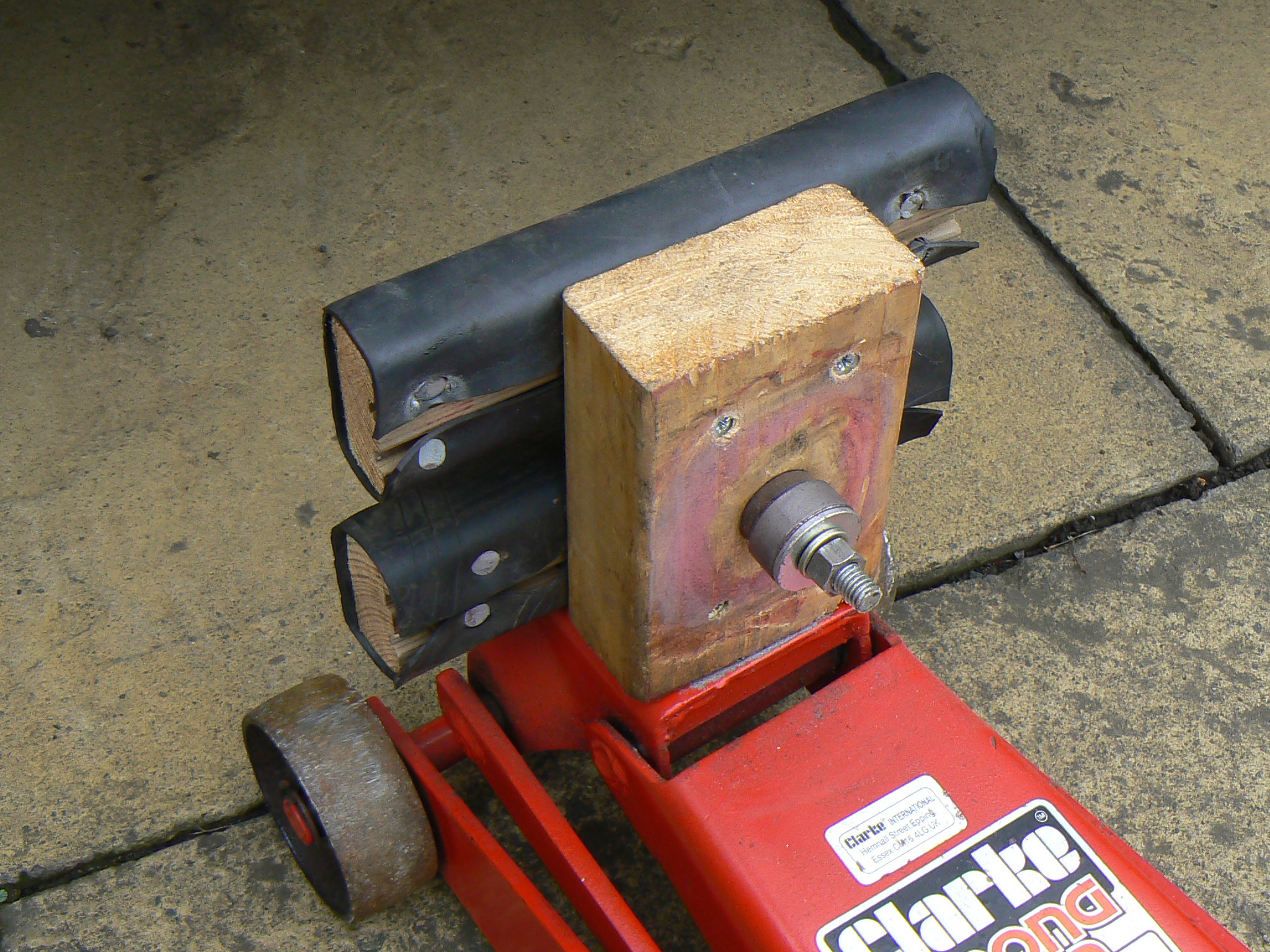

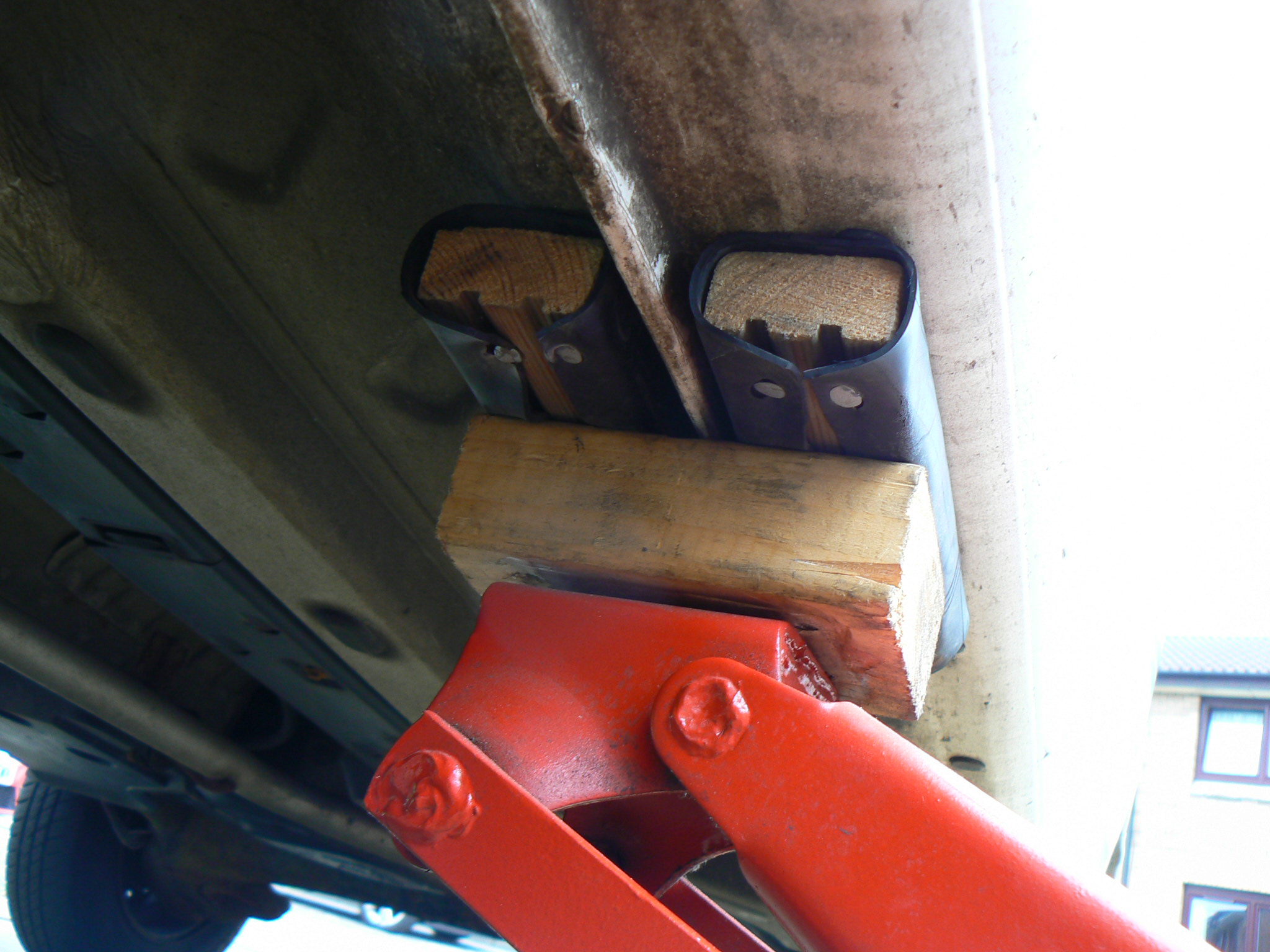

To jack the back just lift off the middle of the axle. Wooden protection (similar to Jock's sill pads) will make it easier. Get it as high as the jack allows then put stands under the sill jacking points with wooden pads.

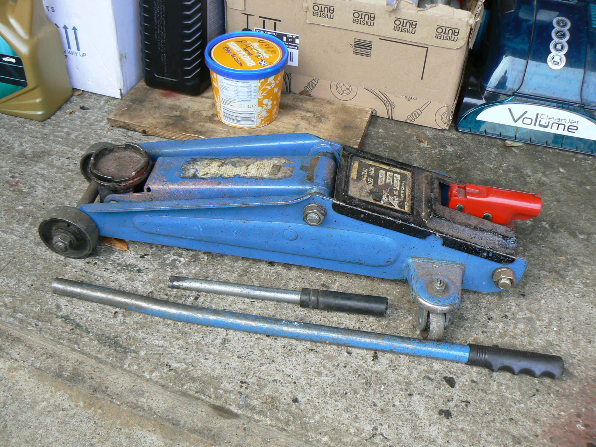

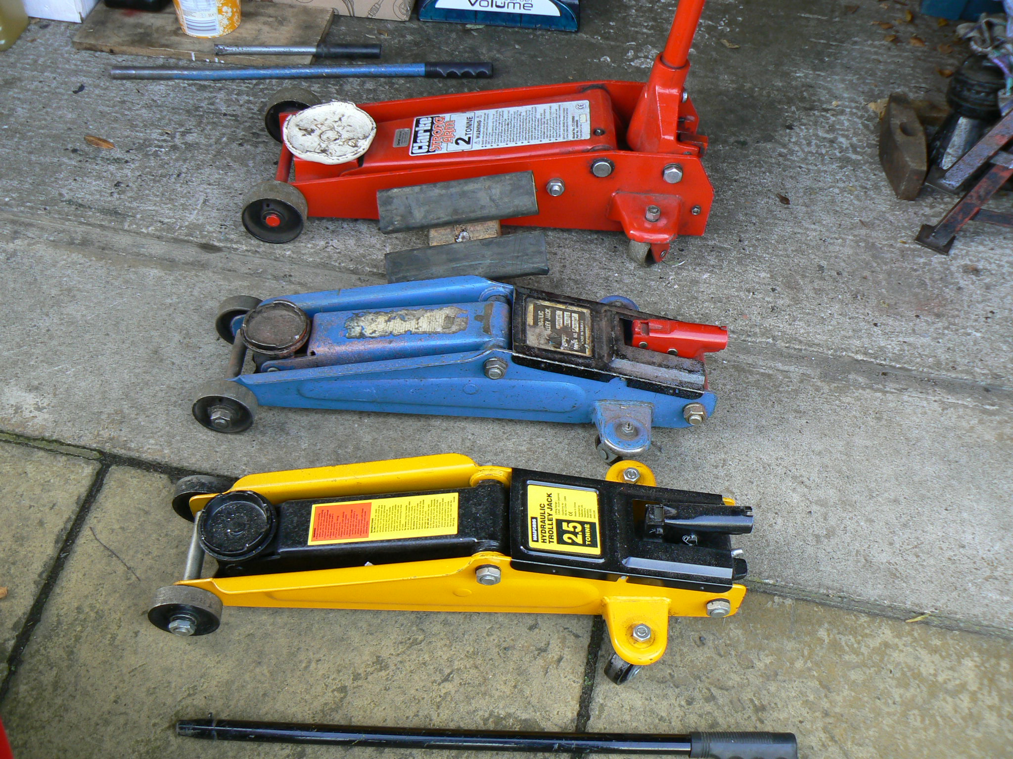

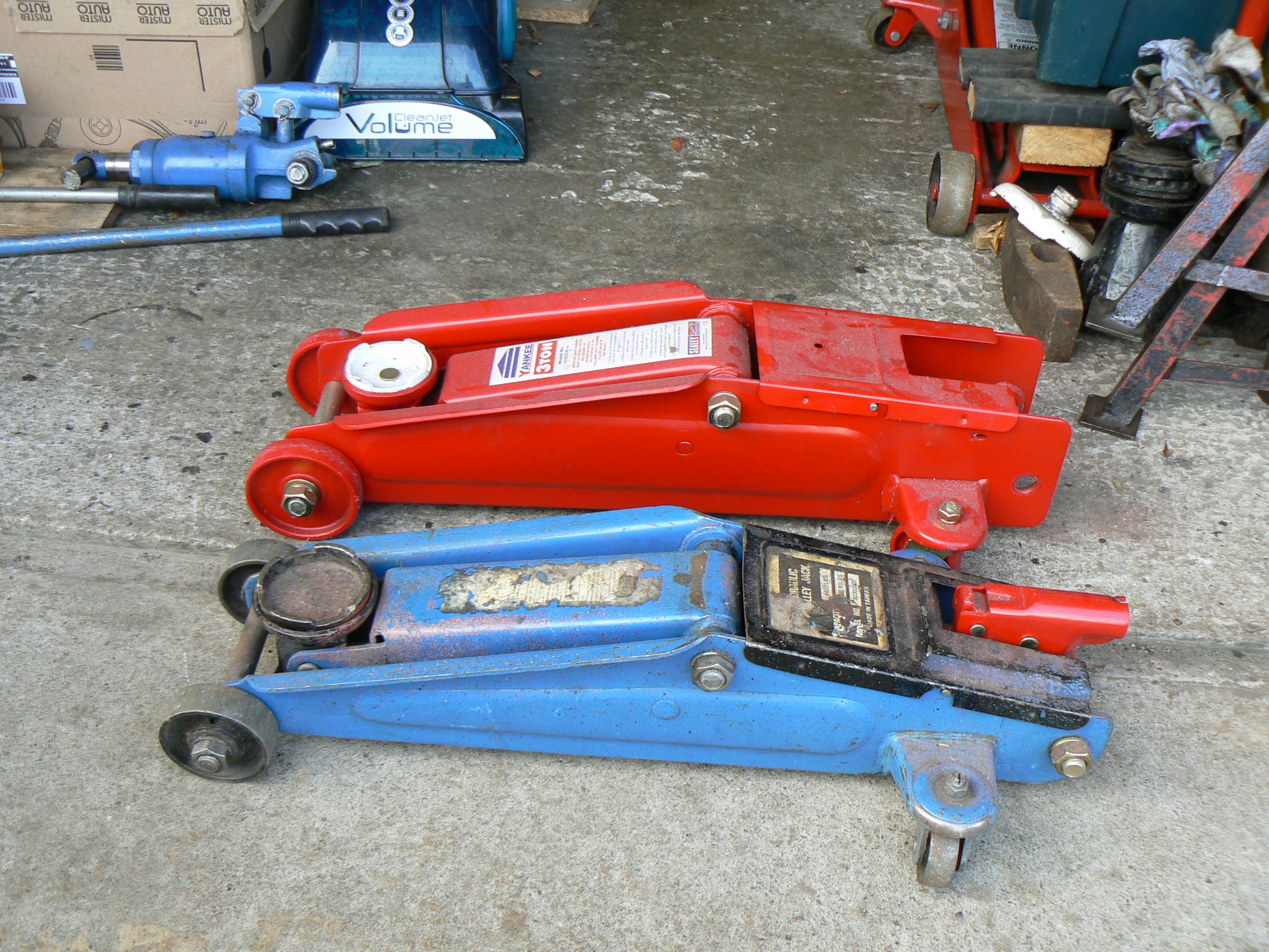

Trolley jacks and how many? Never enough is probably the answer! It was probably 45 years ago I bought this chap:
The chassis is roughly 2 ft long and he has a nice largish diameter saddle size. Maximum lift is 16 inches (410mm). It was Hilka branded but I've since discovered it's made in China, but thats OK it lasted well until several years ago when it started to come back down very very slowly. Still usable but maybe not to be relied on. So I treated myself to a "proper big jack":
He can lift to 19 inches (485 mm) - 21 Inches (535 mm) with the rubber jacking pad instead of the metal saddle. It's been a really great jack and nowadays is my first "go to". I still was using the smaller one for support jobs and if I had to rush off across town to "rescue" one of the family with a puncture or whatever. but it worried me that it wasn't "holding" properly.
Then I spotted an almost identical modern version of him on my local Gumtree. It's the one behind That is to say, the red one:

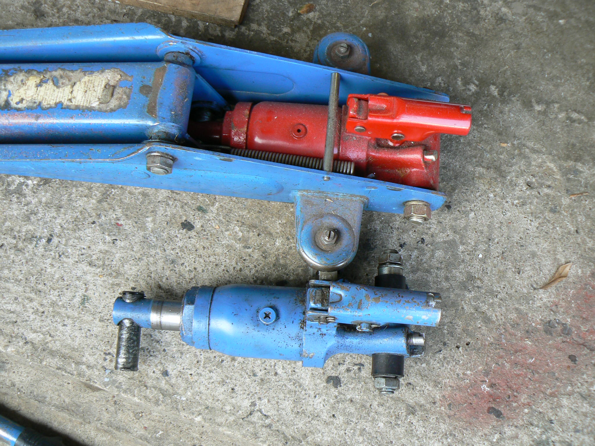

You'll notice it's got "bits" missing. This is because it didn't take long to find fault with it. It's slightly, but significantly, higher and more bulky. But worst of all it's got quite a small saddle - more obvious if you enlarge the image - I was beginning to regret buying it (although, on Gumtree I only paid about half price for it) When I noticed the ram assembly looked very similar. Measured it all up and to all intents and purposes it's identical. Only red, ha ha! Bet it's the same factory still churning out these hydraulic parts. Anyway I switched over the hydraulic unit as a whole and my "old friend" was back in business.
P1080321.JPG.

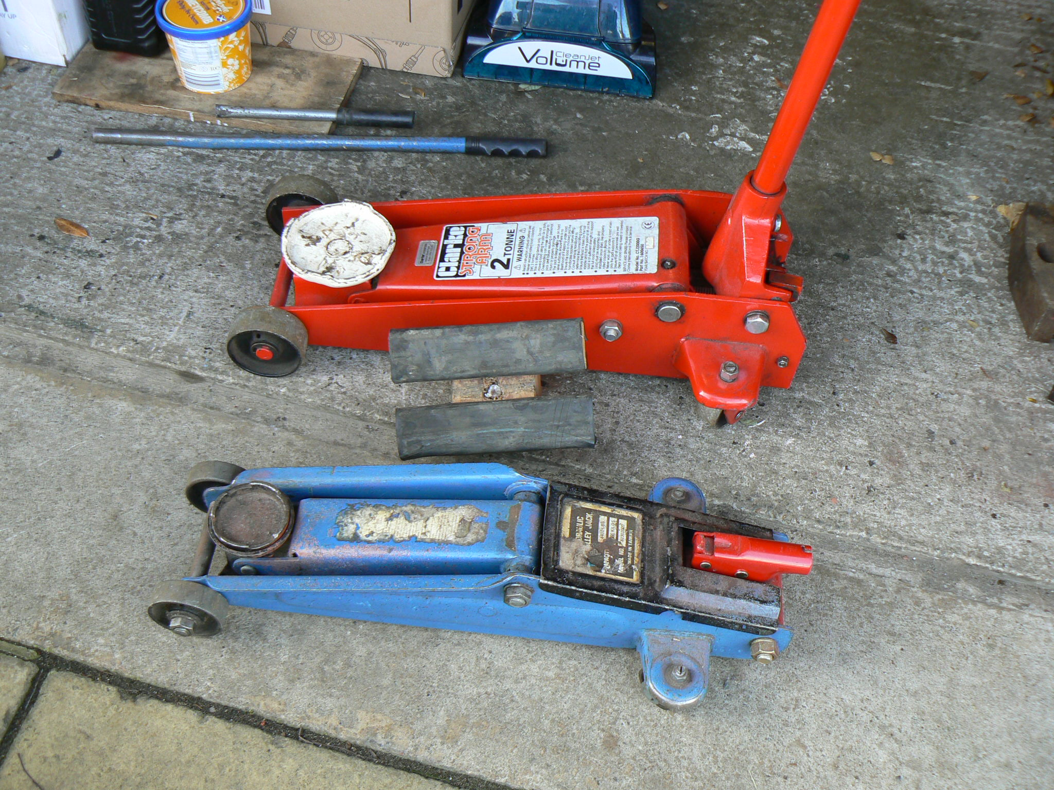

Then, amazingly, about a month later, a chap who lives at the end of our street who I'm on "nodding" terms with, but don't "know", knocked on my door one night and said "I often see you working on your cars, would you like a jack" Not one to ever look gift horse in the mouth I said yes. Probably not going to be much use to me but I can always sell it on Gumtree or just get a couple of quid down at the scrappy. He turned up next day with this - the yellow and black one nearest the camera:
It's so near to being identical to my old Hilka that it must have been built in the same factory. A lot of the pins are welded in place whereas the old Hilka could come apart with circlips etc. It's like it came out the box yesterday! I felt so guilty I actually offered him money for it but he refused. He told me he'd bought it a few years ago for swapping round winter and summer tyres but the winter tyres had worn out quickly so he wasn't going to buy another set and had no more need for the jack.
So now I have 3 jacks and an almost new chassis sans hydraulics (don't know what to do with the chassis but it's got some nice thick plate and sturdy axles etc. Probably I'll cut it up to make brackets or something and maybe make punches out of the axles and pins? I hesitate to mention it, but I've also got a low entry 2 tonner - but I don't talk about that one in case Mrs Jock finds out I bought another jack!
View attachment 198807.
