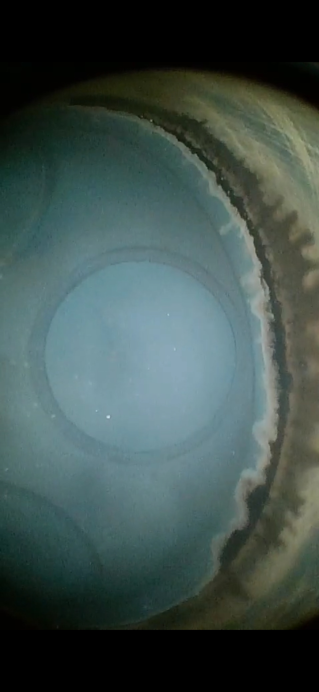

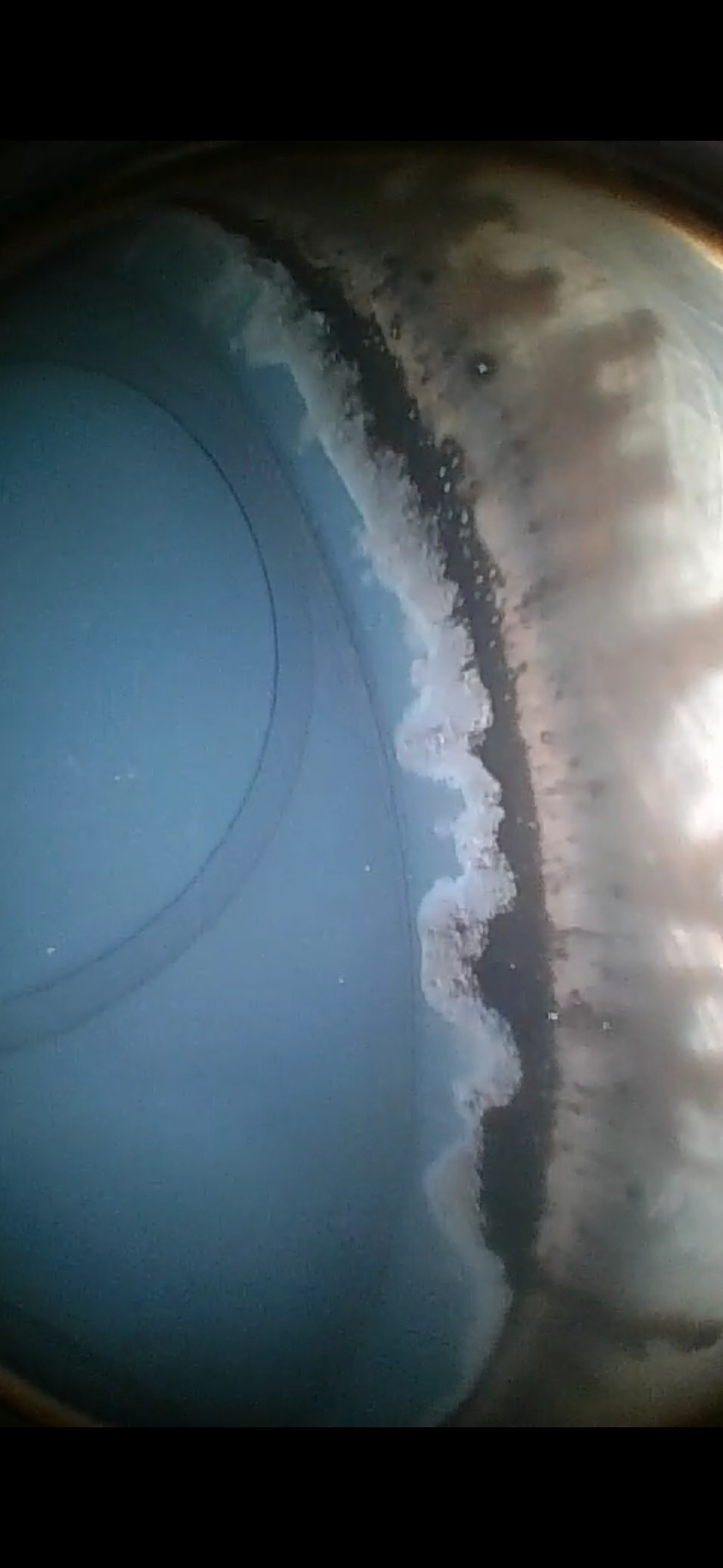

In addition, I performed an endoscopic inspection of the cylinders and valves. The cylinder hone is good, there is a small carbon deposit, but the valves do not shine at the point of contact, and are also covered in carbon deposits. I also have a video, I will send it to the person who understands and can help.Please share your opinion on this matter. Thank's!

Mike,
Look this cylinder and engine head border surface at photos. What do you think? Can it be coolant leak/bad gasket and reason for excess smoke? Or even oil from Channel?
Can it be damaged engine head?

Mike,
Sorry not quite sure the direction I am looking at, I can see the boring/honing marks on the cylinder which don't look very smooth to me.
Am I looking up at the cylinder head via a valve or injector hole, in which case something is leaking from the head gasket area, which doesn't look like a clean defined edge of a gasket?
So are you losing coolant or oil?
Obviously hard to be sure but if poor job on liners/cylinder sleeves it could be head gasket not sealing around cylinders.
When you had the leak test done, with pressure in the combustion chamber, if the head gasket wasn't sealing correctly I would have expected the coolant to start to rise in the expansion tank if you had the cap off, as the air pressure escaping from the combustion chamber in to the cooling system would displace the water causing the level to rise or overflow. I have seen that many times when checking for a suspect head gasket.
There is certainly some strange colouring around the edge of the cylinder.
Yest, that is up the cylinder - head, valves etc. It's aviators photo from the inside of engine. So, coolant blow out check is the fastest way to see if something is wrong? Something like this kit https://www.cosda.com.tw/combustion-gas-leak-tester-kit-sd-1025.html
That is one test, what we used to call a "sniffer test" where the crystals change colour if combustion gas is detected in the coolant reservoir.
Sometimes it is possible to simply rev the engine with the lid off for 30 seconds or so, then let it idle and you may see bubbles rise, if safe to do so you may smell exhaust gas in the bubbles. My way costs nothing;)
However the test I meant involves checking each individual cylinder by locking the engine when on the firing stroke so inlet and exhaust valves are shut and piston at TDC on the cylinder to be tested and then air pressure from a garage compressor ( I use 150psi /10 Bar) is connected to that cylinder via heater plug or injector adaptor, if a petrol engine then via spark plug adaptor.
While this is connected it is then possible if head gasket is leaking to see the water level rise in the expansion tank if lid/cap off and filled to brim start to overflow.
You can also see if pistons are worn/not sealing as pressure will be escaping via oil filler cap or engine breather.
You can also see if inlet valves are not sealing by air escaping from induction side/air filter etc.
You can also see if exhaust valves are leaking by listeing at the exhaust tail pipe for pressure escaping.
It is an excellent test but takes a long time to check every cylinder, but is conclusive.
It is an expensive bit of kit to buy and has the gauge to measure % of loss , however if you have access to a good compressor and can make suitable adaptors and a bit of hose, then that works quite well:)
In your case what I suspect is a poor job was made of the cylinder liners and maybe the cylinder block wasn't skimmed flat afterwards so a poor seal was allowed at the head gasket area. I would have also had the cylinder head machined flat also.
