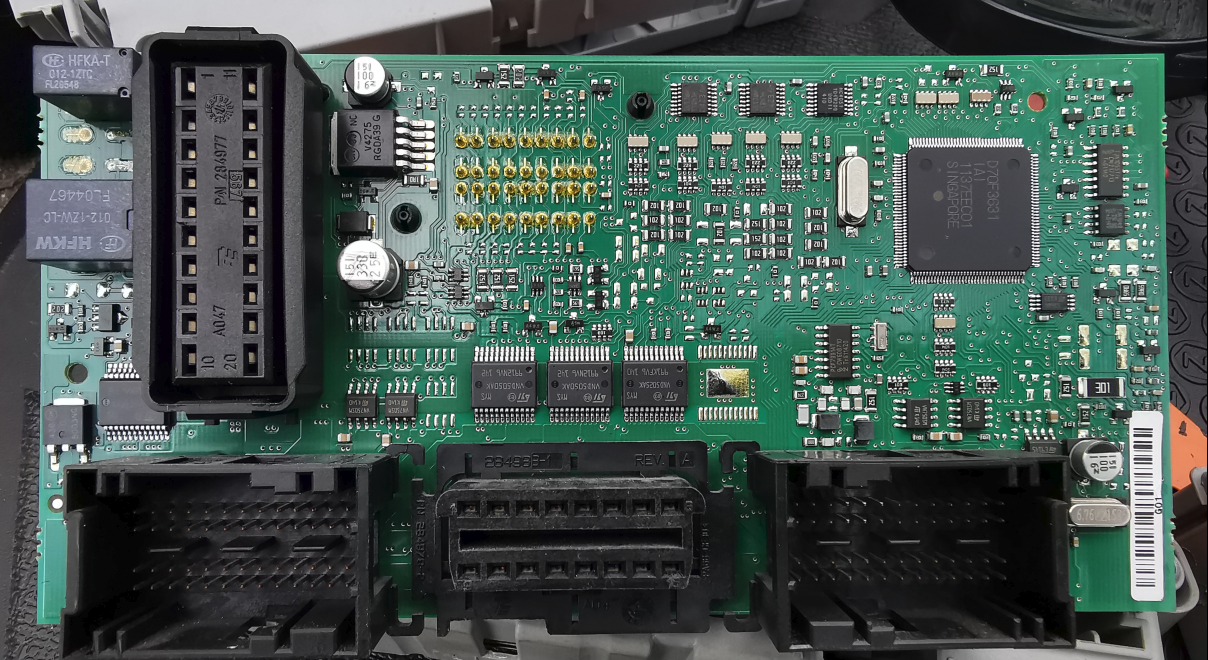

Nowaday cars are computers on wheels :)
FYI, that's how a 2006 Ducato model BCM (Body Control Module) looks like on the inside:
It's what inside the cab fusebox :D And that's only the BCM, there are like 5 or 6 other modules like that in a 20 years old car. Engine, dash, airbag, ABS, etc. The cars from the 2020's have even more of them ;)
