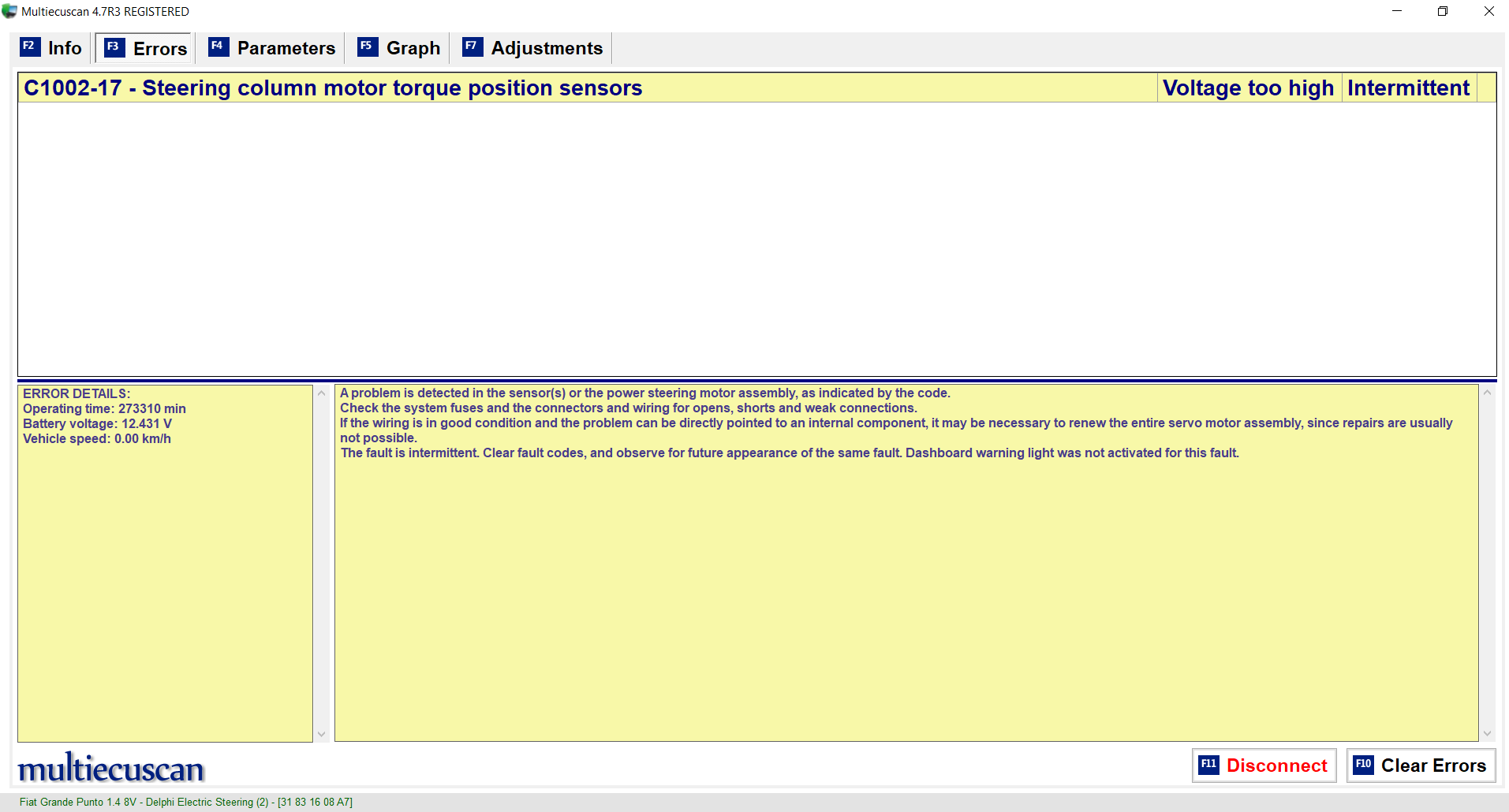

Today I finally had a moment to connect MES and there is an error C1002-17:
Is this really be caused by battery being too small?? I was not able to find any information in service book regarding spec for battery replacement. Most of the on-line stores recommends 55 Ah / 500 Amps for this car tho.
Obviously I will follow MES hints and check wiring/fuses/weak connections hopefully this weekend.
What is actual recommended battery spec for this model?
Well if not battery or wiring then torque position sensor will need replacing ?
I know power steering is an common issue with this car but I hope maybe someone here had in the past exactly the same error and could say some more.
