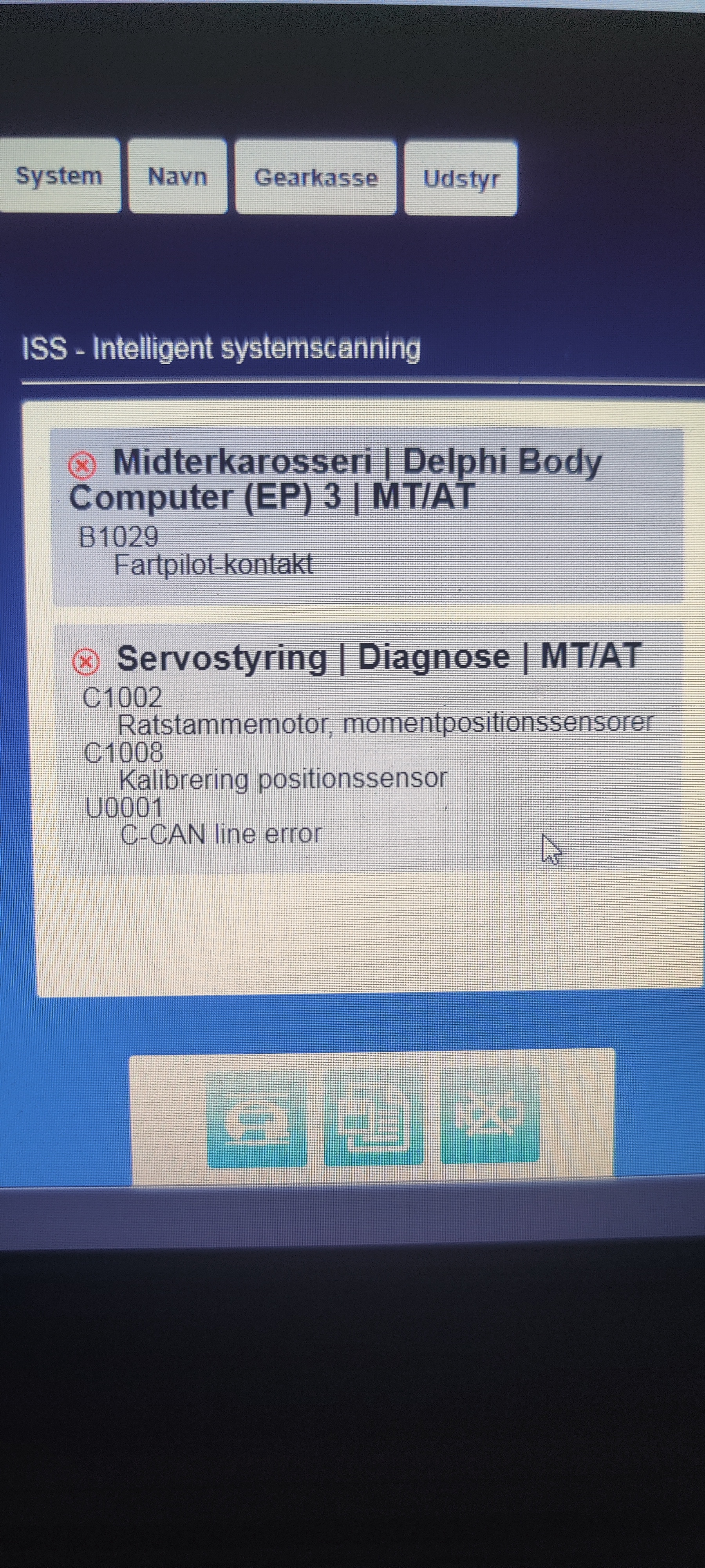

Have you checked your battery?had ma dads scanner on and tried to figure out how to work it.
getting these codes atm
also showed C0051 earlier
Have you tried to calibrate the sensor?had ma dads scanner on and tried to figure out how to work it.

Mine was not a esp was a eps (steering module) your code seems to be a faulty steering angle sensor comon on these cars , check all the earths (specialy the main earth that goes to chassi leg and gearbox if not at least gives a good check upmine is still having issues
