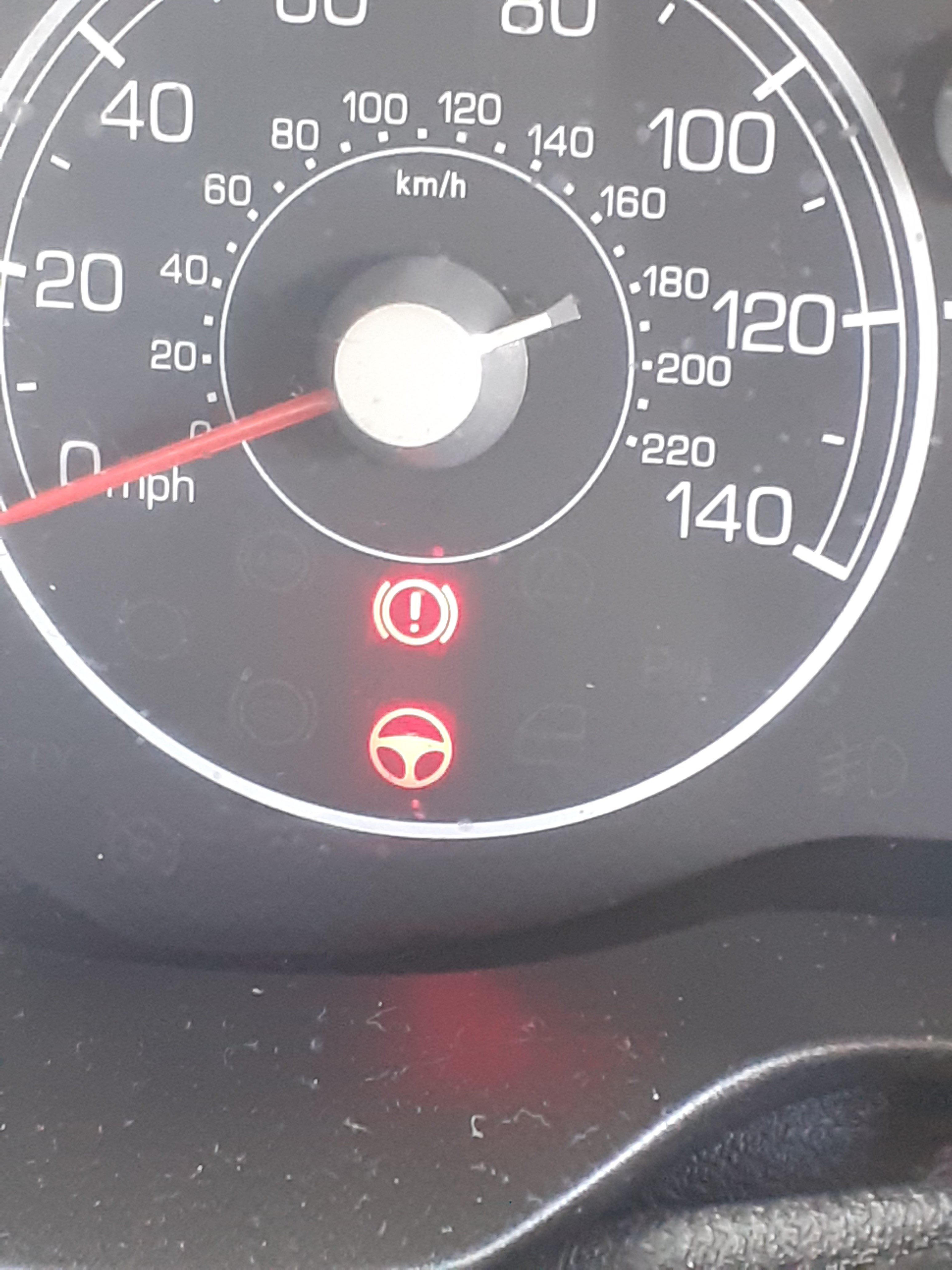

Car was running OK went over speed bump funny because silly bloody road works now steering light on in car iv looked all under car nothing seems broken all looks OK iv been told to check power steering fuse but have no idea where they are can someone help please tell me where they are and if not the fuses what I should look at next thanks

Google?
Multiple threads exist already (plus YouTube videos and so on). Common problem.
Typically it's power/charging/starting related. Alternator, battery, main cables (especially ground/earth). Fuses/relays, maybe (rarely).
Then you can attempt to diagnose/fix the EPS itself (sensor, wiring in the steering wheel etc.).
Also, obviously, check the fault codes in the EPS module. OBD2 + Fiat specific software (like FES or MES, AlfaOBD).
The car seems to run fine and steering seem OK but light on dash thanks for reply when I have time I will check out wires
Hopefully fixed it I switched ignition on and off 2 times then on 3rd turn of ignition turned the wheels 4 times to the right quickly and light gone off iv tested it on a short run and stayed off so hopefully reset it
