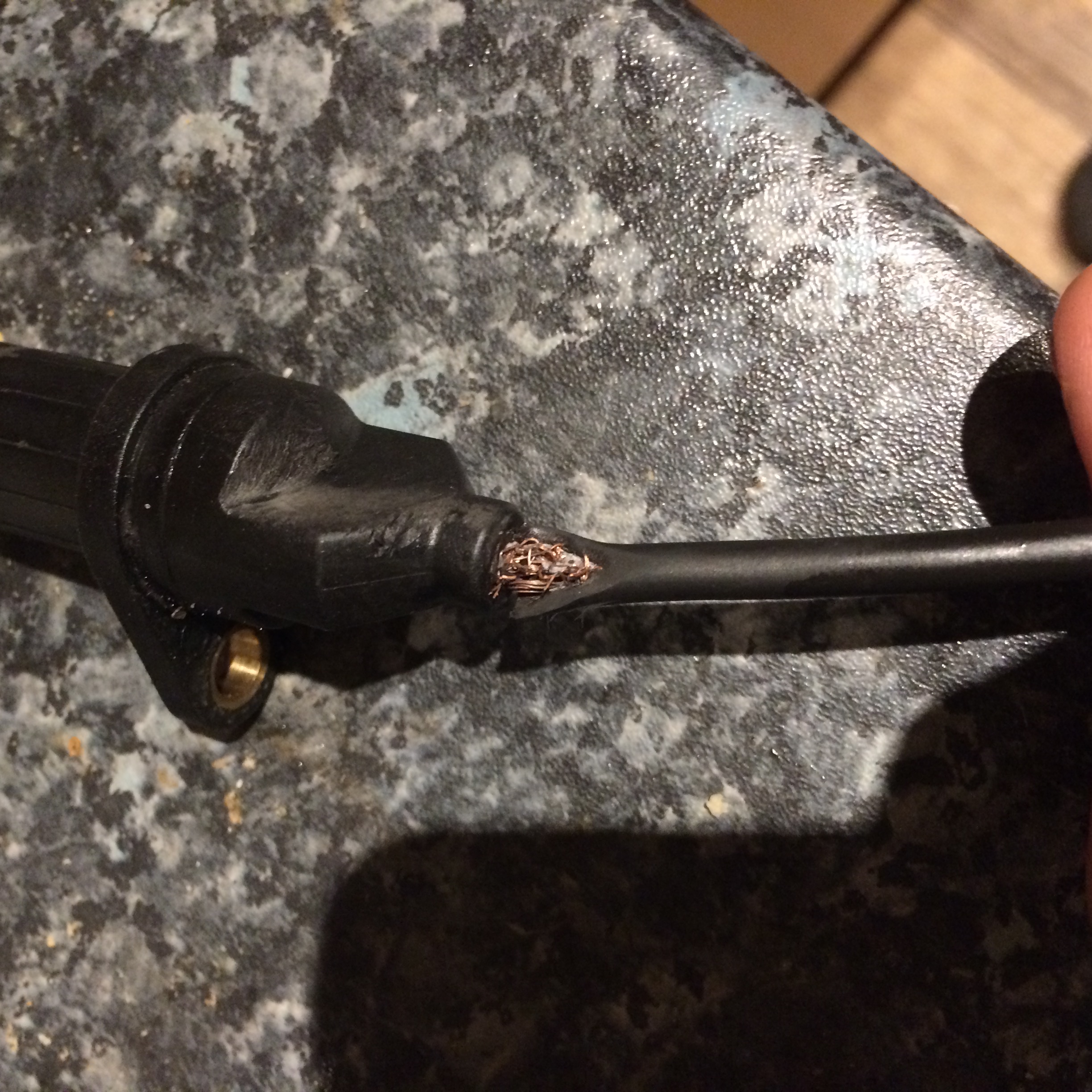

At first I thought it was the throttle body icing up because it was only doing it when it was cold. I think it might be the crank sensor because the wiring is a bit dodgy from where it's touching the fan housing, I've got another one on the way and I'm going to re route it round the back of the engine to try and stop it from happening anymore. If I doesn't turn up today, I'm going to pinch it off an old colleagues punto just to try it.
Well this was problem. Runs like a watch again.

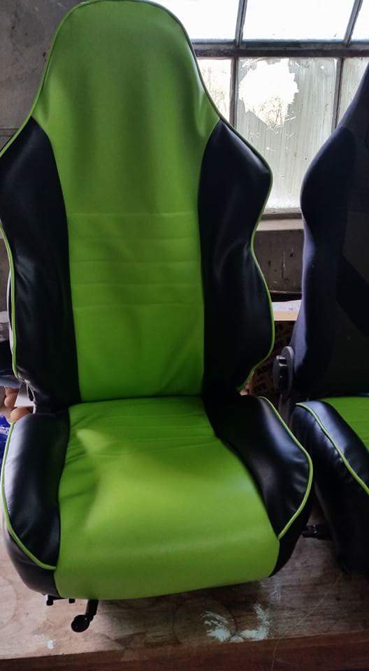

Well things have been a bit quiet recently, not much has happened to her. Pretty much the only things I've done is the oil and filter and sent the bucket seats off for re upholstering and here's what they look like before they're actually fitted to the seats.
