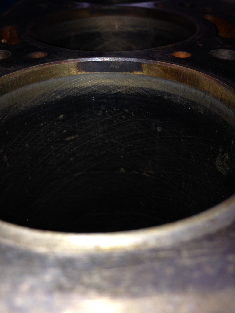

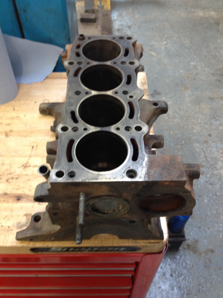

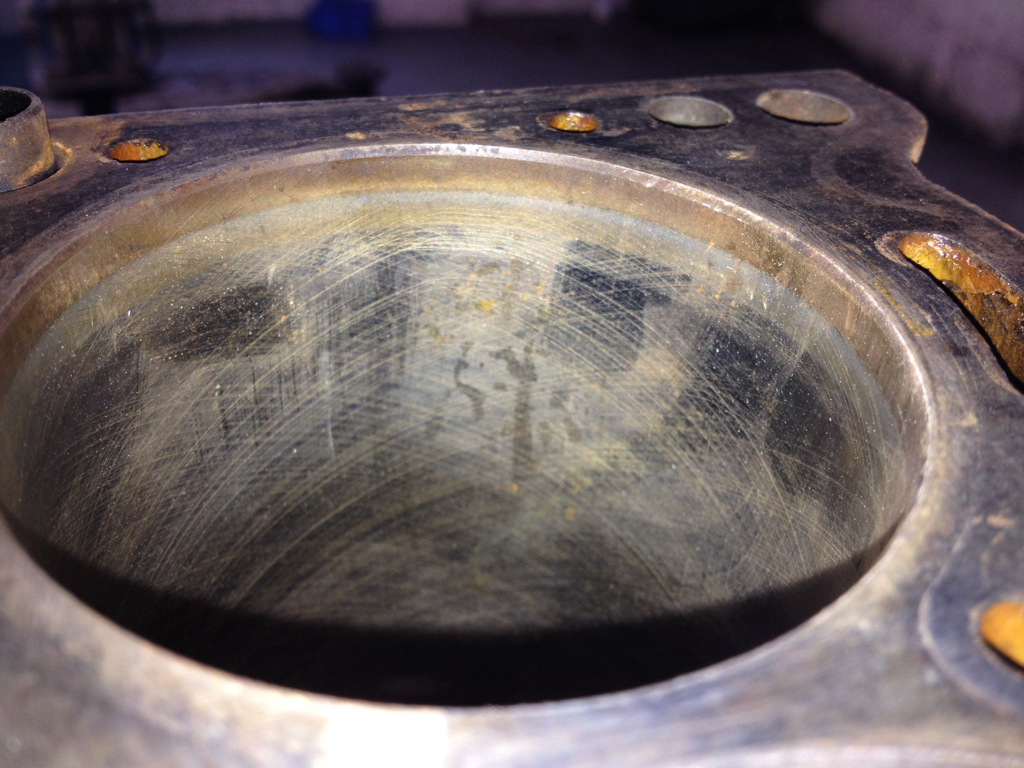

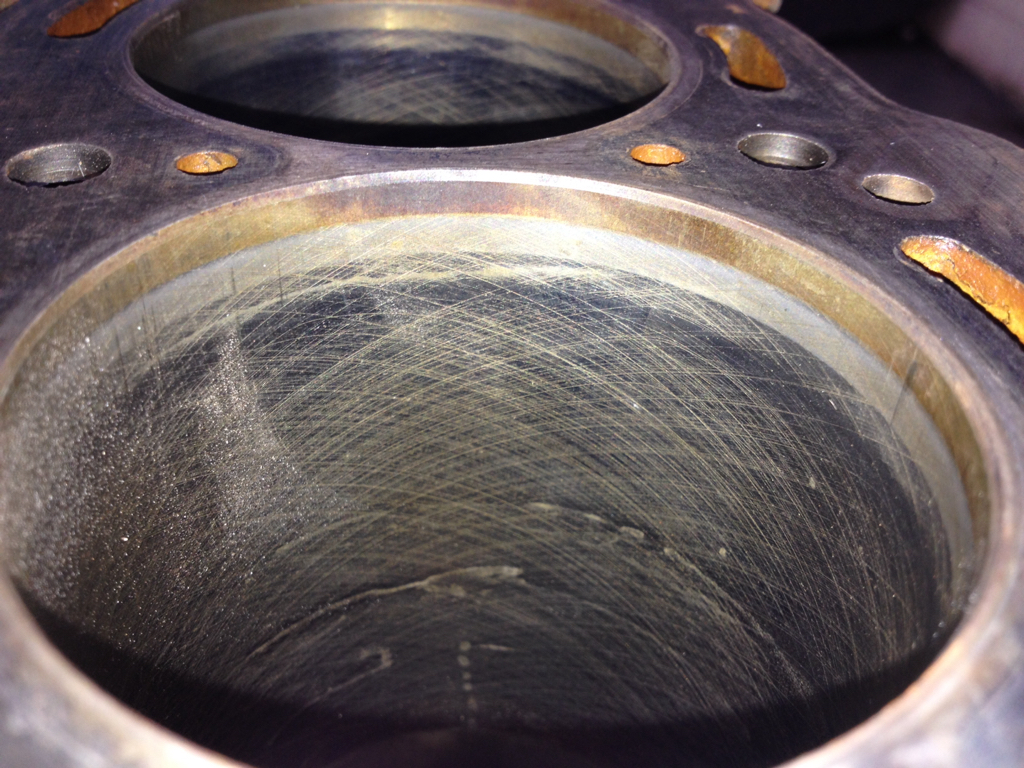

Finally got round to stripping the engine, apart from everything needing a clean and the possibility of the block needing a small skim all looks good, biggest problem was when removing the crank no1 piston hadn't dropped off the and got pulled out the wrong way.
No scoring on the crank so possibly a slight re grind not sure yet though. Everything I need to rebuild has been ordered (minus small ends due to being over £100 each).

On another note block did need a skim of 3thou, crank pulley broke so unable to balance the crank until that arrives.

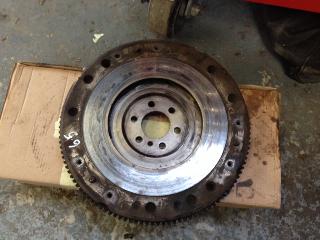

Been awhile since the last update, health issues have made some bits hard but MOT is due next month, should fly through (hopefully). Flywheel has been lightened and balanced should get everything back mid next week now. Still waiting on the C&B cam though starting to get frustrated.

Crank and bits and pieces will be back tomorrow along with a new honing tool.

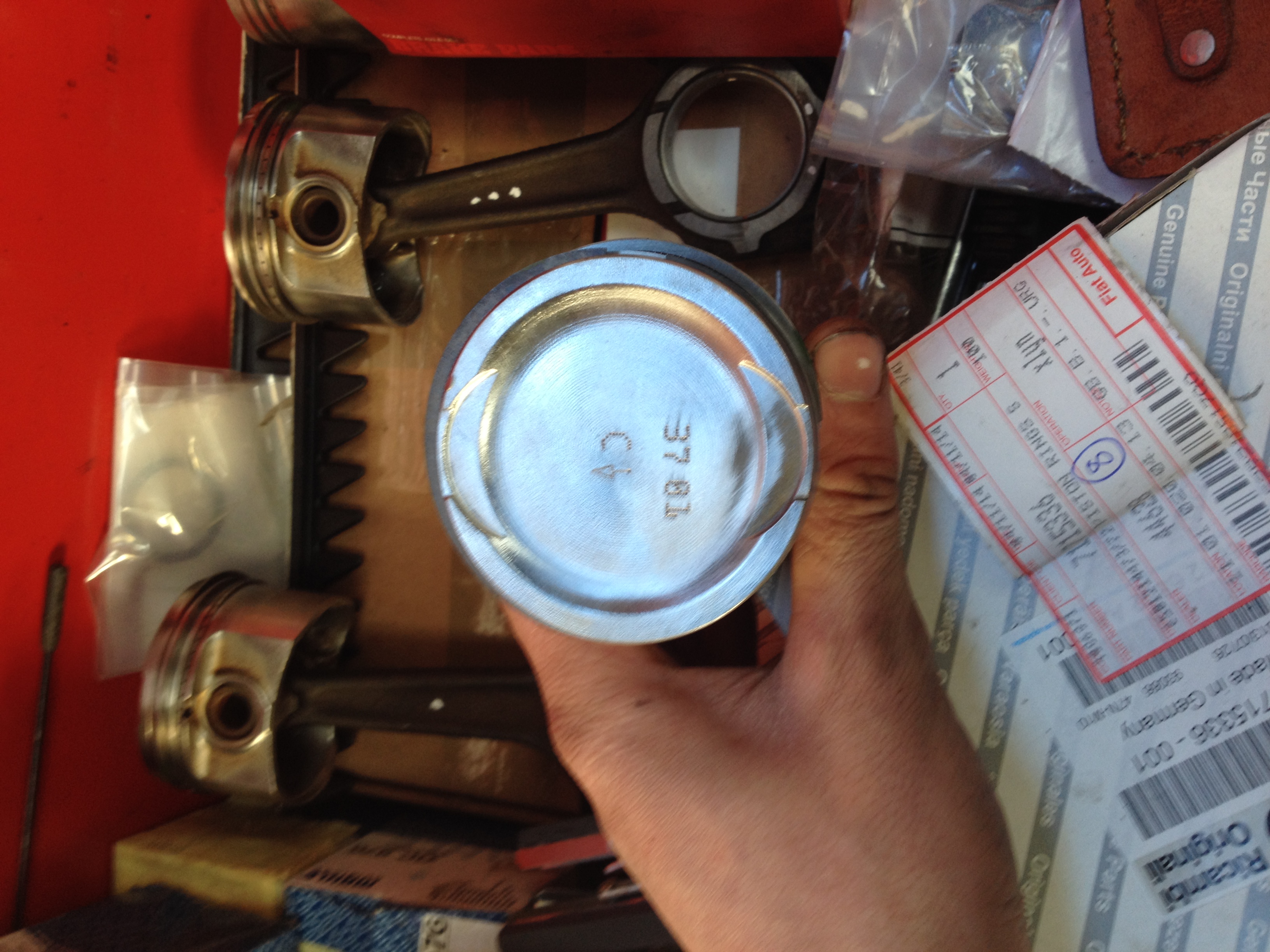

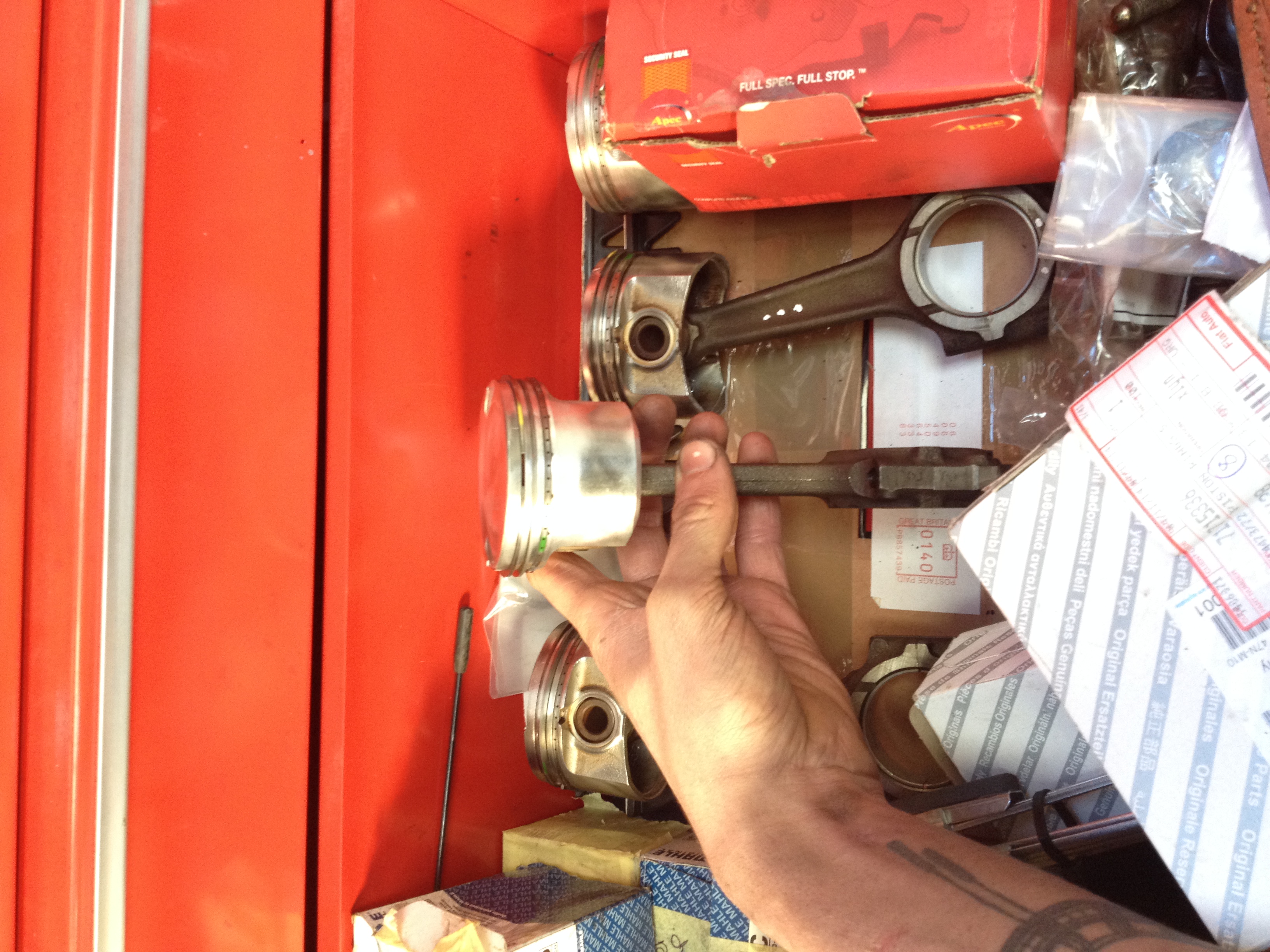

I gave the pistons a quick clean this afternoon to remove some of the staining on them and they look almost brand new from the top (sorry they're sideways can't be bothered to edit them).
