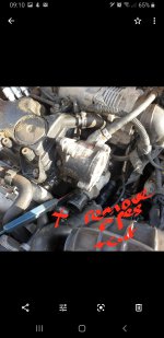

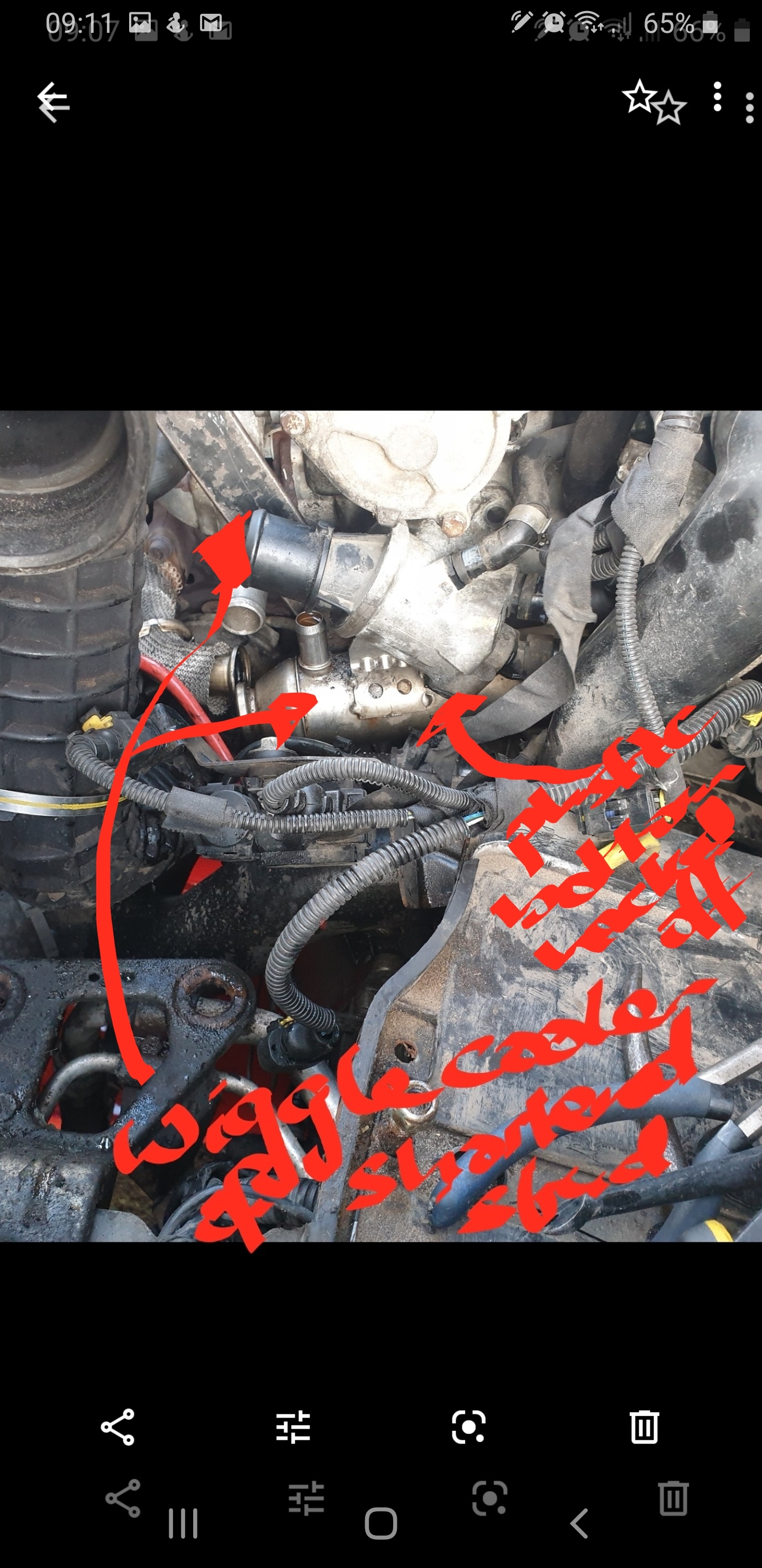

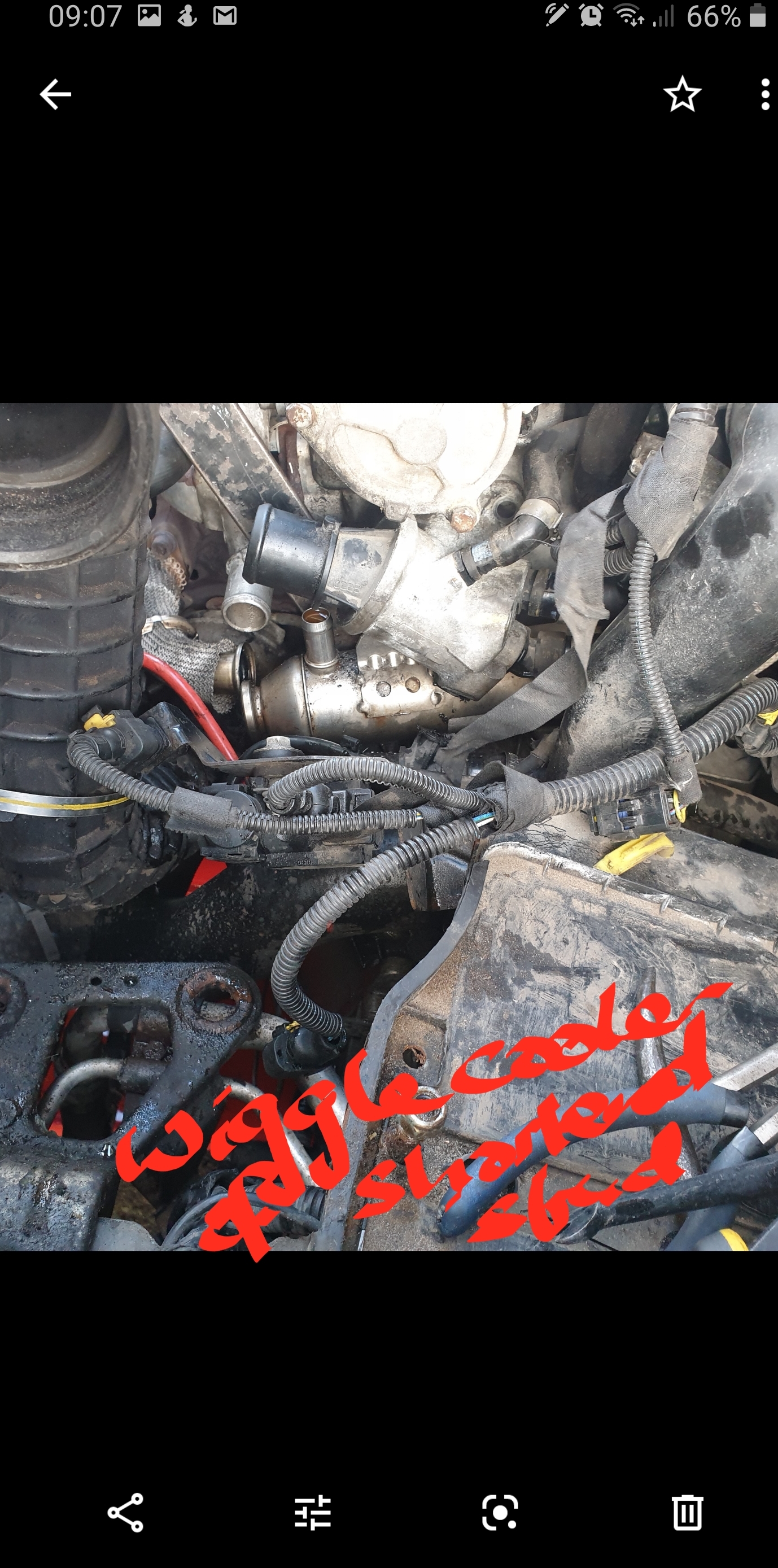

Building on this Marty. Did this job yesterday without reading up first ...
Got into problems with her cooler sharing the stud.
Found workaround
a. Loosen 2 6mm Allen bolts on egr valve but do not take off pipe
B. Cut 8mm or so off f...ing stud.
C. Get clamp of inlet to egr cooler
D. Hack plastic bit of bottom of thermostat where 2 pipes share connection. Makes room to wiggle cooler off and out of way enough.
See photos with comments attached.
Still a pig of a job. Lots of new hose clips.
