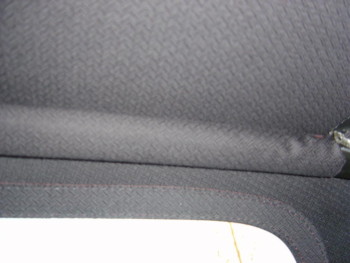

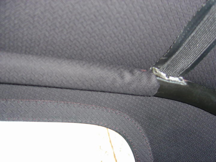

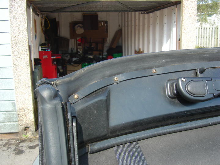

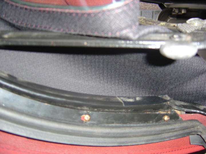

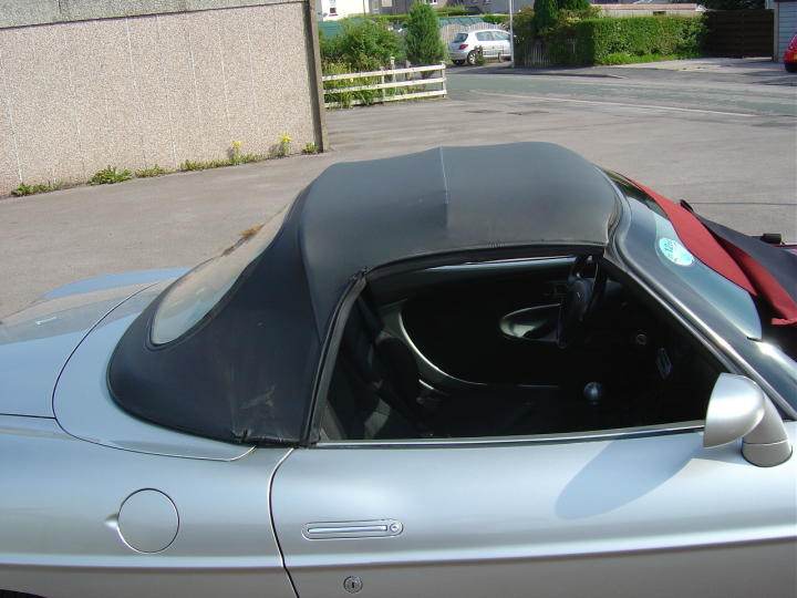

The first thing to do is remove the screws holding the window seals in place there are three seals on each side but the middle one remains attached to the frame the other two seals have one screw in each. The seal nearest the windscreen has a screw facing the interior of the car and is on the outer surface(pic1), the seal nearest the boot has a screw facing the exterior and is on the inner surface (pic2) To remove the seals they slide out of the frame the one closest to the windscreen slides forward the one nearest the boot slides downwards (see pic3) it is adviseable to lower the roof 2/3rds of the way on the lower seal for clearance of the rear wing panel.
