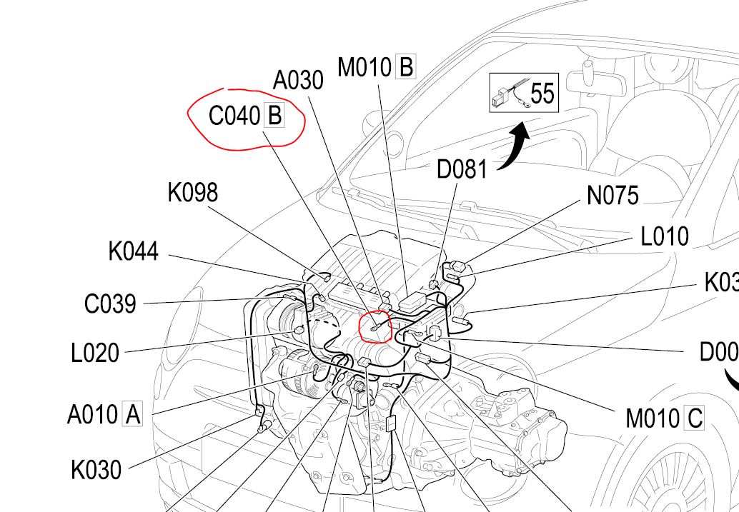

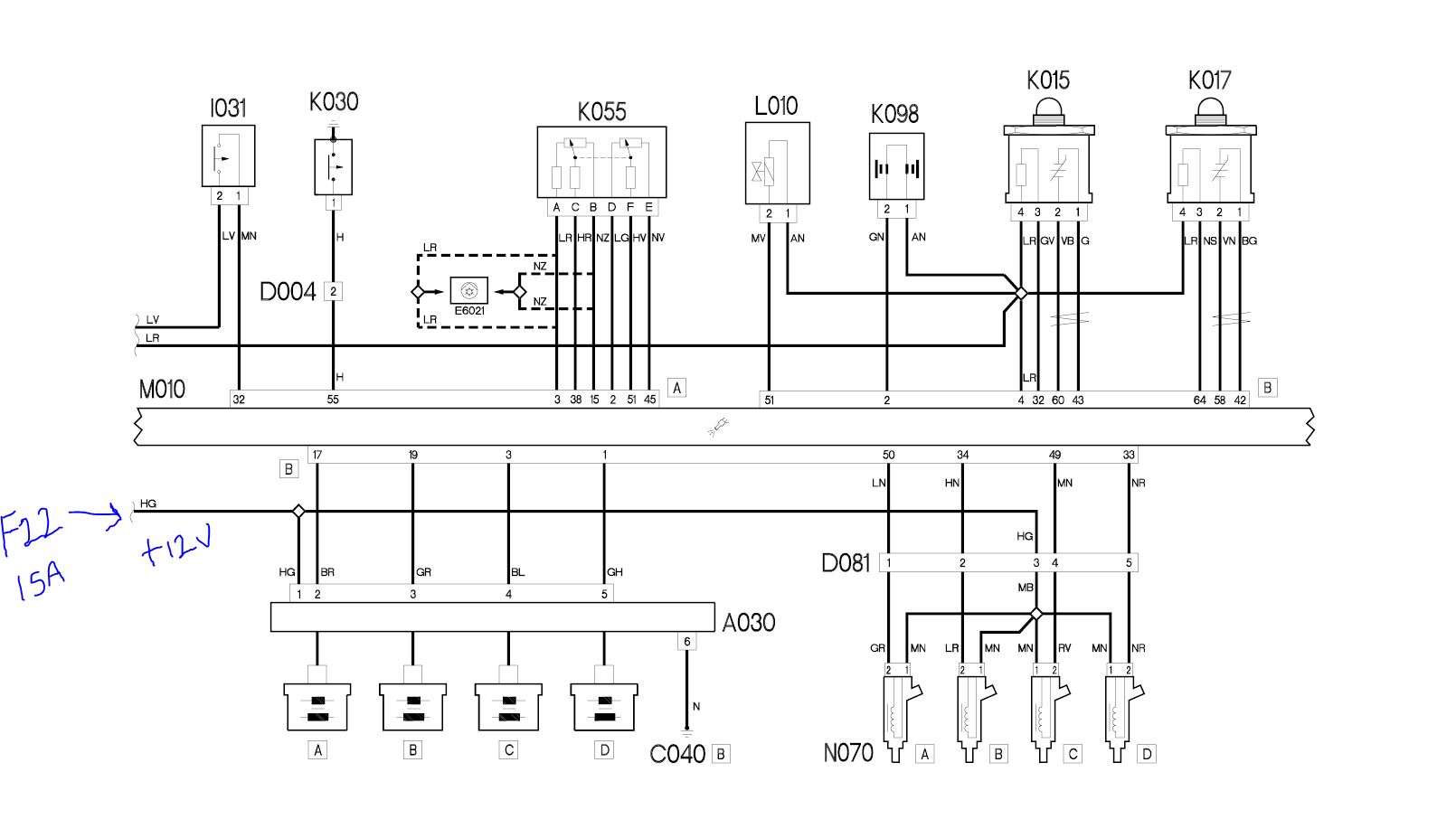

On the 1.2 all four HT coils are fed by the same +12V supply, so a failure of all four would suggest a power supply type issue. F22 feeds the pack.
Alternatively it could be a ground connection CO40B in the diagram..

Thanks everyone. The errors is coming from a device called an Engie which is attached to the diagnostics port just to the right of the steering wheel and it talks to an app on my iPhone. The code thats show is P0300 Random/Multiple Cylinder Misfire Detected. The car starts okay and drives without issue. its a 1.2lt petrol engine. I changed the ignition coil first then plugs followed by leads. However am still getting the error.
