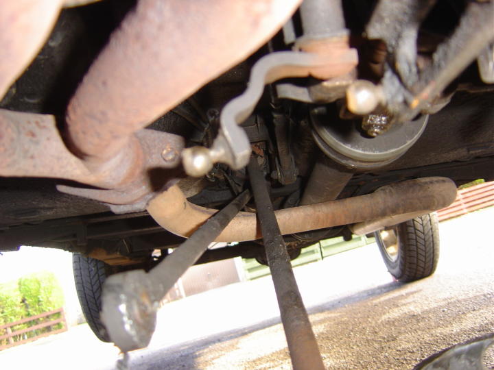

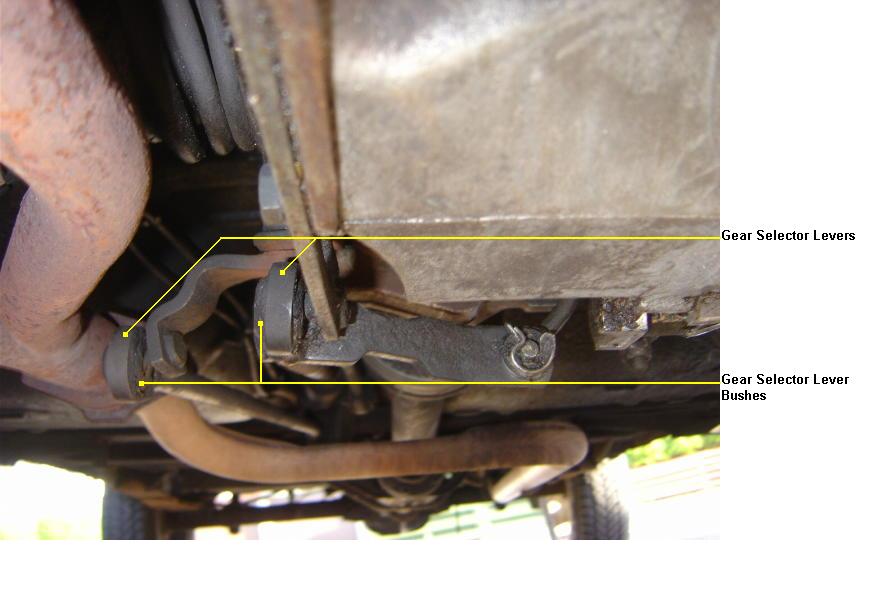

Locate the levers/bushes as shown (pic 2) also note the lever with split pin & washer to the right remove this first, then using a large screwdriver or other long flat bar lever the selector/bush away from the fixing (small metal ball) (pic 3) the more tired they are the easier they will come off.
