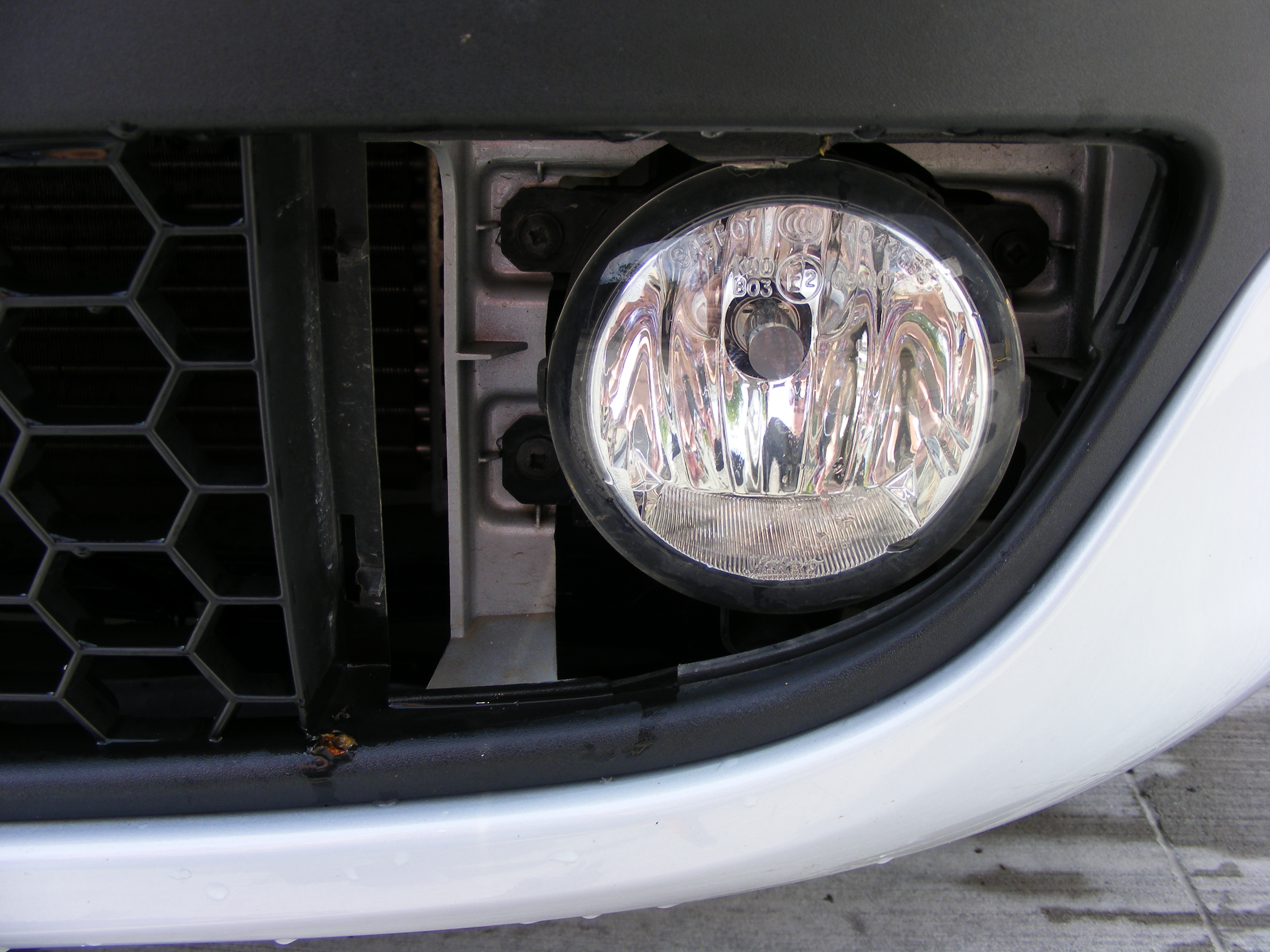

the Fogs in the EVO take H11 bulbs...
So without further a do get your screw driver out...
And remove the trim retaining screw....
now with that out pull it from the top downwards think of it as been hinged at the bottom (this way you dont break the bottom retaining clip off....)
Next look into the hole and remove carefully the 3x pozzi screws which hold the fog lamp unit to the bumper........ TAKE GREAT CARE NOT TO LOOSE THEM INTO THE BUMPER A MAGNETIC TIP SCREW DRIVER IS HANDY HERE,,,
Now with the lamp unit hanging by its wire support it and undo the bulb with a 1/4 turn anti clockwise
and lower the unit away and put somewhere safe...
next unclip the wire from the bulb module
and reassemble in the reverse order.. MAKING SURE YOU DON'T TOUCH THE GLASS ENVELOPE OF THE NEW BULB IF YOU DO CLEAN THE GLASS WITH ISOPROPOL ALCOHOL PANEL WIPE OR METHYLATED SPIRIT
