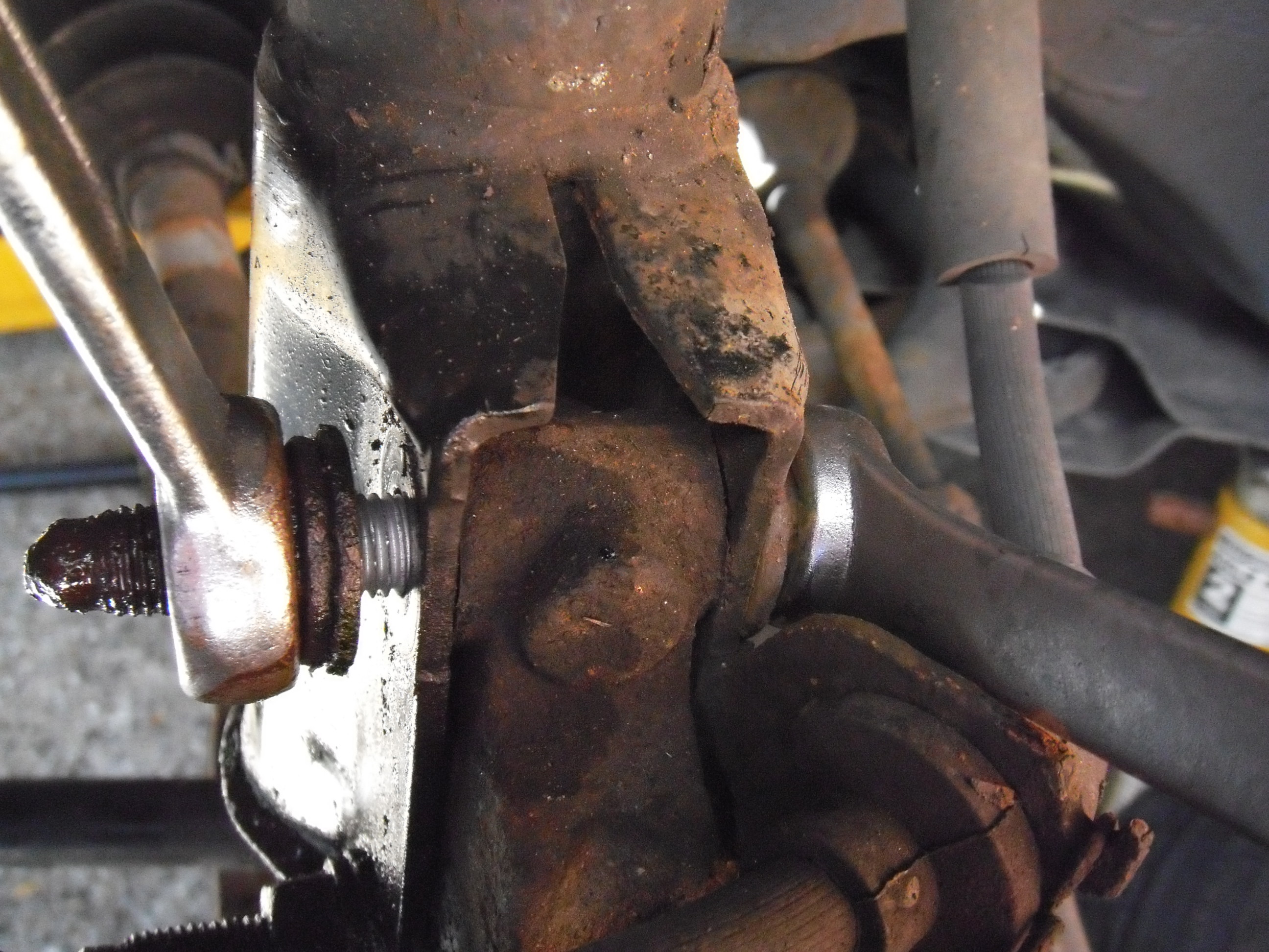

apply Plusgas / release agent to the threads of the droplink bolts AND the suspension Pinch bolts on the top of the Hub = Pictured

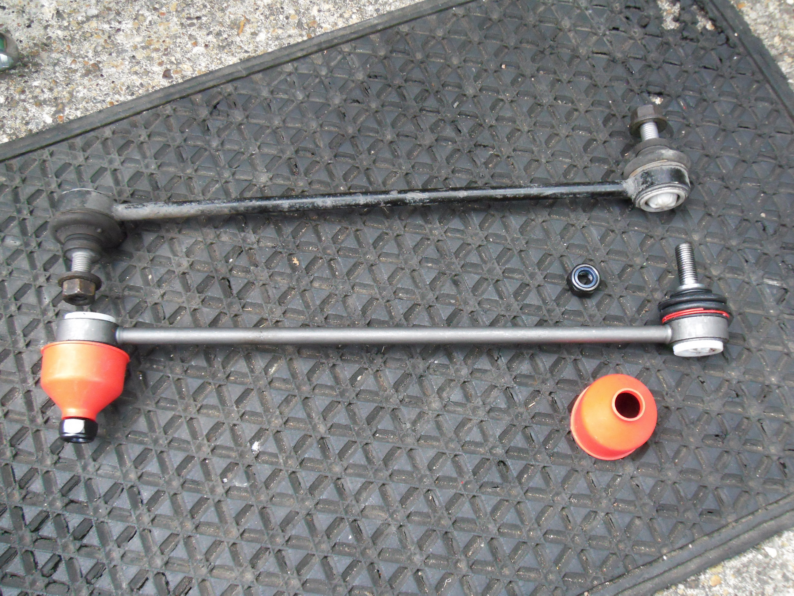

Remove the Nut from the stud / pinch bolt of the Drop link - there will be a socket in the end of the "stud" to make it like an "Allen-bolt / Grubscrew",
these can be either HEX - or Torx,
try and select the best fit.. as there will be a LOT of Torque through this as you undo the nut,
IF ( when) the socket "rounds out" you will have no alternative but to cut through the Stud of the droplink - I used an angle grinder..BUT a hacksaw will suffice..,
remove both the upper and lower nuts from the Droplink and remove it from the suspension strut.

place a Jack / pile of wood , under the Hub / Brake disc.
Slacken off the 2 Nut + Bolt sets that tie the Hub to the Damper ( Tight)
leave bolts in situ.

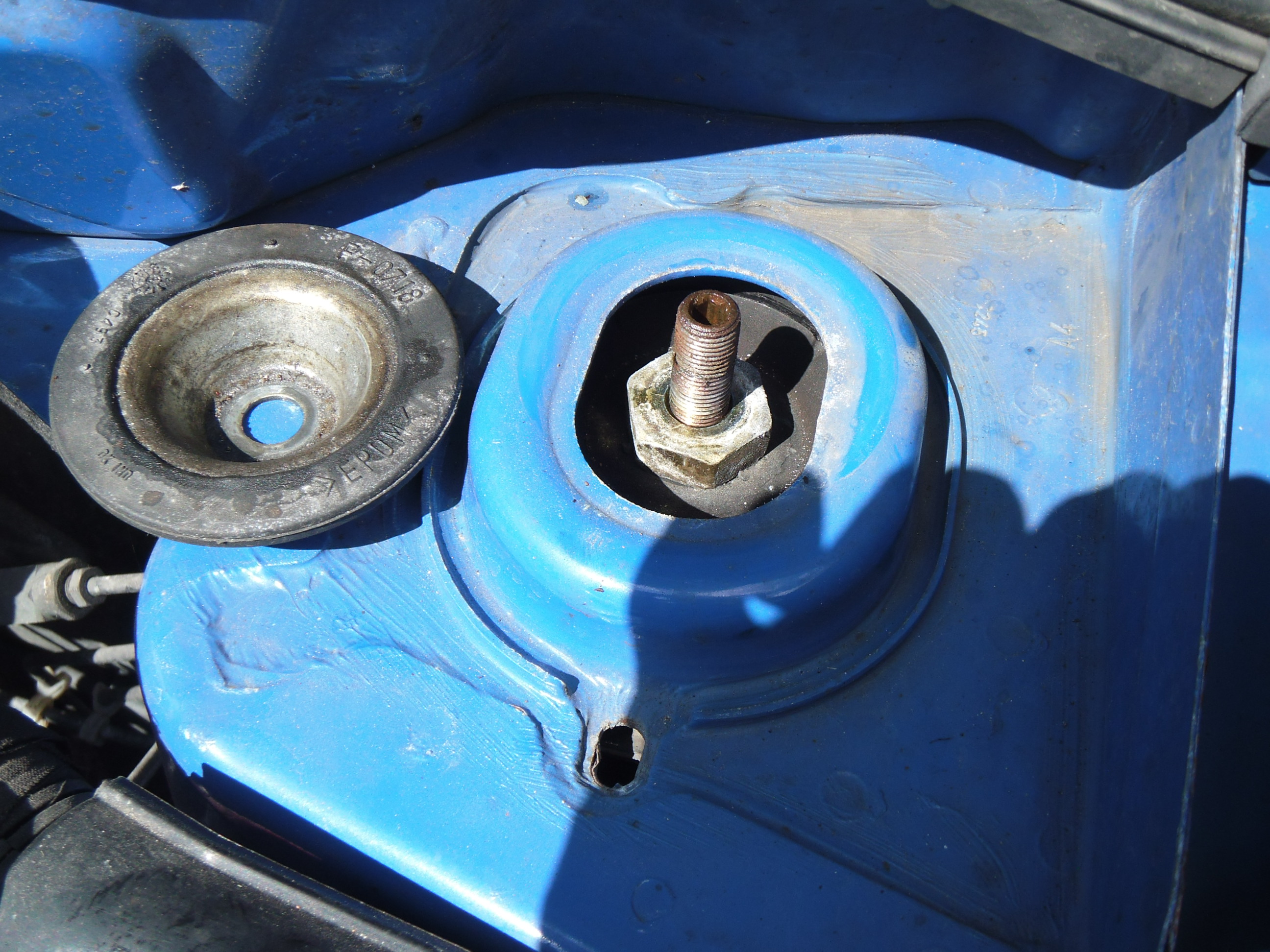

Under bonnet, undo the Nut around the Top of the damper head
( this was Tight + Awkward - needing a "deep" spanner)
wind off the Nut - holding the stud still with the Key = BEWARE = the weight of the whole unit sits on this..!!
Slowly / carefully remove this , and lower the damper assembly
TAKE note of the TOP mount plates orientation ( offset..!!)
then withdraw the 2 x bolts on the hub and you can then withdraw the complete assembly.
