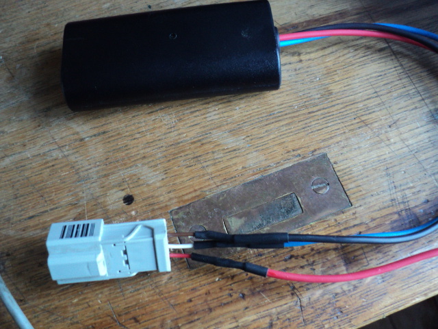

Reach under seat and swing out the plug holder.
Pull centre plug away from plug holder and separate the plug.
Cut the wires going to the seat. (the red, white, brown wires)
Solder the Red to red (+ve), Blue to white (Signal), Black to brown (-ve)
Remember to fit shrink wrap before you solder.
Shrink the tubing.
Plug together and fit to holder. Swing back into place.
