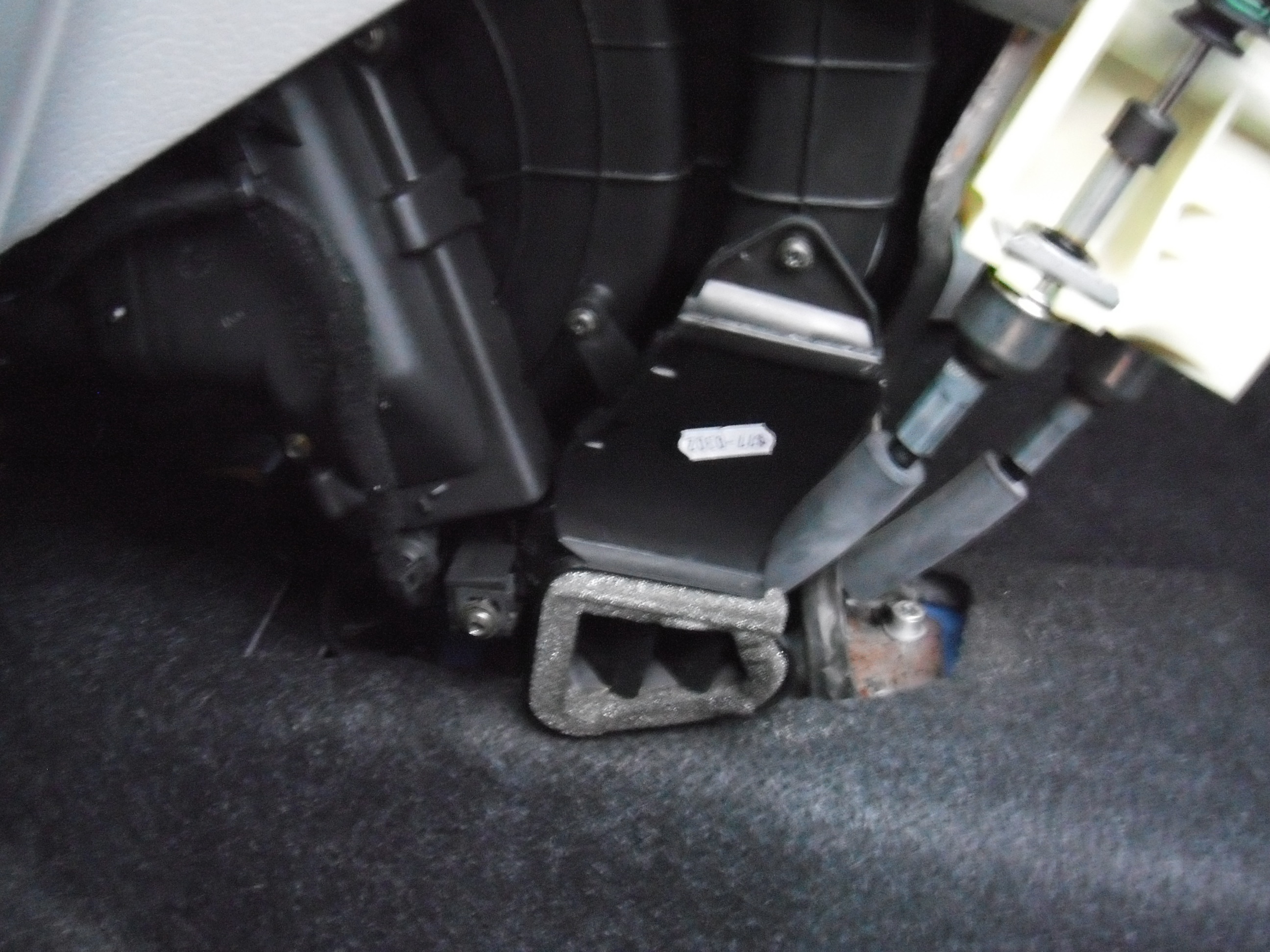

down by the ventilation grille = duct shown in pics;
there is essentially a "Handed Pair" of ducts / mounts and fittings
Screw in-situ for clarification ;)
