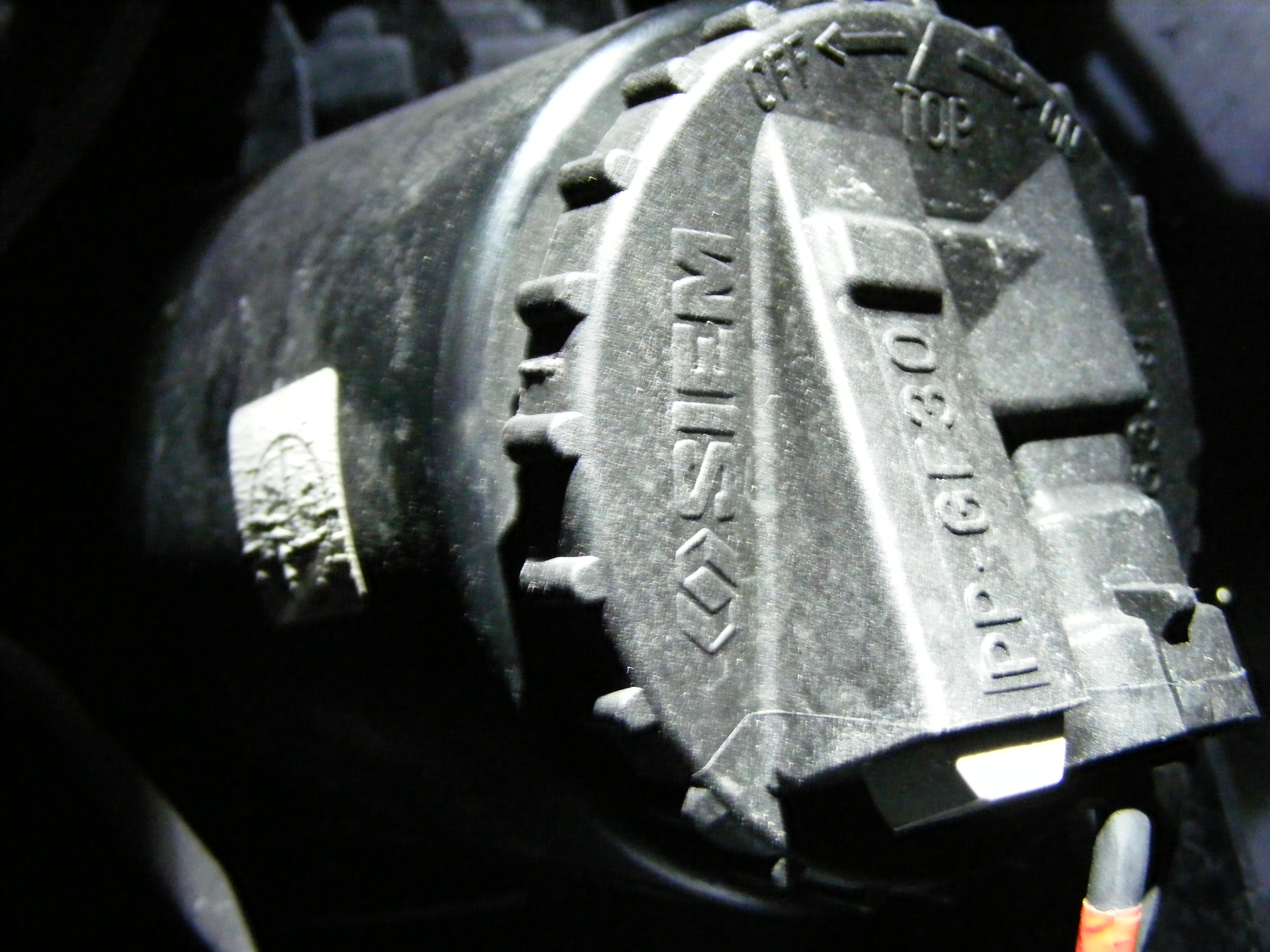

right assuming you have now managed to get to the back of the lamp
you need to remove the cover (Lee Punto says he needed a rubber strap wrench to open his however i have never had a problem)
this removes with a small turn Anti clockwise.. (about 1/8th of a turn)
at this point dont pull the cover too hard as it is still connected by wire to the bulb you are about to replace and you don't really want to damage the connector
