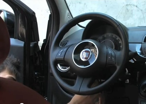

Step 1
Park your car up. Do not disconnect the battery yet.
Make sure you steering wheel is straight.
Remove the lower steering column shroud. There are 2 philips head screws holding it in place.

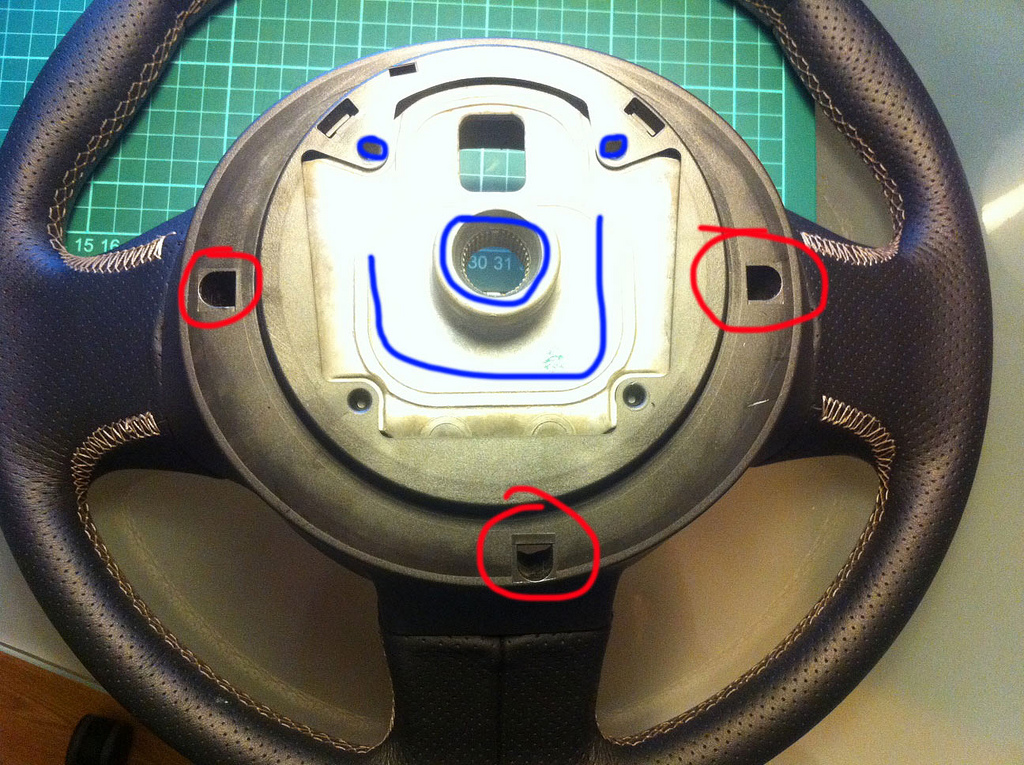

There are three metal tabs that hold the airbag in position, at the bottom spoke, left spoke and right spoke. See RUI's pic below...
Take your small flat head screw driver into the hole behind the bottom spoke and pry that metal clip. You will hear and see the bottom part of the airbag move out.
There is a real knack to doing this, it took me 45 mins to figure it out. It is not about force!!
Once you have done this start the car and turn the steering wheel so that the left spoke is at the bottom. Turn the engine off (just in case anything goes wrong) and repeat pry the next tab.
Then repeat the process for the right tab. Turn the engine back on and straighten up the wheel. The airbag should not be sitting loose, but not falling off!

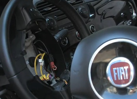

Carefully bring the airbag forward, keeping your face out of the way. Carefully disconnect the connectors on the rear of the airbag unit. See the original video on how to do this; the yellow and orange/purple connectors don't disconnect how you may think.
Disconntect the large black loom for the B&M controls. Ignore the removal of the B&M control buttons, unless you are fitting a Black SRL custom wheel.

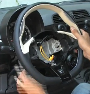

Remove the steering wheel. This may require an up/down movement. The wiring connectors for the horn/airbag/B&M will emerge through a gap in the middle of the wheel. They then sit attached to the ?clockspring?
When the wheel is removed be very careful not to expose the clockspring. Hold it in place and make sure the ribbon doesn't spew out of it! A few users have advised that another person holds it in place or use masking tape to hold it in place.
See below picture of steering wheel removed with clockspring unit in white?
Step 7
If you're installing a Momo style wheel for track use, refer to instructions supplied with wheel abnd boss kit. Install boss kit horn connector, airbag resistor and then bolt on steering wheel. Store you original wheel and airbag away safely, ensuring airbag is kept upright and unobstucted!
Otherwise.. Offer up your new steering wheel, but keep that clockspring in place! Feed the wiring connectors back through the gap. Use the green/blue dot to ensure steering wheel is installed straight.
