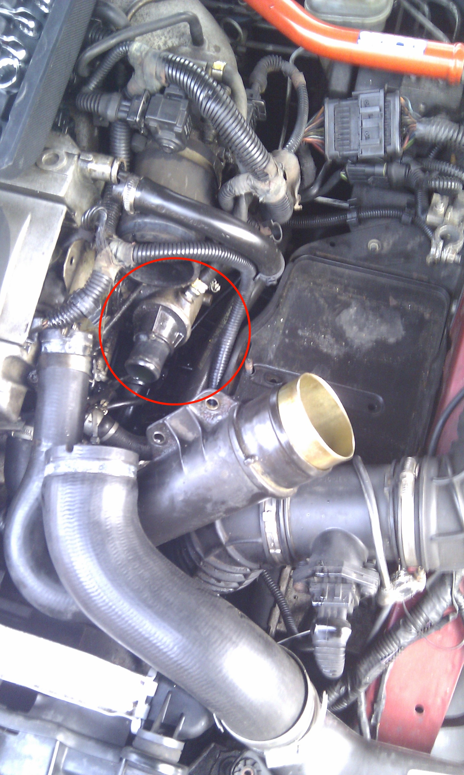

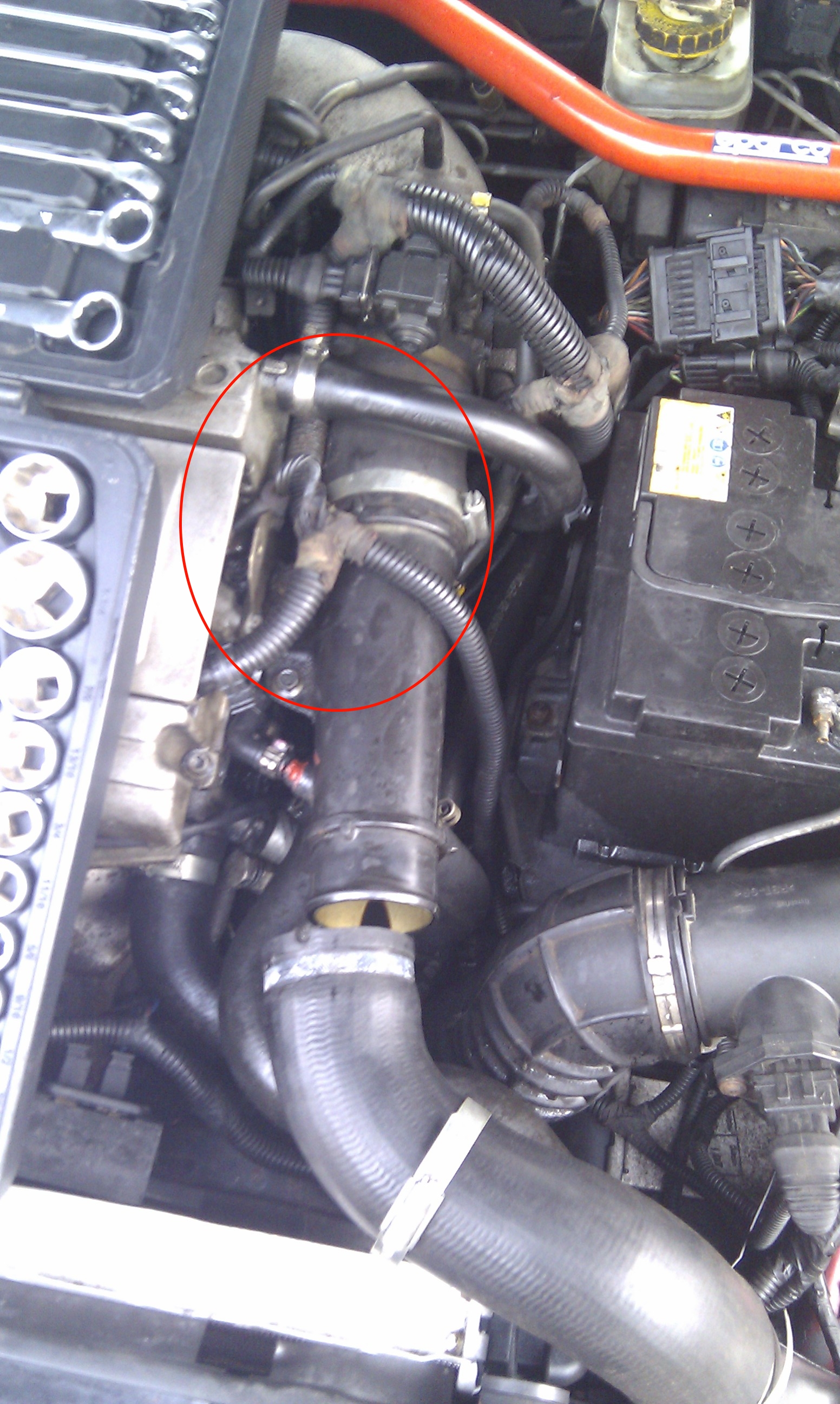

The Thermostat is located to the right hand side of the engine bay underneath the Air Inlet tubing.

Next it's time to remove the Air Inlet host which is bolted to the engine with 2 x 10mm Hex Bolts, As well as the crankcase breather hose and the coolant hose. Your engine bay should now look something like this revealing the all important thermostat:-
There are 4 coolant hoses running to the thermostat as well as a coolant temperature sensor (Blue).
