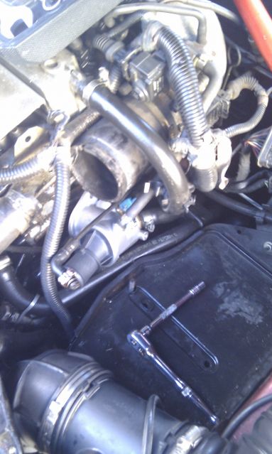

Next it's time to remove the Air Inlet host which is bolted to the engine with 2 x 10mm Hex Bolts, As well as the crankcase breather hose and the coolant hose. Your engine bay should now look something like this revealing the all important thermostat:-
There are 4 coolant hoses running to the thermostat as well as a coolant temperature sensor (Blue).

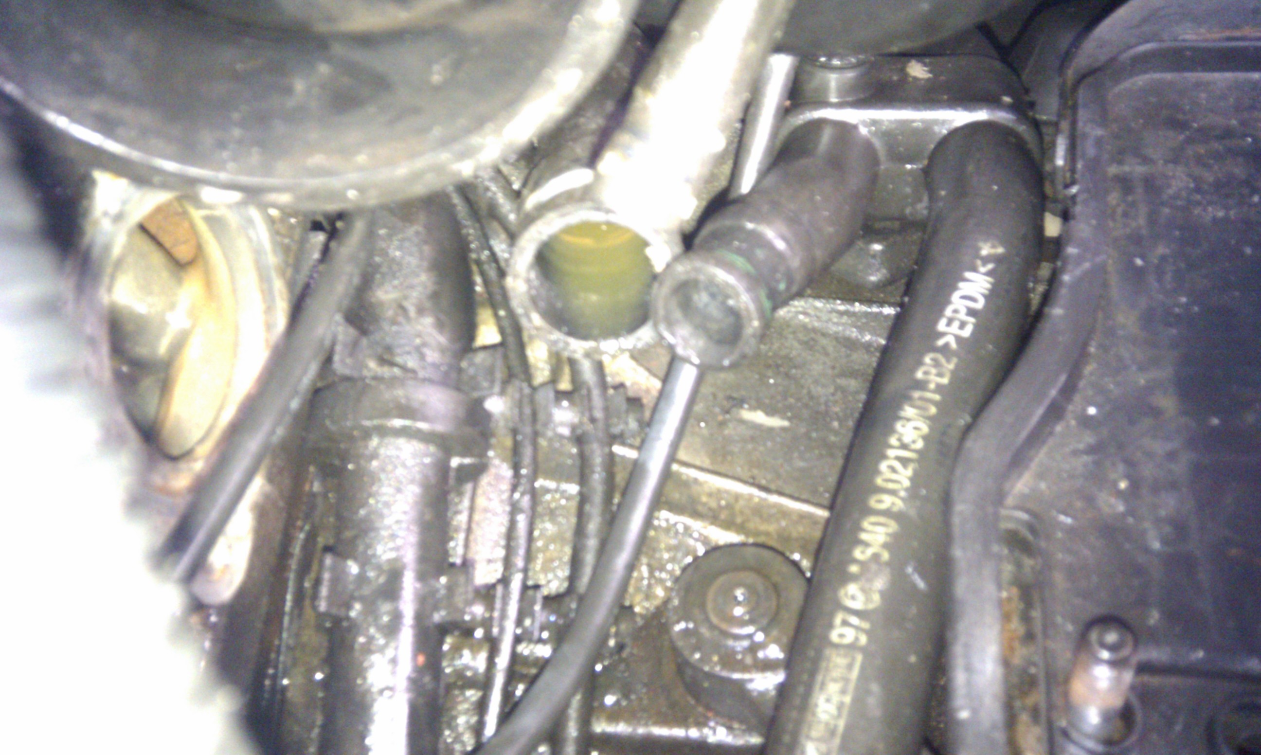

Refitting is simply the same process in reverse. My advice would be to connect the back hardest to access hose one the far left first then connect the thermostat due to access:-
Notice the bleed screw. The other one is located on the radiator itself.
