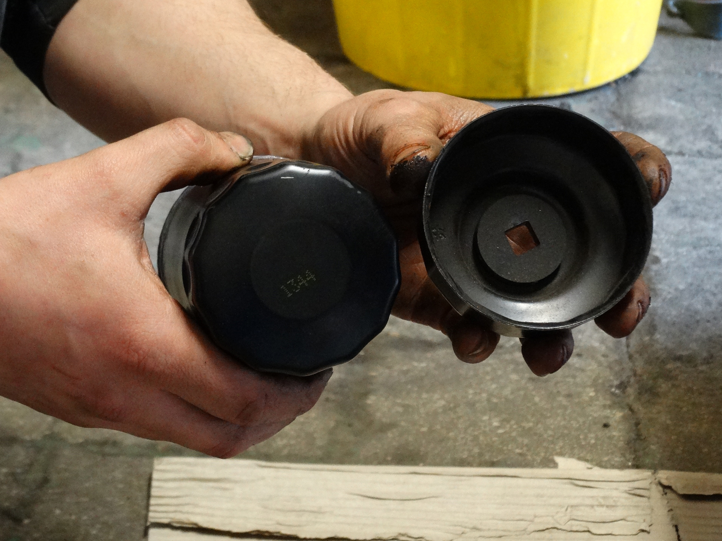

So did the oil and filter the other day and I don't think Fiat could have made the task any easier. I jacked the car up and put it on axle stands but given the location of the sump plug and the filter I could have probably done it on the ground!
When I got the new filter out of the box (QH branded) I was pleased to see I had an oil filter socket which was the right size for it, I'd got it for an old bike of mine where the oil filter is within the sump and difficult to get to.

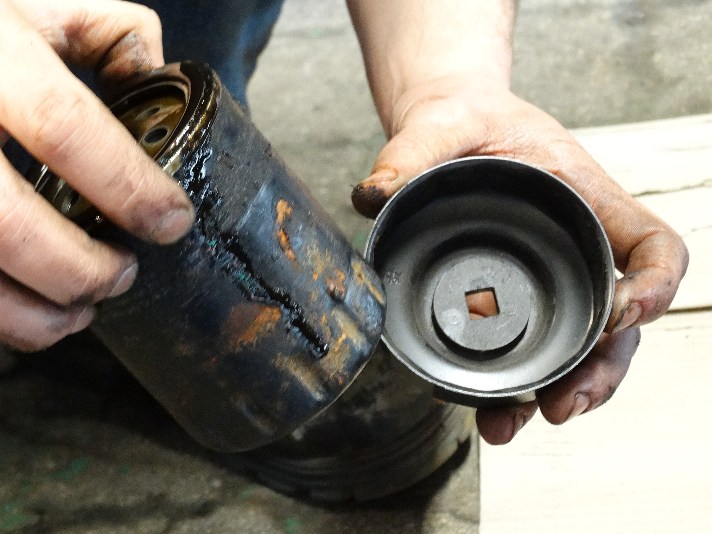

After quietly high fiving myself for having the right tool I got under the car to remove the old filter, which I think was Fram branded? Anyhow, that did not fit the socket! I had an old filter wrench kicking about but it seemed to big for the old filter, so I wrapped a block of wood in sand paper, jammed that in and job done. Not sure what the correct procedure would have been, though now it doesn't matter, as the new filter will fit my socket!
