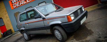

On the topic of stripes, take a look at these...
The first one is the Wheeler Dealers car before the painted it, a nice stripe but the red wouldn't work on my red car. Which is where the second one comes in, a red car! Ignore the rust, you can still see the stripe, just about. I quite like it, I suppose I could get it to go across the boot as well! Maybe something to forward on to the local company to ask how much that would set me back? :idea:

On the wheel front, having just seen how crap the Wheeler Dealer car looks with orange wheels I may proceed with caution on my wheel colour choice:eek:

The Wheeler Dealers car is horrible unfortunately (n) The 4x4 it was before was awesome, with the rare Panda stripes! If only it was still like that, shame it got painted with that horrible paint and tacky scheme...
