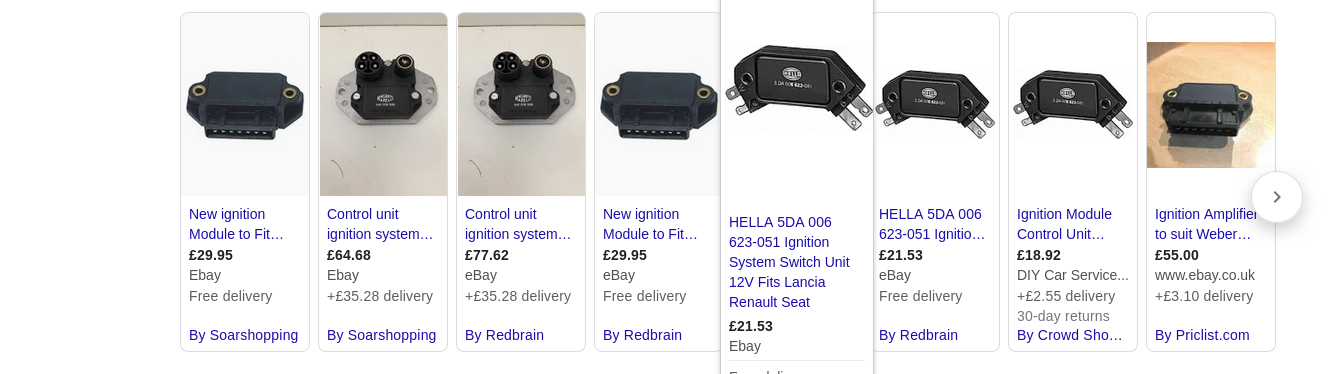

Looking at your distributor I am tempted to make a guess it is the amplifier black plastic box screwed to the distributor body on the outside.
Many cars of that era used similar forms of electronic ignition before finally going to full ECU set up.
At the time we were replacing lots of Ford amplifiers .
Do any of these amplifiers look like the one on your distributor, if one matches it may be worth trying as was a common fault in the days when they were nearly new.

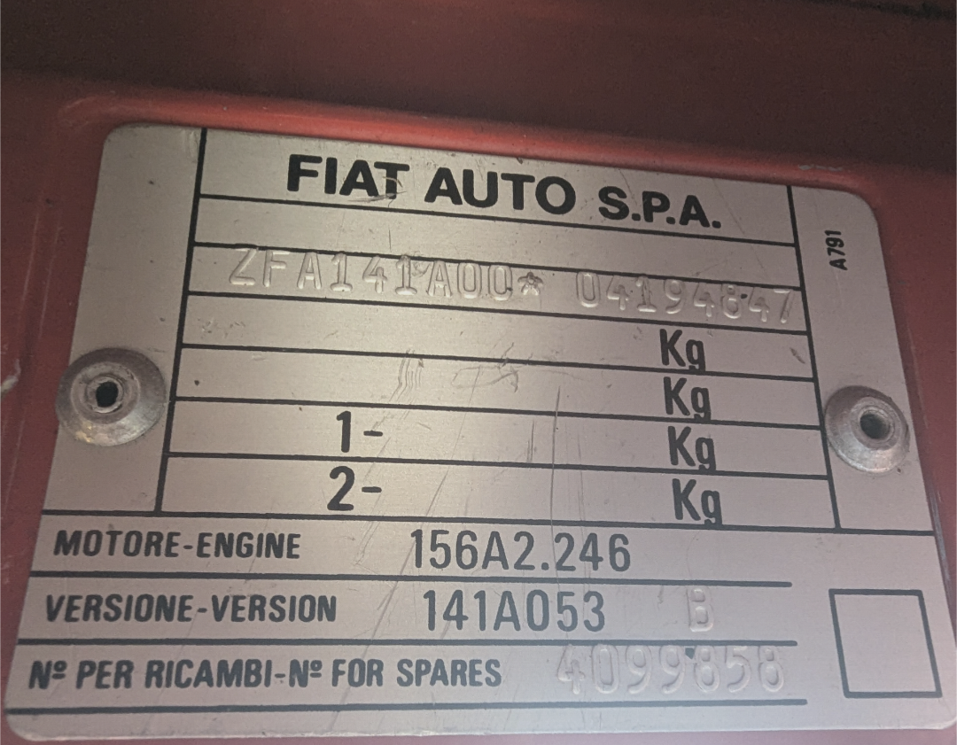

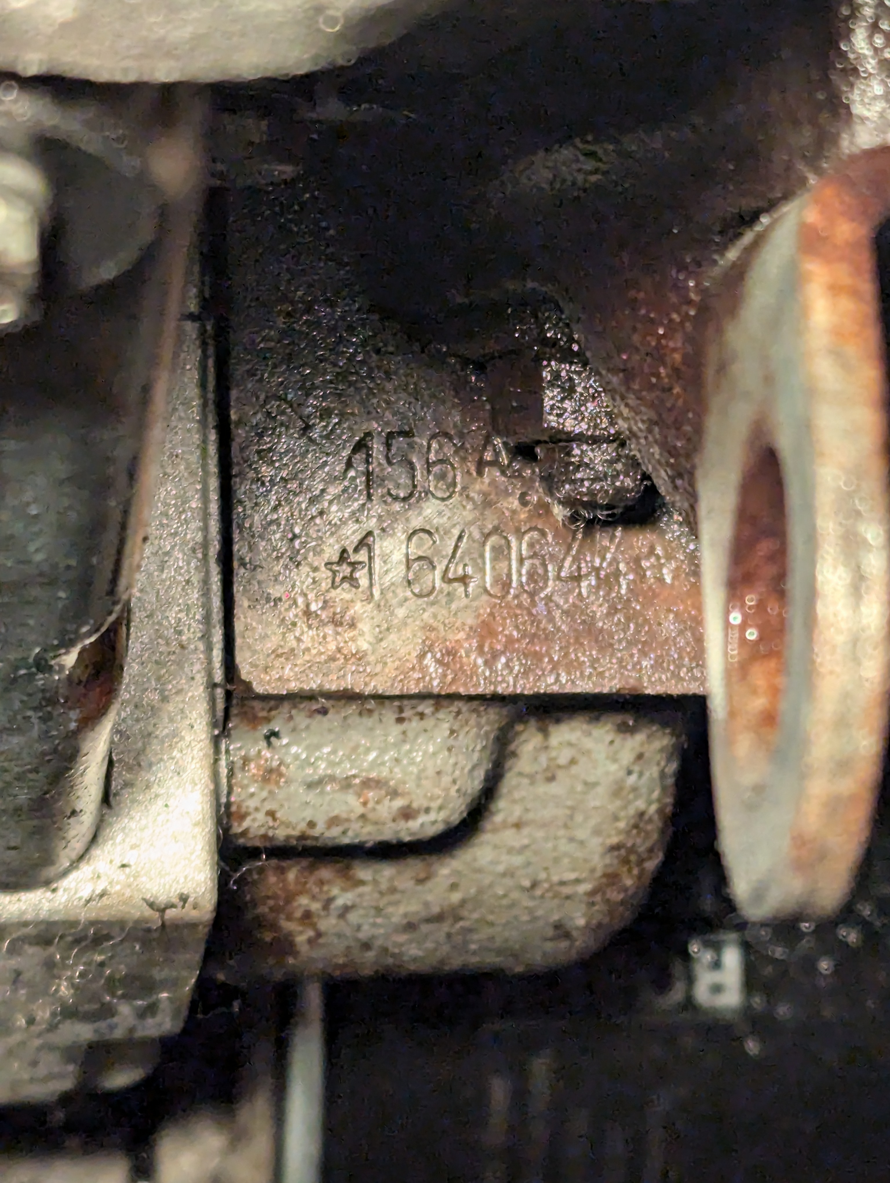

Re the Engine Series Number, it doesn't quite match what I have, is that from the actually Vin Plate?

The distributor is new complete with mounted new amplifier
