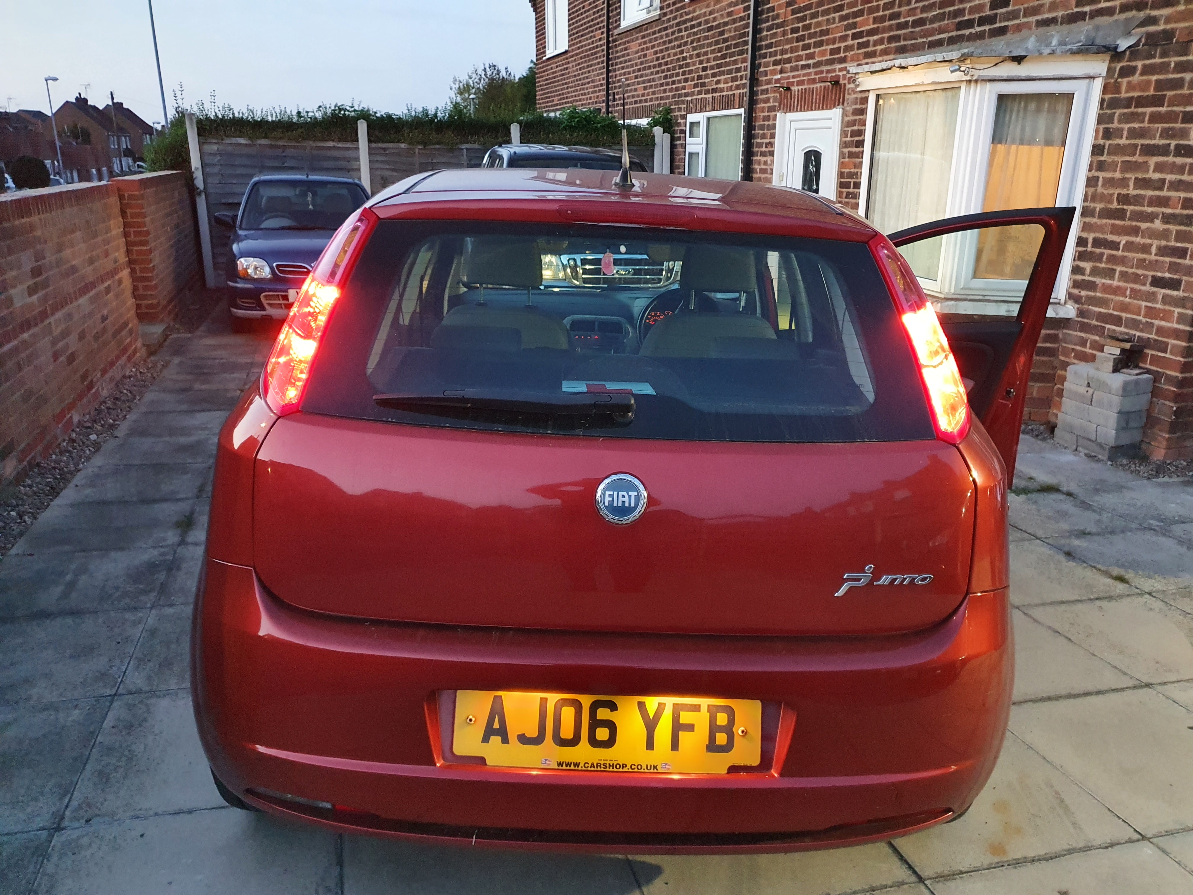

2006 1.2 rear brake light problem.
turn on the lights and i get four lights turn on, i assume that is how it should be?
with no lights on.
press my foot on the brake pedal and only the right hand brake light goes on, there is no power to either the left brake light or the high line brake light (i have seen that the left brake light and high line light are connected) bulb is fine as it works in the right hand side, new bulbs fitted anyway just to be safe.
with side lights on
same as above.
i also note that the boot light isn't coming on either and no power to it? connected problem?
any advice would be appreciated please.
thanks Tony

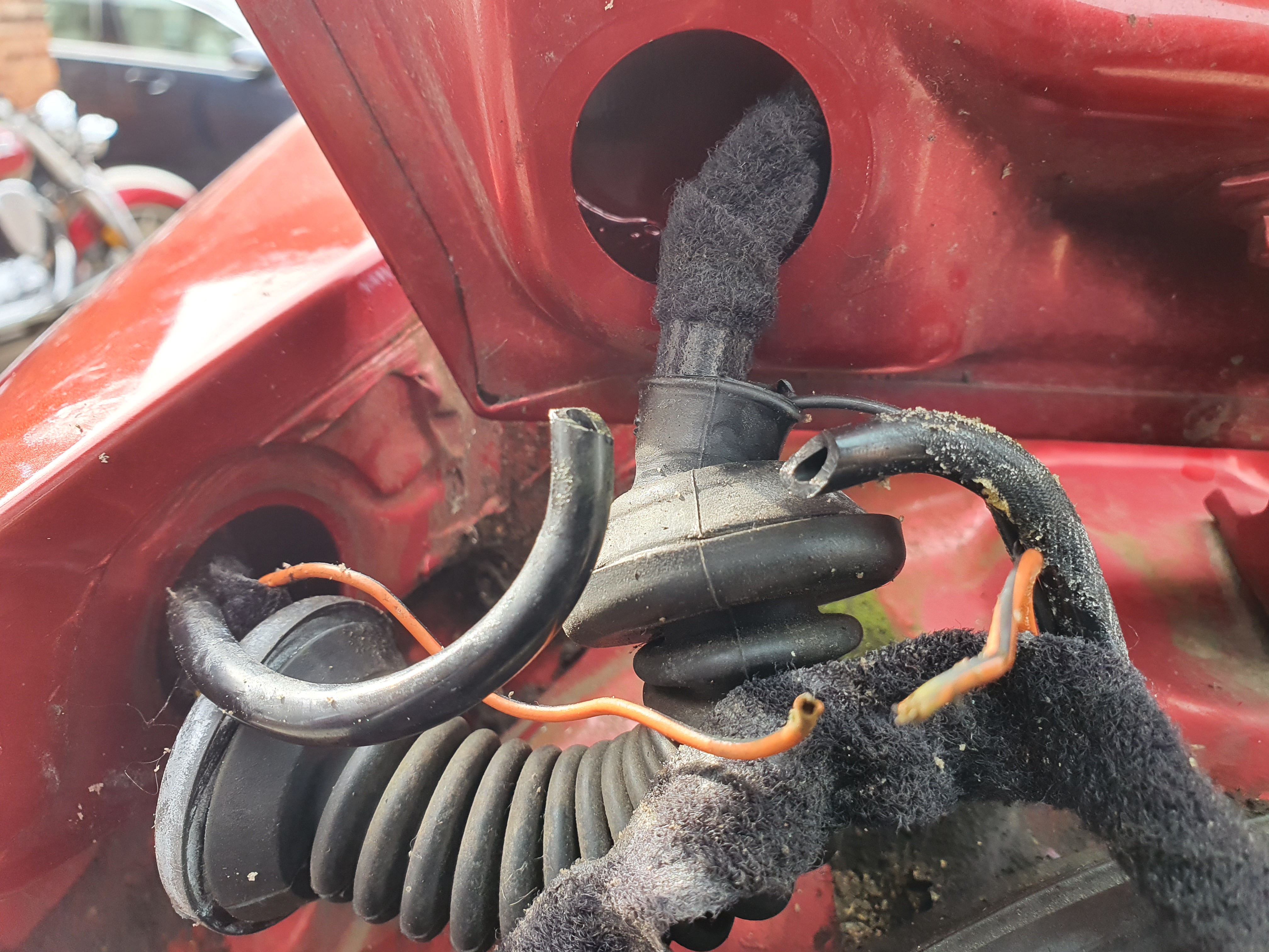

Check the flexi cable in rubber boot for tailgate..
Wires dont like being bent.. they can fracture
yes you were right, washer pipe had snapped as had the wire for the high level light.
so now i have a right hand brake light, high level brake light but no left hand brake light.
i have traced the green ith white wire back in the loom as far as i can and now i have an intermitant problem, some times i get power along the wire other times nothing?
