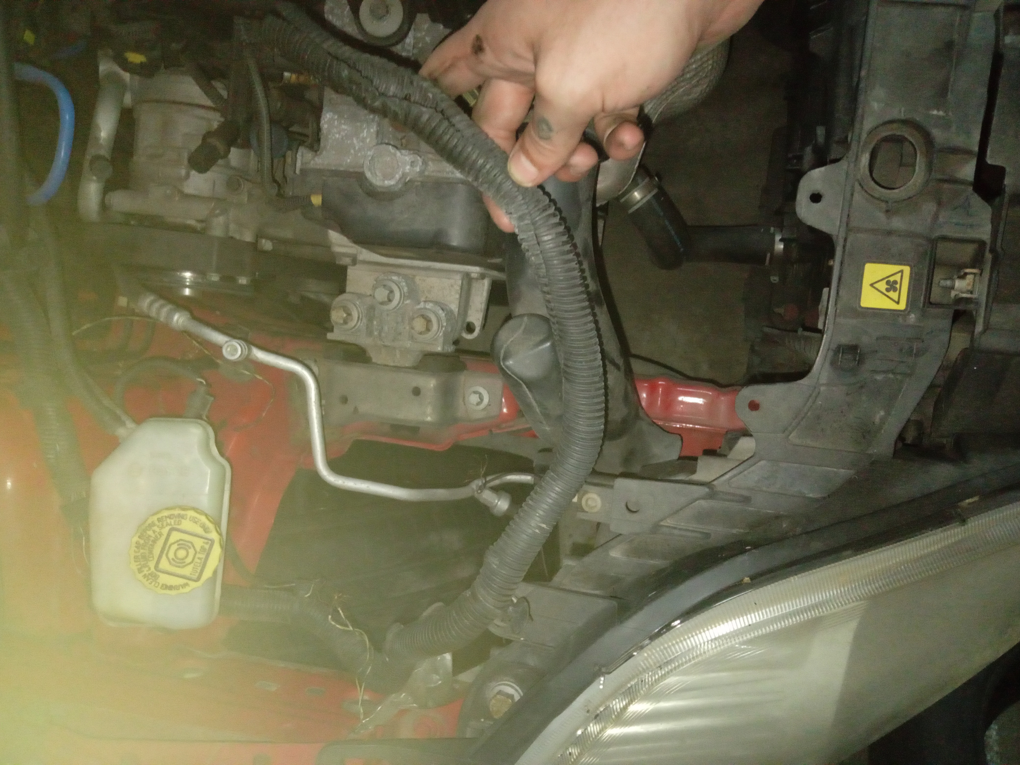

ok so i have a fiat grande punto
it got some severe damage by having wires pull into the wheel while driving so damaged wiring
i need to fix the car , but im not sure what wire loom im looking at
secondly theres a silver rod next to the engine that i dont know what it is
so the airbag firstly isnt working
secondly the abs is disabled
if anyone have links to help me with rewiring these pieces would be very helpful
aswell as knowing what that silver rod is by any chance?
thanks for reading

yea so problem is still im struggling to get information on the wiring of abs on the right side breaks system , i think but ill have to double check , it seems ill need to get another abs sensor on the driver side , because i cant remember seeing the sensor on the wiring anymore , firstly
im assuming some of the wiring was also leading towards the bumper that has a sensor for the the airbags
and then the other wiring thats from the bumper is likely the right indicator and headlights?
Basically, you would need to solder the ruptured wires.
The color of the wires might indicate their function.
Those colors are indicated at the connectors. The abreviations are in italian.
For example, front right ABS connector
The wires from several consumers, sensors and so on are bundled into harnesses.
It’s costly to replace the entire harnesses but if you’re unable to solder and have access to the same model for harvesting items, then replacing the harness would be best.
With soldering, you would have to cut the copper until there is no more sign of oxydation (redish-golden color instead of blackish). Also the result of the joined wires should be water-tight. There exist special soldering tubes which contain solder and which will contract and build a hermetic seal on both sides once heated. You need special equipment like a dedicated small hot air blower for this. Whilst the hot gases of the flame of a lighter might also work, it will create a huge fire hazard so I’d recommend against using that. You might also risk burning the wires you already soldered.
Basically, same color wires will go together but there might be several with the same color, so be carefull.
Disconnect the battery and wait 15 min before working on the electrical system.
