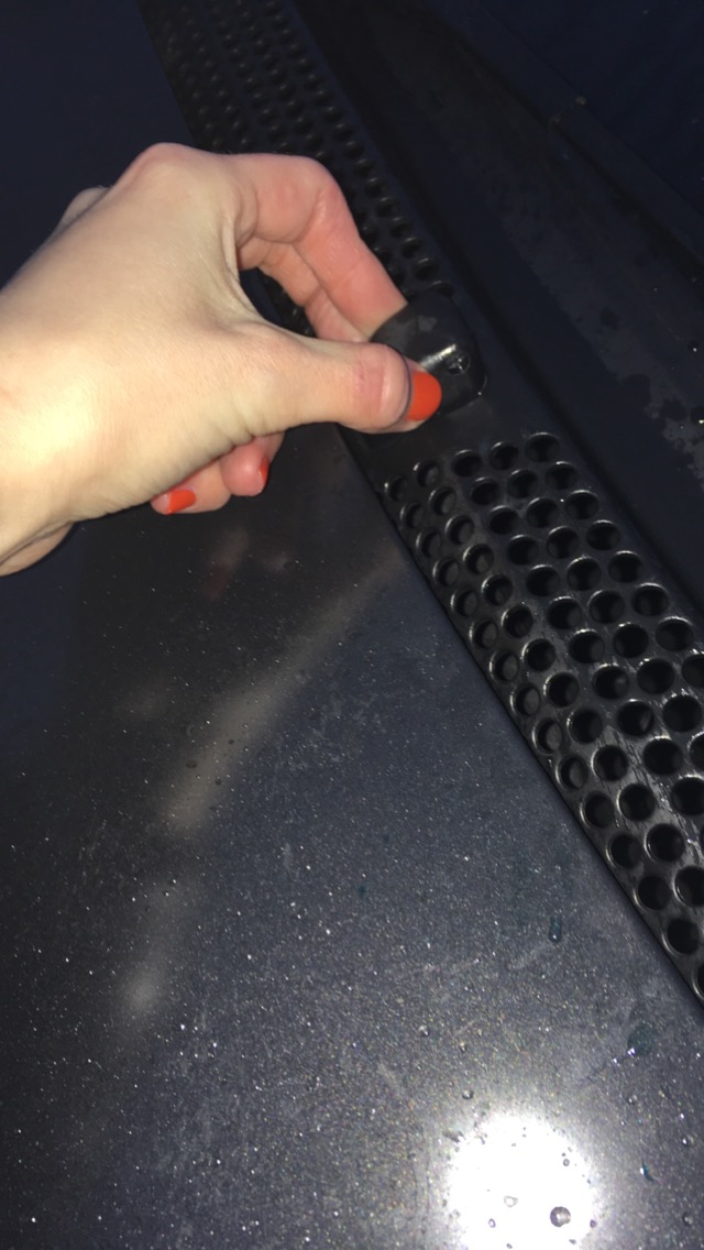

Hi, have tried to pull it out but it's totally stuck? Struggling to get it to budge at all..
If you have to remove the trim, only remove the 3 "screw" fixings at the front, small hands can then get up inside.
Whilst the fixings look one piece they're not take a look at my picture/text in this other guide;
https://www.fiatforum.com/500-guides/440891-front-shock-absorber-replacement.html
Do I need to do the windscreen wiper part for that still? It looks so confusing. Looking at my spare part, there's wee clips that I'd need to push in before being able to remove them?
