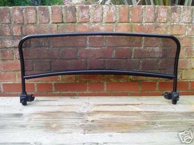

The brackets as shown are fitted in reverse (less vulnerable in transit) - for fitting they stick outwards.
That is the same as mine, piccie's in about 10 mins

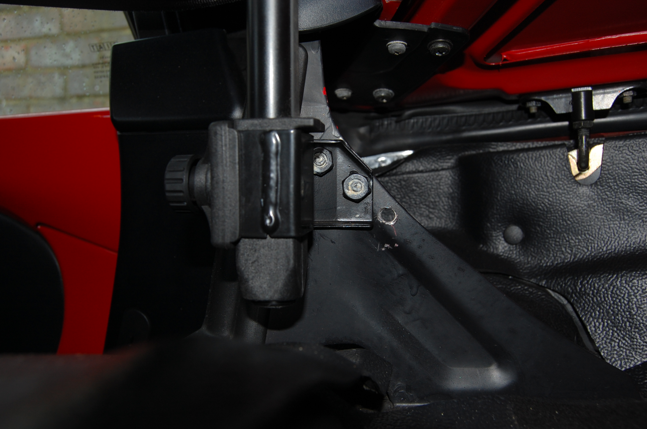

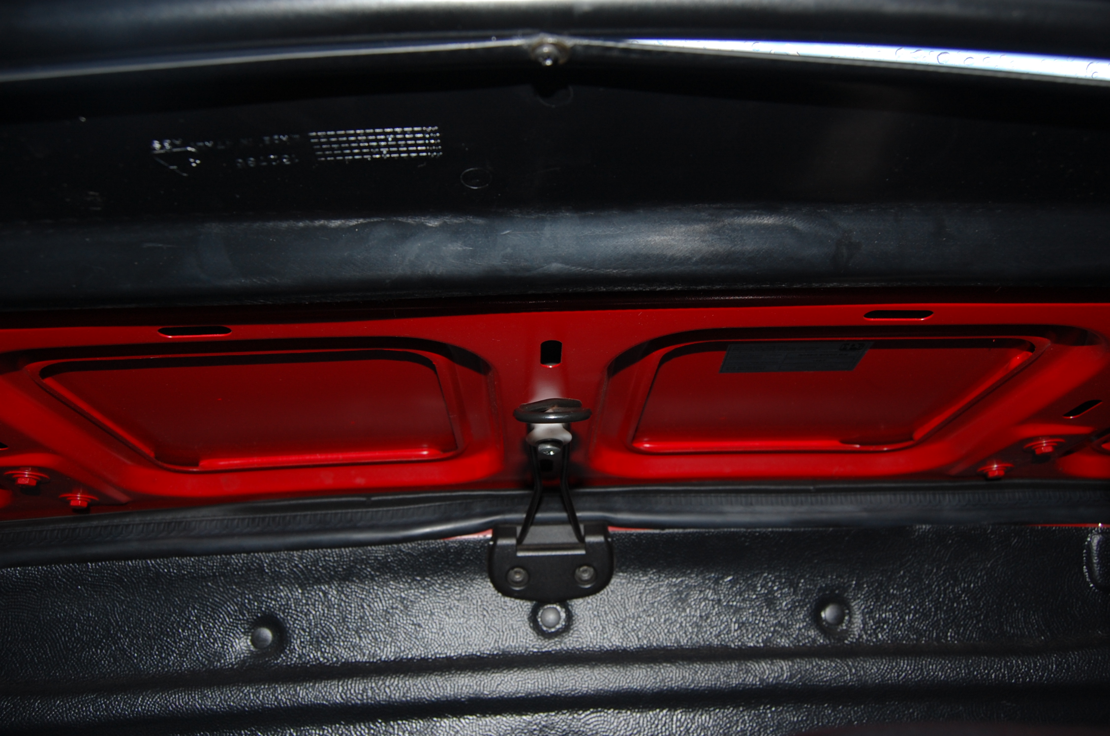

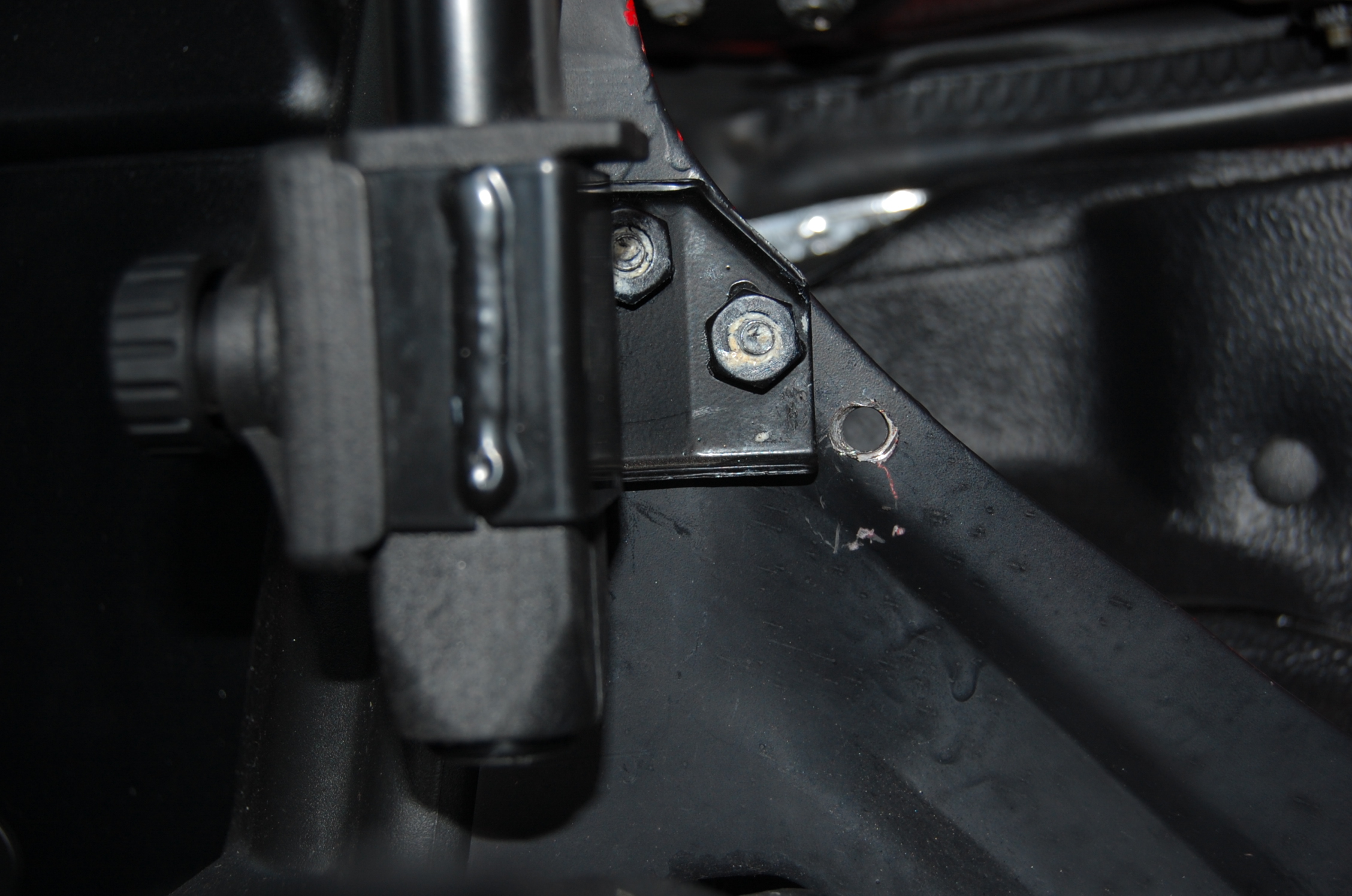

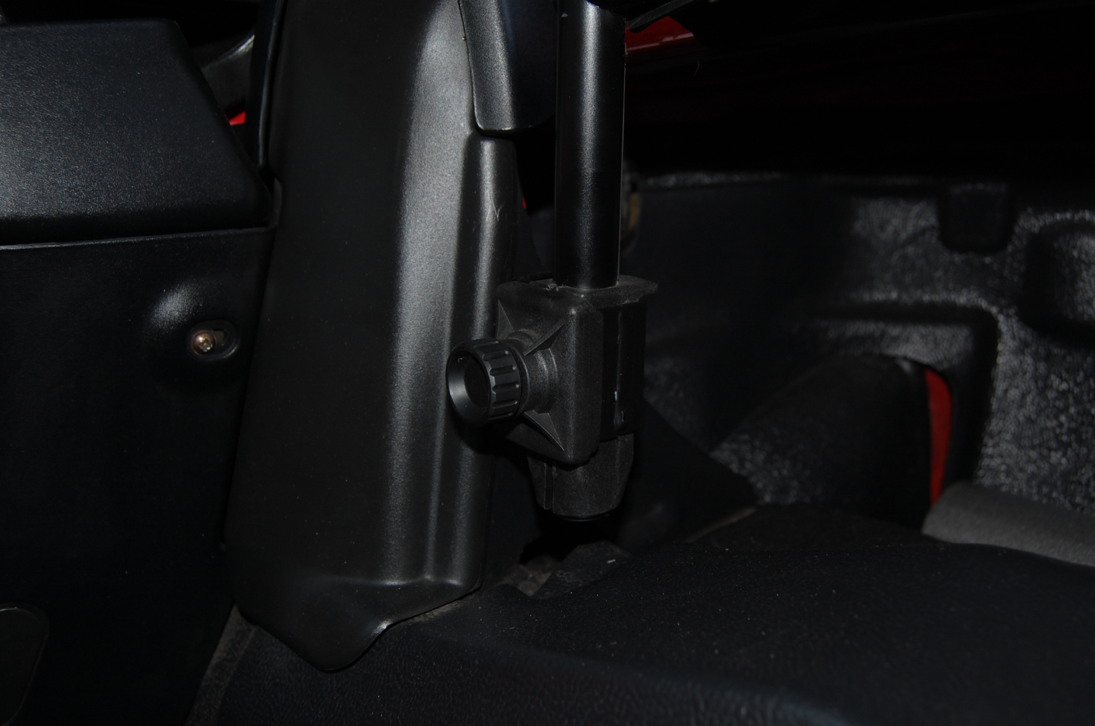

OK, I have nipped out between the squalls to take a couple of photo's, would have been better with the roof down but no way I was risking that in this weather!
In the photo's you can see where I mis-measured my first cut and drilled a hole too low! (I am going to stick an LED in there to light up the 'parcel shelf' space (and cover up the fact I cut a hole in the wrong place)
You can see from the photo's that the windstop bracket is shaped to fit the seat belt bracket so I used the two edges to line the bracket up. You can also see (but only just), that the lip on the back of the windstop butt's up to the hood cover.
To fit mine I simply put the windstop brackets onto the windstop, lowered the hood and put the hood cover down. I then got Mrs LRB to position the windstop in place with the windstop 'lip' against the hood cover, marked the holes in the brackets and then checked that the hood could be raised and lowered in that position (with Mrs LRB still holding it in place) to make sure that the hood mechanism did not foul the windstop.
The reason that I mis-measured the holes the first time around was because I tried to do it without the help of Mrs LRB! top tip - get someone to help you by holding the windstop in place before you start drilling. Also, once marked remove the windstop and then re-position just to make 100% sure you have it marked in the correct place.
It's an easy job and should only take abou 30-45 mins (y)
HTH, if you get stuck give me a call.....
Also a very big thanks to OZ who sold me the windstop at a very reasonable price (y)
