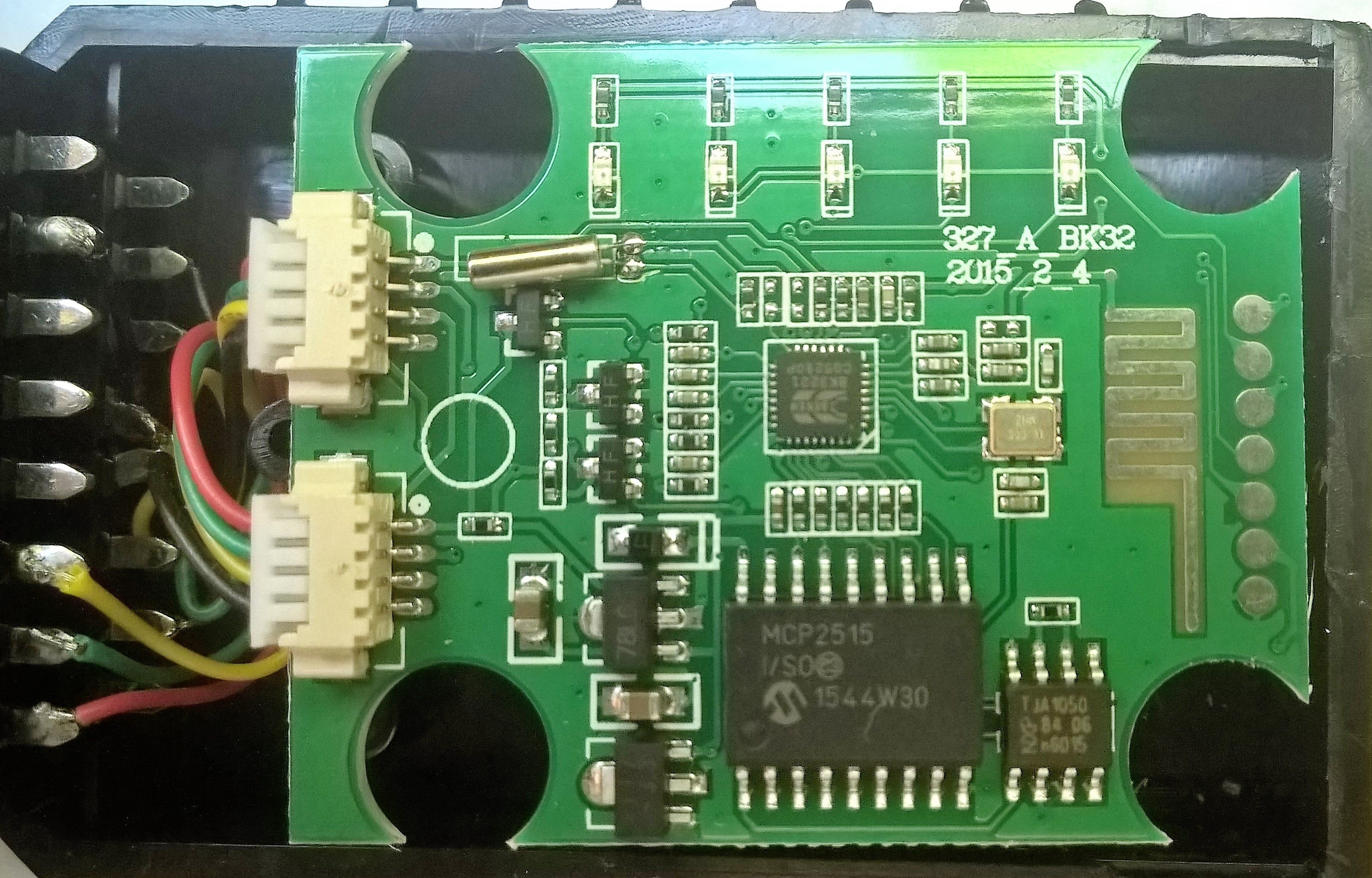

ELM has arrive and it works with almost all phone/tablet diagnostic software.
But when I try to connect it to multiecuscan, it said this:
Please connect the interface to a car!
Scanning ...
ELM 327 v1.3+ (Bluetooth) interface found at port COM5, speed 115200bps
WARNING: This interface is not compatible with ELM 327 1.3! Will not connect to any CAN module.
And it can't, I try everything. In attach there is photo of ELM.
