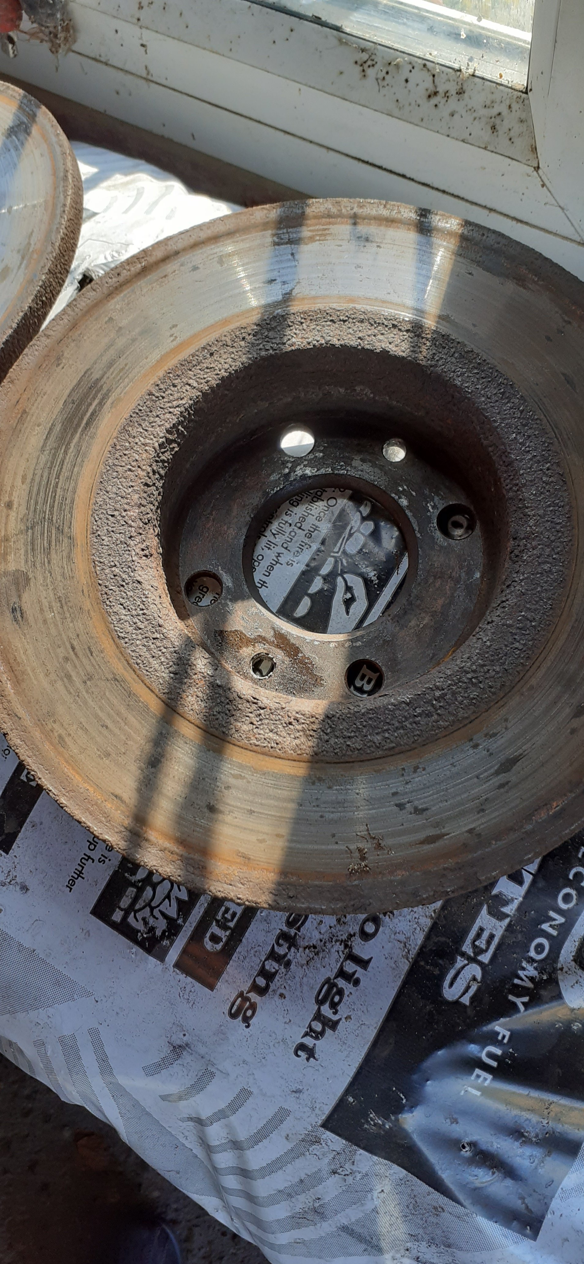

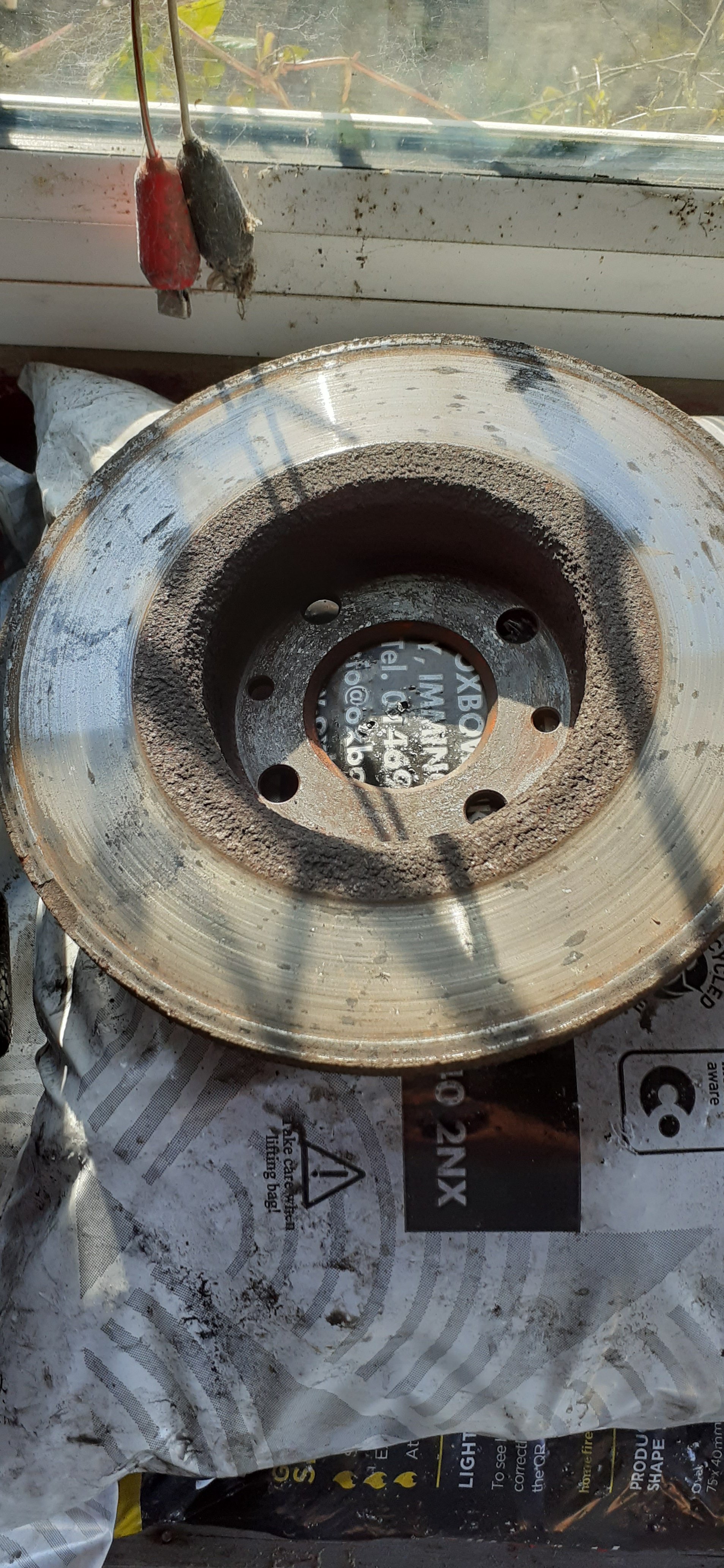

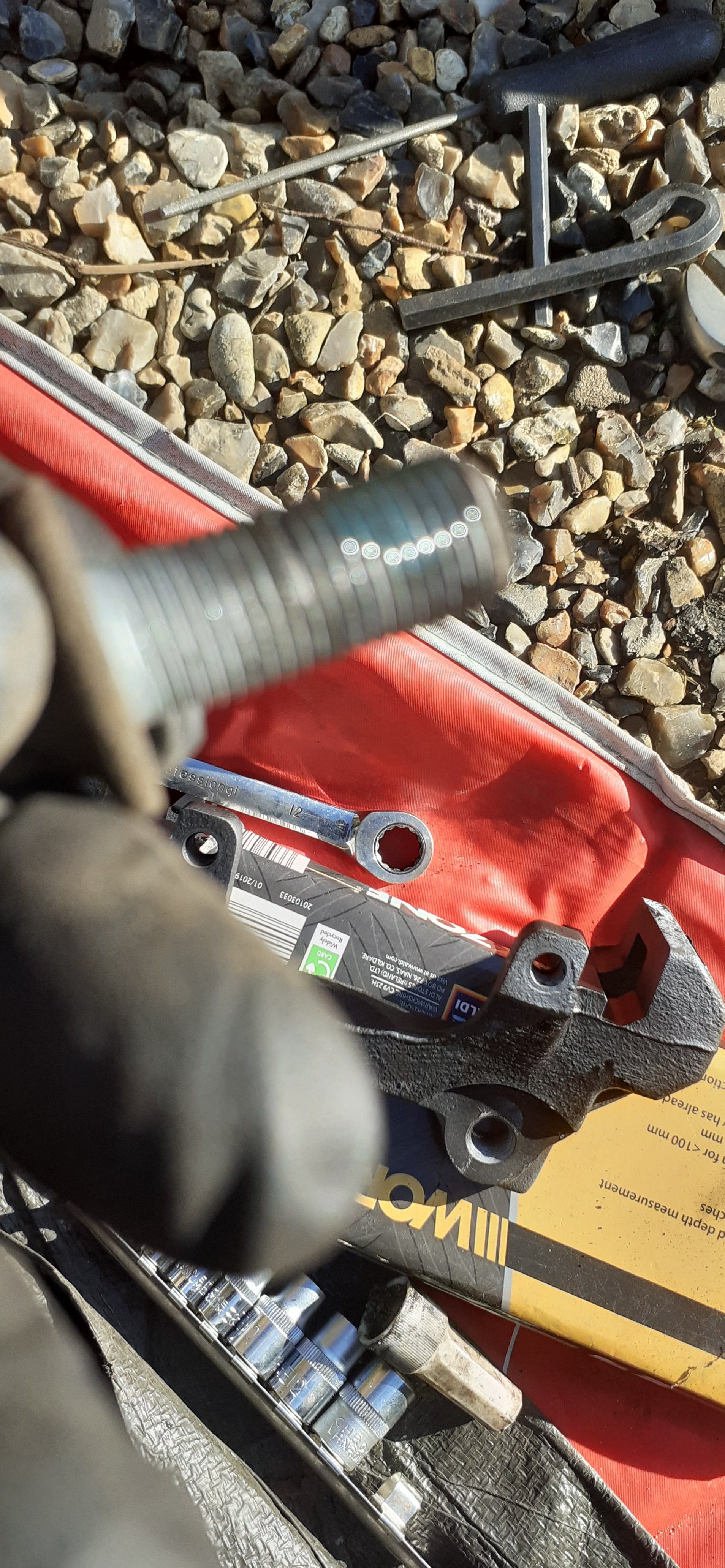

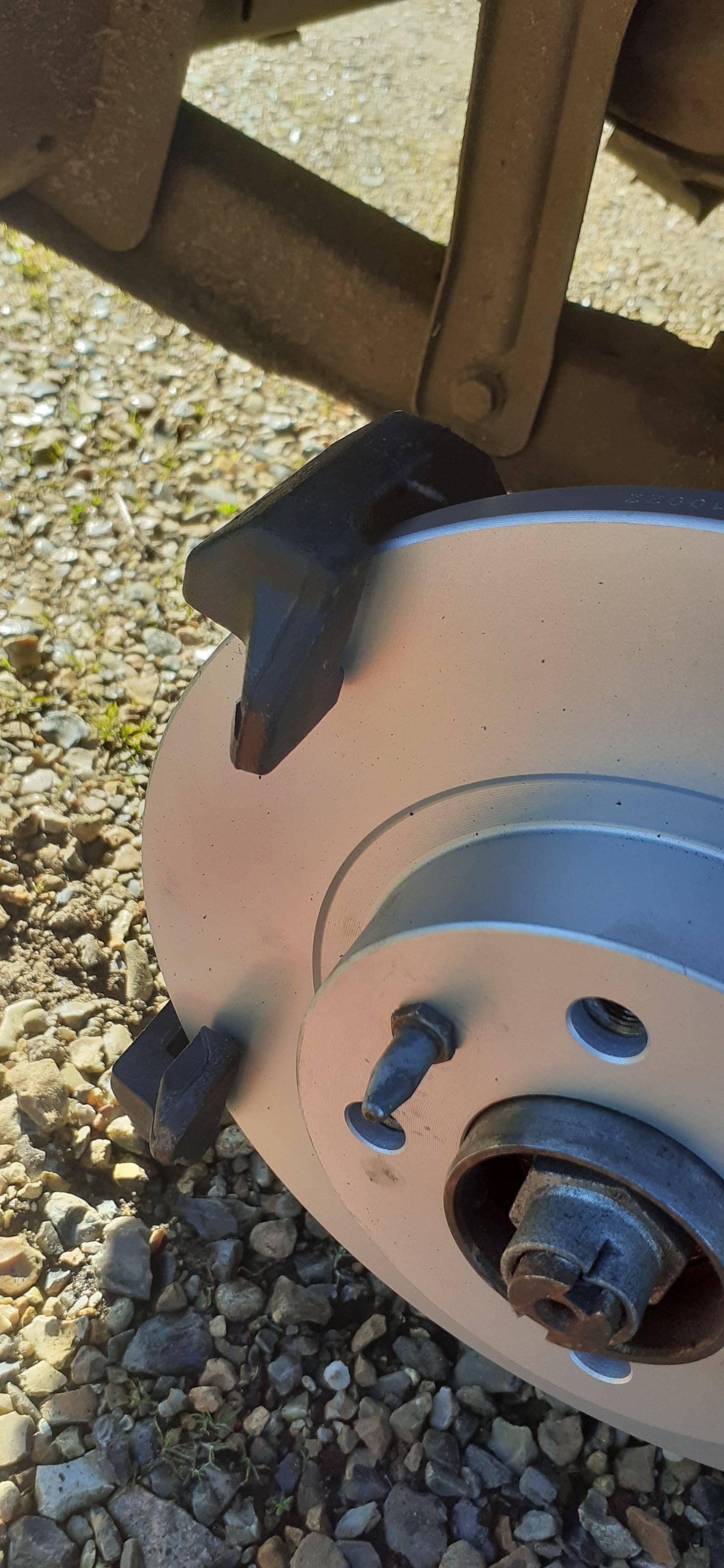

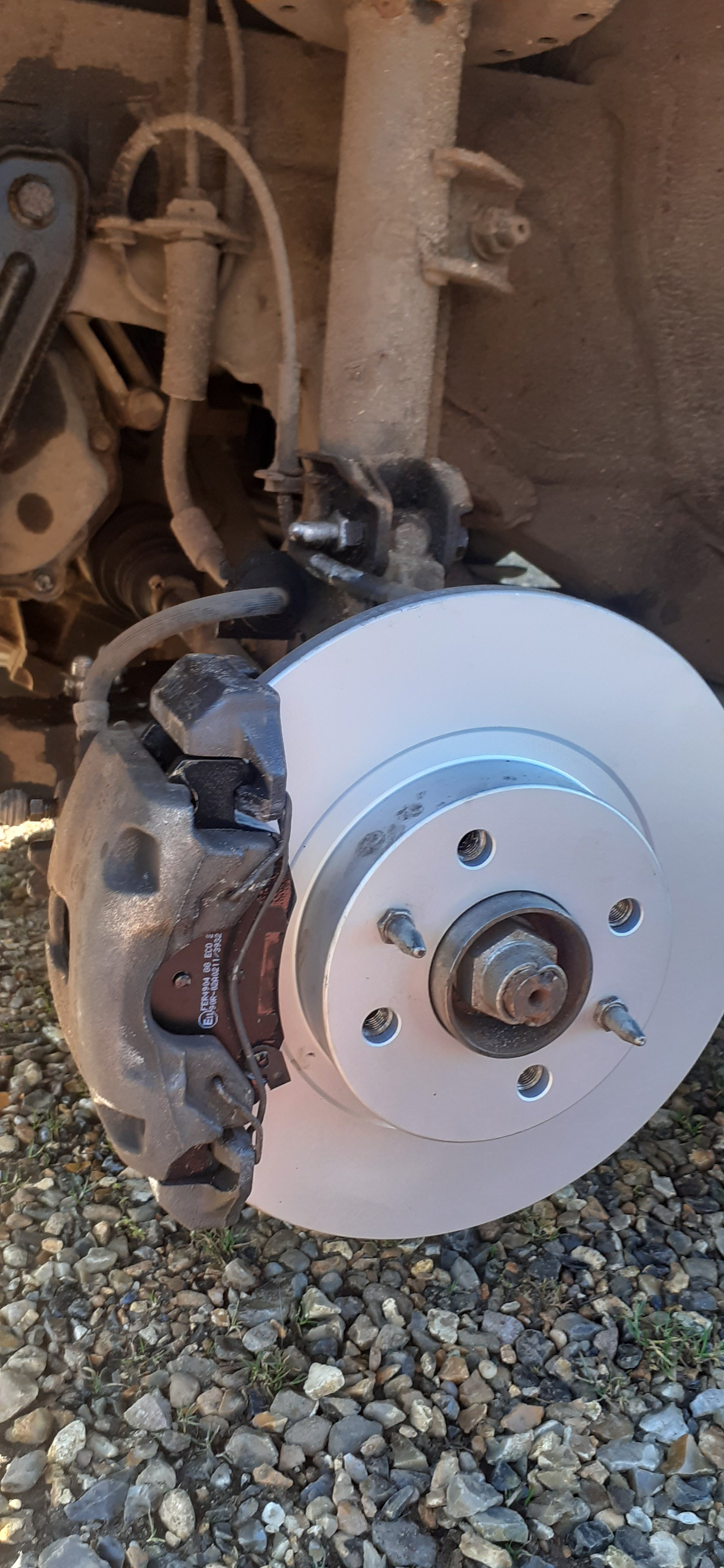

Rubys brakes. Theres the 16%. These we spotless and in perfecr condition 1 year ago.
All totally as should be again. How long this time. Its notable these cars dont have a full back.plate just a part one. Im considering modifying it. Im getting.new pins and caliper bushes. I checked pistons are free moving. Theres nothing else to do. Even the back plates are clean and rust free. I spoke to GEM 's technical expert. His pronouncement. They are designed to go like this. The reduced braking will be accounted for by Fiat. It doesnt matter and there is nothing worth raising with Bosch or Fiat. To wit I say... ******ks! Rusting like this aint right and it ought to be addressed. Half height back platesmay be ok in Italy, but not so good here I think.
Moral of the story: Charge hard andbrake very hard. We need some Alps.

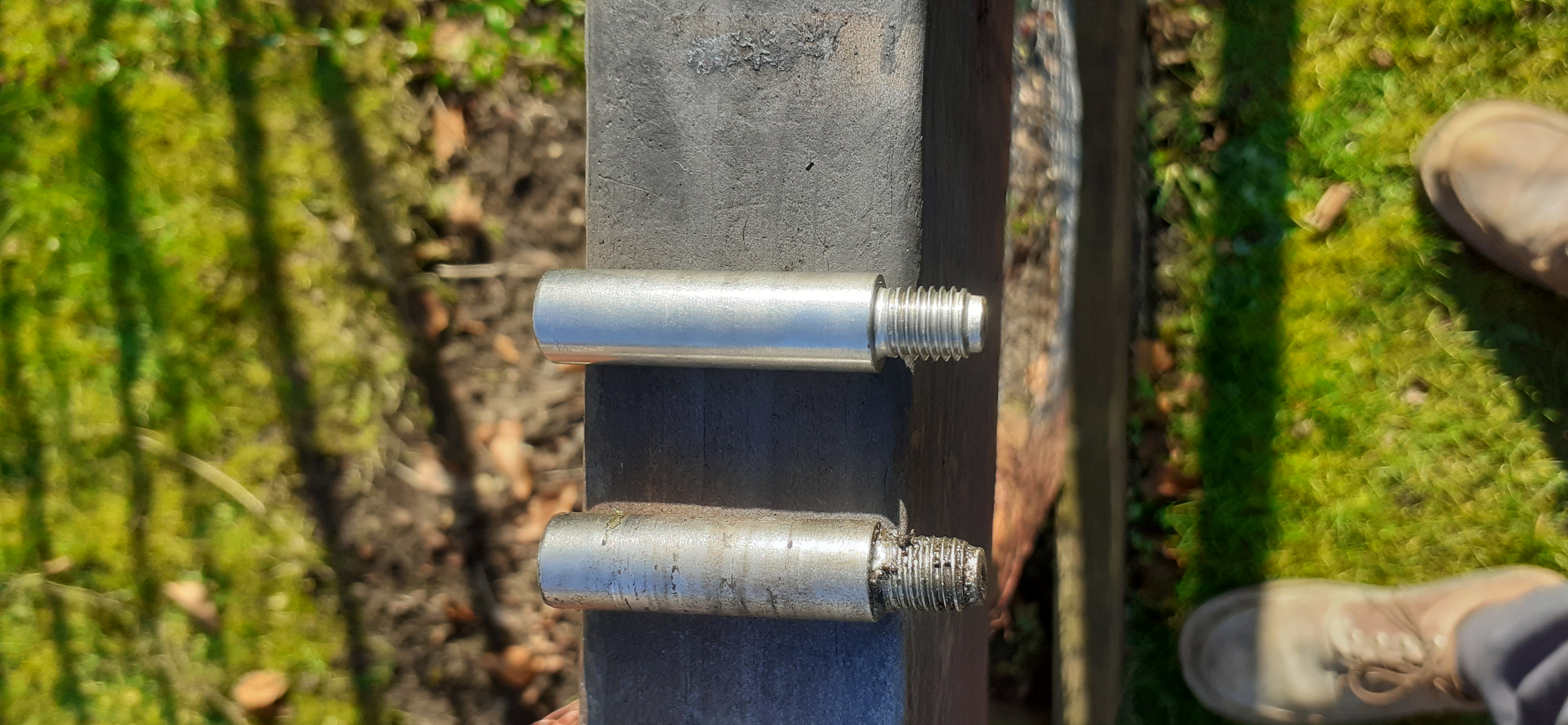

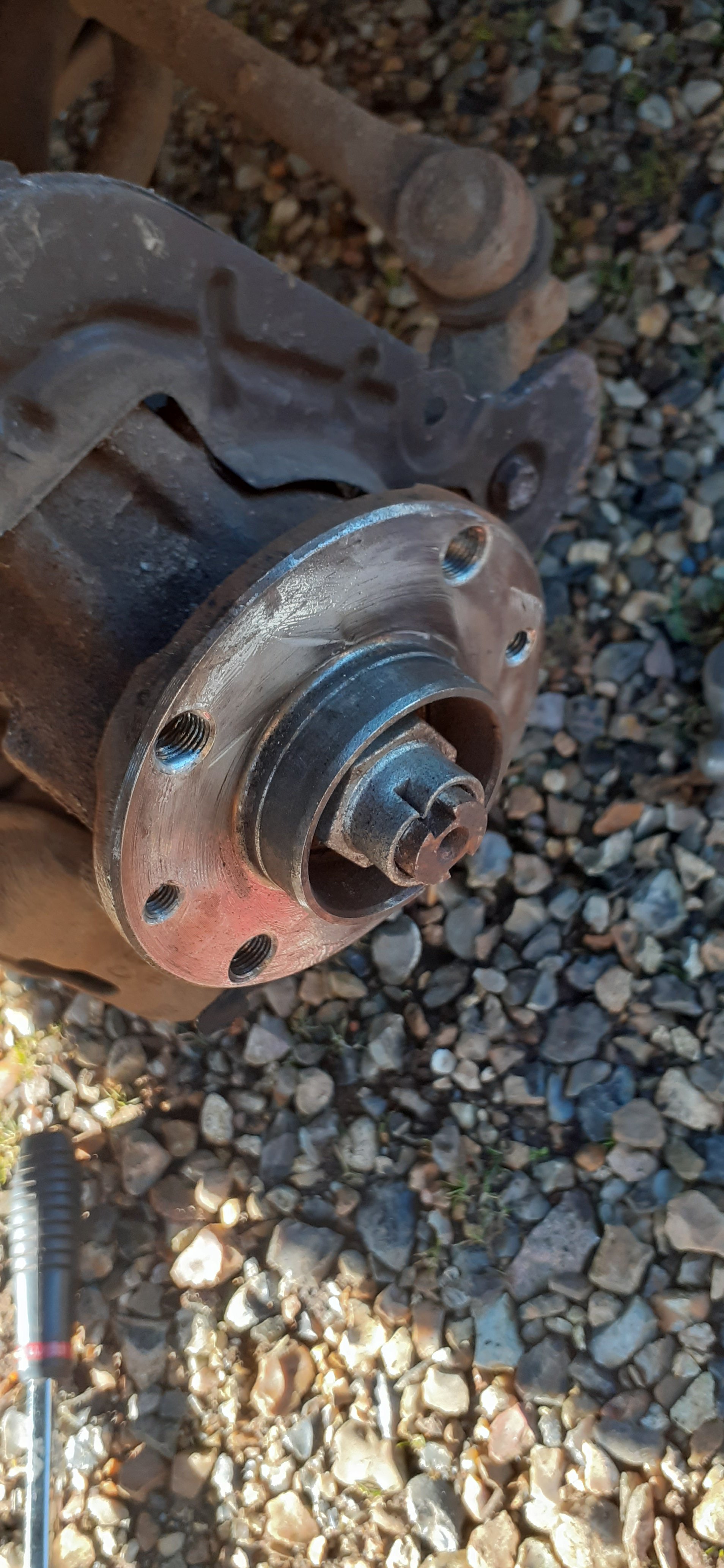

Nothing that surprises me there. I've seen many looking like that or worse. The outside faces were better I bet? Braking forces would probably still have been reasonable and probably still pass the MOT? This is an excellent example as to why, maybe every 6 months or even yearly, you need to get under and take a look at the inner tyre sidewalls and discs. At the same time you can check CV and steering rack boots and maybe track rod end dust covers too. Is that a shocker leaking? lots you can see if you look. Regular visual checks like this take only minutes and can save you a lot of money if you catch things early - But I obviously don't need to tell you this Panda Nut.
Something else I used to do when servicing cars was chip the rust scale of the edge of the disc where pads don't quite reach as the rust gradually grows inward and jacks the pads off the disc reducing the contact area.
I used to tap the edge of the disc with a small hammer and most of the rust would break away.
Absolutely. It actually chips off quite easily most of the time and is well worth doing even if just to reduce the "dry scraping noise" it tends to make at low speeds. I always did it because it resulted in a happy customer. On my own vehicles I just didn't like the noise. The surface remains quite rough though so doesn't restore effective braking surface - it just grinds away the contacting pad surface.
Ive being doing annual brake renovation and I think it needs as you say 6 monthly. The 319 brakes are a great deal better designed than the 169 but still do this. Im really thinking its the half height back plates. I may see what happens if I modify these. Its hardly as if they need a massive amount of cooling. Trouble is I have other things to do than messing with 4 sets of Panda brakes. I just wish I knew why it was happening so I could put a stop to it. I am now quite rough with the brakes on the Pandas and even this doesnt seem to do the business. You are right again, the out side faces were exactly as you would want shiny from edge to edge. If there are any faults I couldnt find them. Coated discs should help a little. It just passed its MOT but they said 16% imbalance which is way to much for me. The discs and pads were original so nealy 11 years old. 43000 mile and the pads were barely half worn, As the discs were worn down to thwir limit, changing seemed natural. Maybe I'll clean the discs and swap them over every 6 months. I have cleaned and repainted the caliper brackets so who knows how long it will go before needing further attention. It definitely drives me Panda Nuts trying to keep on top of it. Annoyingly I dropped a bleed nipple cap. I found you cant buy them separately. Ill have to try the internet or nip round the the breakers.

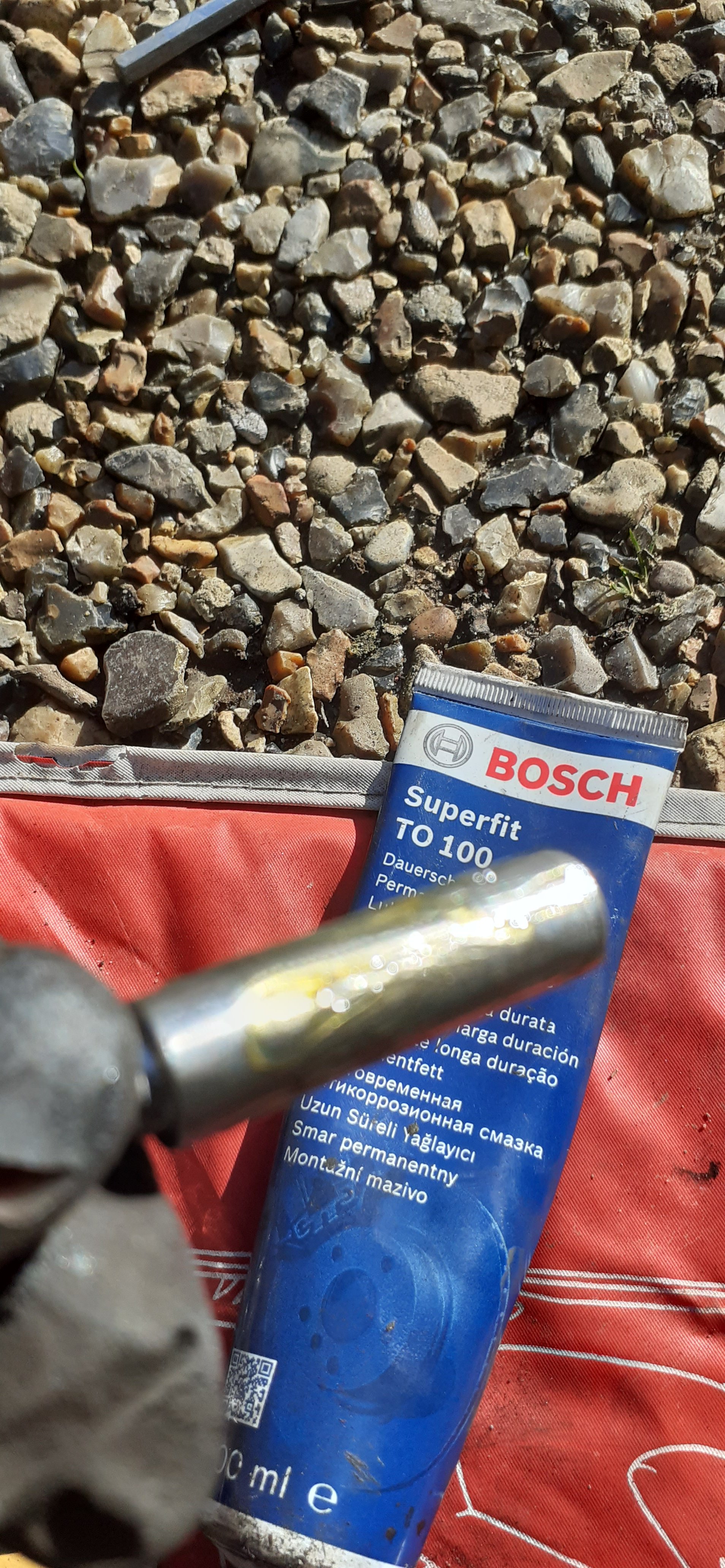

I do this and clean them back to bare metal. clean with a flapper disc or sanding pads onmy multi tool. CHeck for flatness and flat the pads dead level ona block with 400 grade emery. Discs then get pained with stove black. Its mind bending the condition of these after 12 months and 2500 miles when the car is also garaged. They look as if they have never been serviced in its 11 years. This car is the least used, mine has been working quite hard and doing a lotm of fetching and carrying recently and towing a load of weight. The trailer alone is 400kg so the brakes should be working. Ill bet they are in the same state. Rachels does 50 miles a day and seems to be in exactly the same state. I think bad design.
Very much similar to what I do but I used to automatically flat all pads on emery on top of a sheet of 1/4 inch plate glass - which is very flat - However I've found that, unless the discs are in exceptionally good nick, flatting the pads can reduce the contact area on an older disc with imperfections like slight ridges. It doesn't take all that long for them to settle back in but can have a noticeable reduction in braking performance for a few days until they do - settle down that is and reprofile to the disc surface. So now I will still flat a pad if the disc surface looks flat, which is most of the time, but not if it's a bit ridged.

Well Fiat wanted £65 for two plastic plugs that were missing from Noop when supplied. Big Red have done two brake bleed nipples with the rubber caps, and two complete sets of slider pins with thread lock, and all the bushes for £25. A no brainer. I shall change these annually when stripped down and see if it makes any difference, You get the caps, slider pins and caliper bushes for £10.50 each car. You even get grease. I should have these on Friday.
